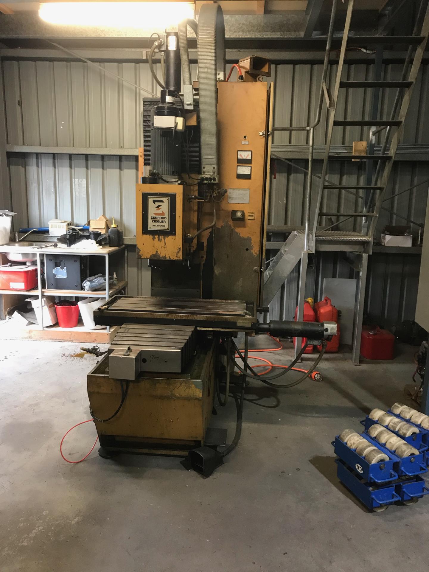

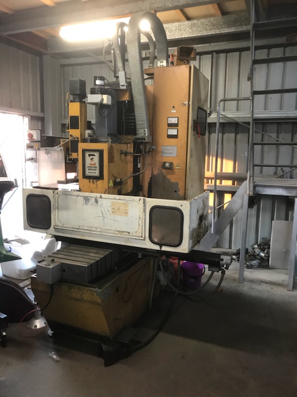

I have recently purchased 1985 Zenford Zeigler CNC milling machine with 24 tool carousel changer. This machine is an Australian built machine, fitted with an early ANCA 2000 controller, also Oz made.
The Anca controller is well and truly past its used by date, But im hoping to bring the machine back to life with Linuxcnc.
After talking to another ozzy who was also retrofitting a zenford machine (Thanks for the advise Russell), he has recommended using mesa hardware with the original servo's, drives etc.
I have been looking through allot of forums here for the last month or so, trying to get a grasp of the hardware, testing, homework etc, i will need to do before tackling this retofit.
Im a machinist with some electrical experience, but this will be the first time tackling a cnc retrofit like this. (i do have a small hobby cnc router running GRBL, steppers etc that i enjoy tinkering with)
I do have allot of electrical info about this machine. Elec drawings, Owners manual, spindle drive manual and a printout of the original controllers plc ladder type program.
Im looking to use the original brushed DC servo's and drives (all axis's and spindle), these include tacho feedback to drive and resolver feedback to control. Drive inputs are analogue +/- 10v, Relays are 24v.
looking for recommendations on mesa cards for my build.

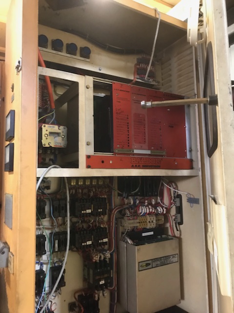

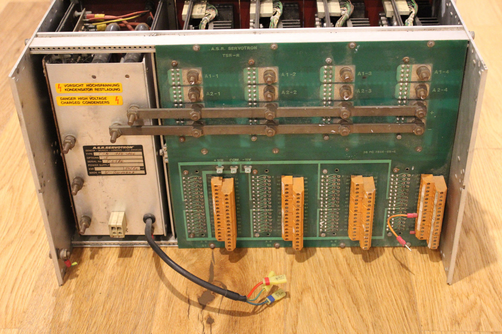

Thanks for the reply.The current drives are ASR Servotron. 150v dc 10amp cont. They are a rack style with inbuilt PSU. There is this on ebay Aus,
www.ebay.com.au/itm/ASR-Servotron/172531...8:g:PLgAAOSw4A5YouNI
which is a 150v 15 amp unit. For $250, it would be great, but the condition is unknown, and i dont really need a $250 pile of old parts.
i agree about the resolvers, especially as i already have 5i24, 7i49 ( and others) combo.
Will do a bit more investigating over the next week or so and see what i can work out.
If you can recommend any drives 150v 10A drives, im happy to take a look.
cheers

29 May 2018 11:18 #111249
I have never used brushed servos, so don't have any first-hand experience.
pico-systems.com/osc2.5/catalog/product_...ath=3&products_id=10
Might be an option.
I assume that the existing drives take 240V AC input? Either the Pico or the Mesa drive need a DC power source, which adds a bit of work.
You could cast your net a bit wider. Is this the drive?
www.ebay.com.au/itm/DF123-Baldor-A-S-R-A...a:g:r3AAAOSwK89Z26XK
Is there any indication what is wrong with the existing drive? They don't look super-complicated.

The input to the drive power supply is 3 phase. I think it is 115v per phase. The drive PSU converts to 150v DC not sure on the amps (the one on ebay i linked is 100 amps!!). Not sure what is wrong with the drive. I found some paperwork from a previous owner, stating the drive is not repairable. That was from Baldor repair centre. Wish i had found that before i bought my mesa combo. thats what i get for getting to excited... haha
The Baldor drive you linked seems to be a 60v 12amp unit. Thats assuming the codes run the same as the 150-10-01 that i have.
I wanted to retain the motors power / speed, so i wanted to look for drives of similar specs. Am thinking to use the same DC power supply that i have, but remove the drives and patch in the new ones.
Looking at the ebay one i listed, it looks like there is a bar across the DC outputs to the drives. i was hoping to reconnect new drives up there.
