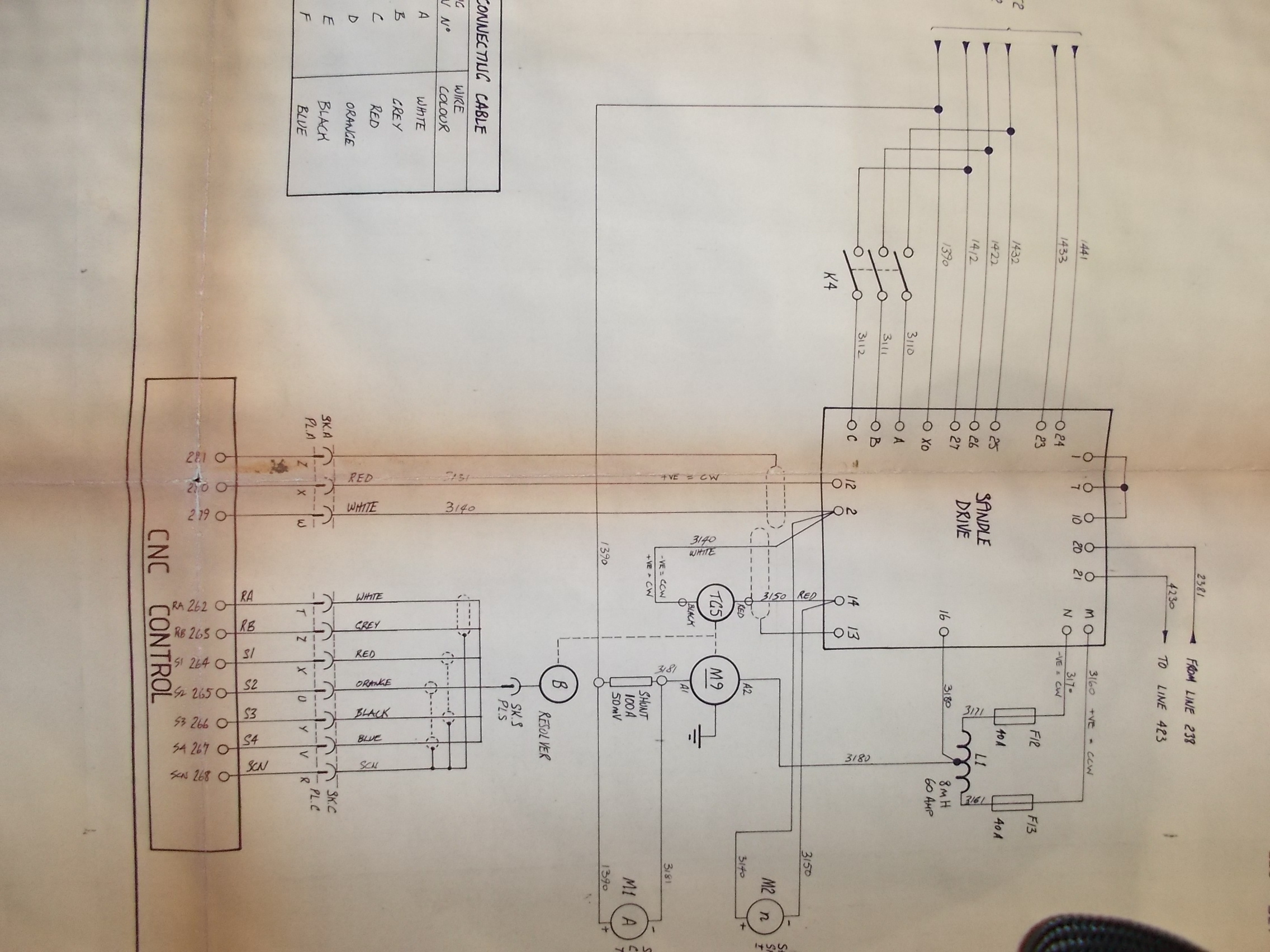

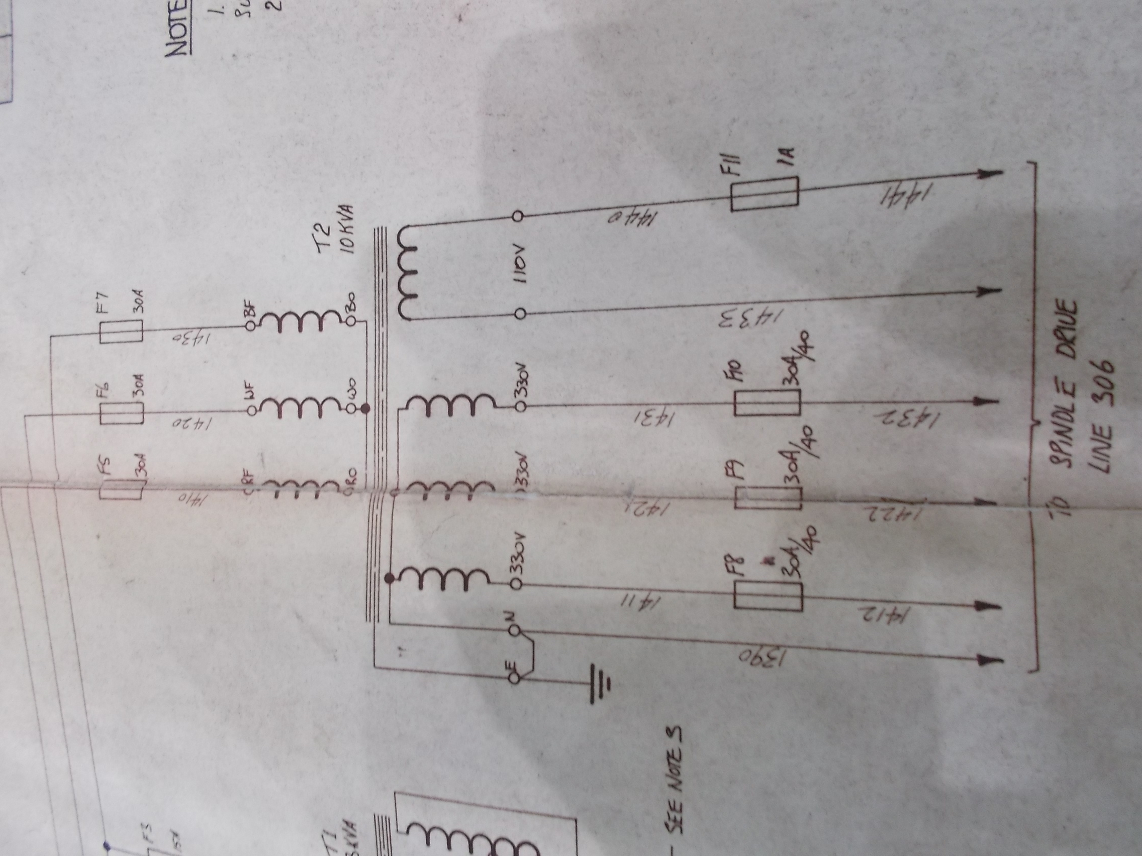

If you can post pics of the power in to the hyperloop and the control in. also the part in the cabinet next to the hyperloop , below the fuses, I'm also missing this item.

16 Jul 2018 04:42 #114276
by snoozer77
Replied by snoozer77 on topic Zenford Zeigler Retrofit
Found drawings at work. Pin 20 and 21 are 24v drive fault. line 2381 (24v+) comes through a set of limit switches, through the axis servo drives, into the spindle drive and comes out pin 21 (if no fault) through wire 4230 to the controller. All other conections are shown. hopefully you have transformer (T2), contactor (K4) and inductor (L1). This drawing is for resolver feedback. apparently, some of the later spindles went to AC with encoder feedback. Not sure if your controll will accept resolver, but im not farmiliar with the CSLabs control.
Yell out if there is anything else you need to know. I will try help.
Cheers
