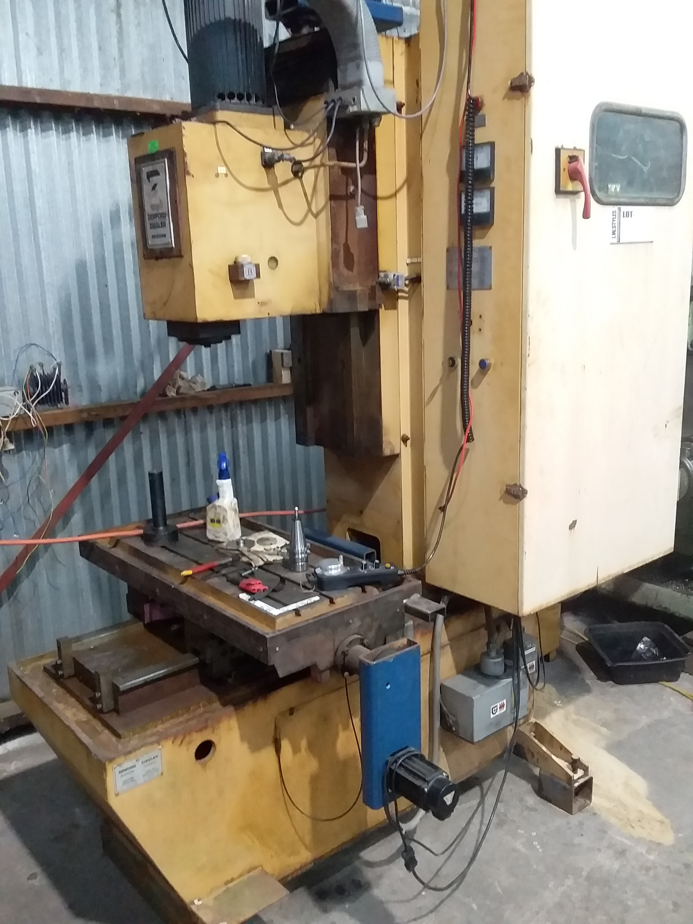

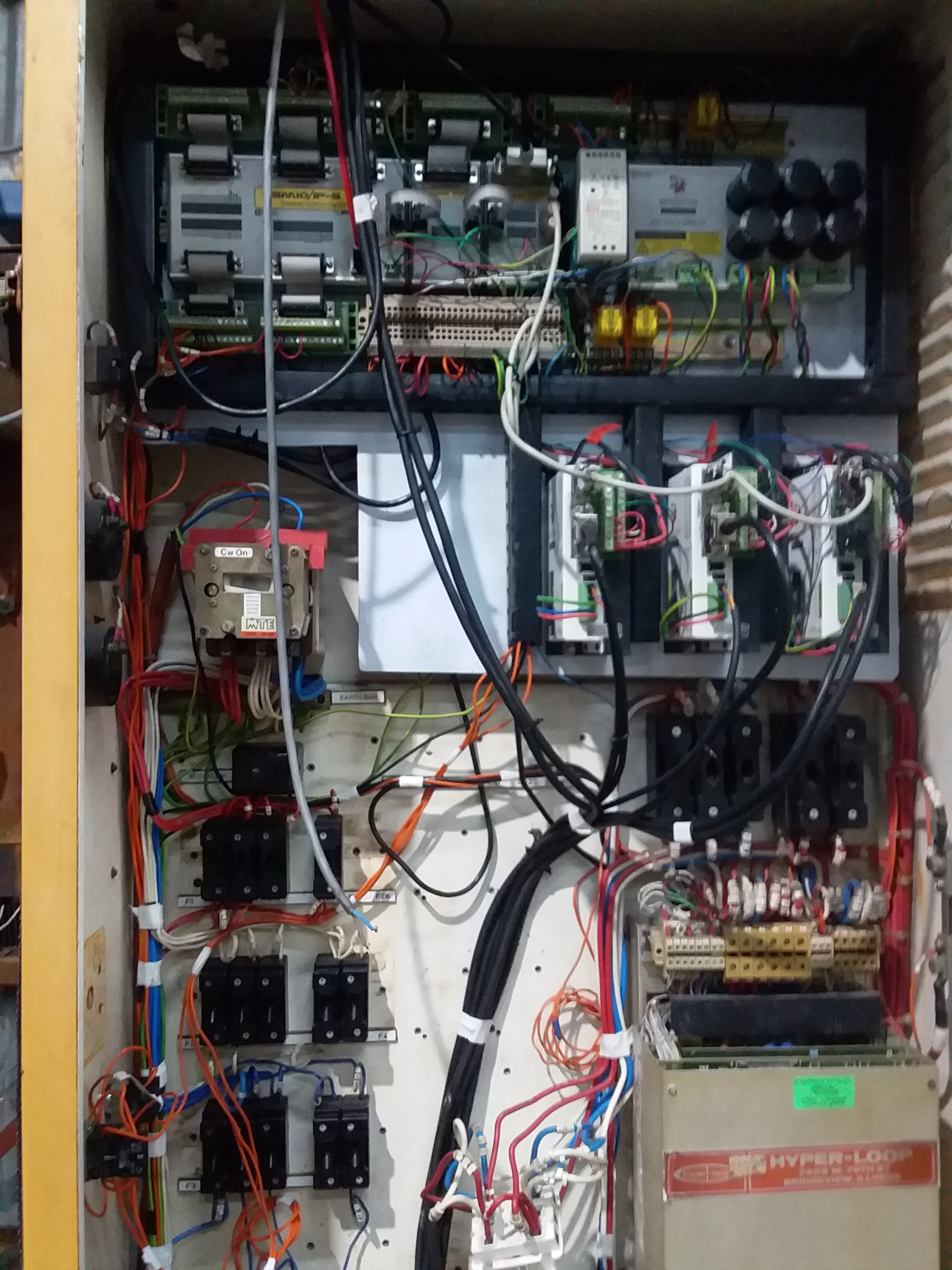

Hey mate,
How's your retrofit going ?, mines been slow progress but we have all axis moving, and spindle motor and driver test working. Could I trouble you for some pics of wiring diagram to the spindle motor, previous one with driver doesn't contain all wires. Here's some photos of my machine

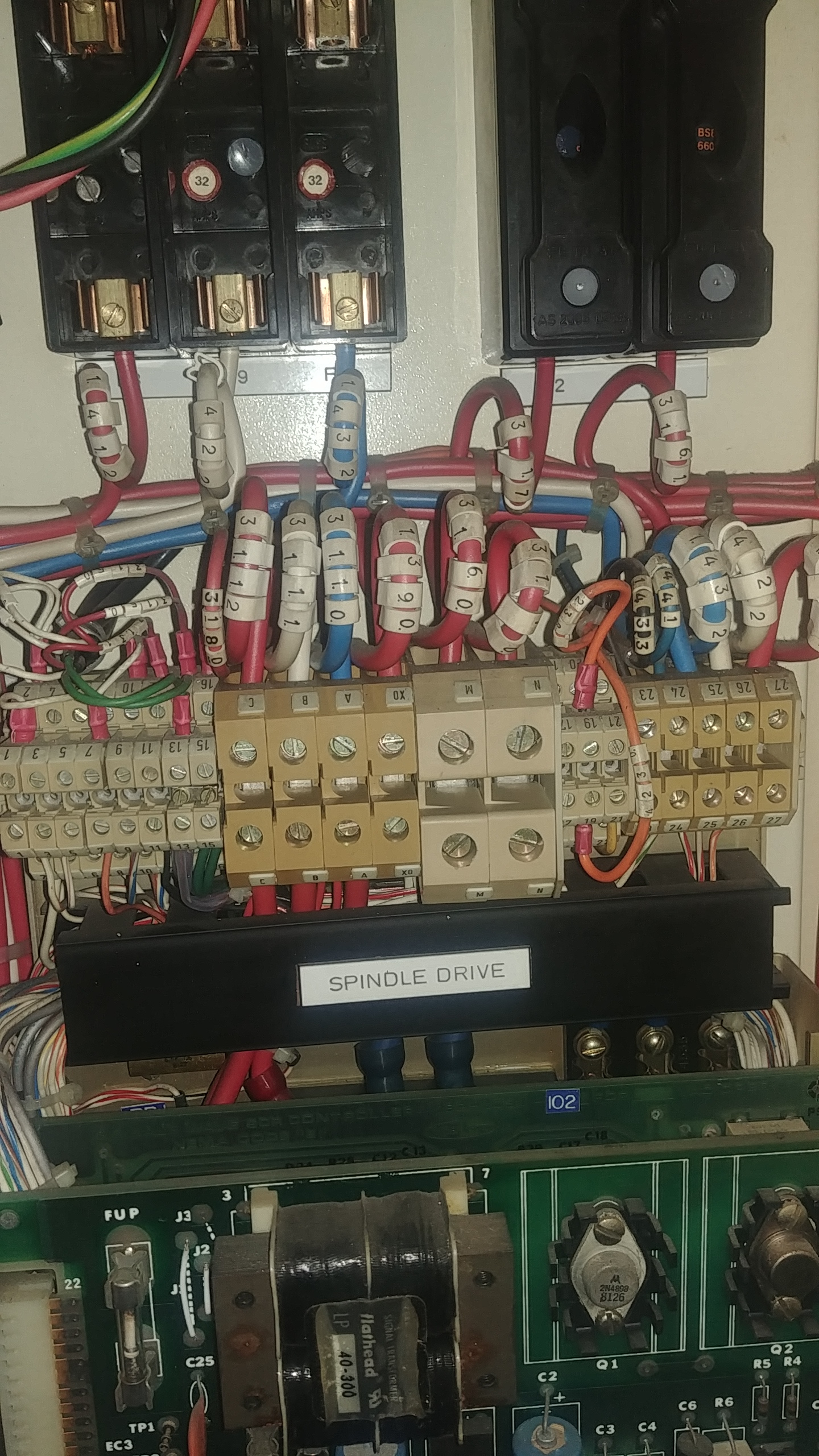

13 Dec 2018 03:58 #122348
by snoozer77
Replied by snoozer77 on topic Zenford Zeigler Retrofit
- Marz1987
- Posts: 11
13 Dec 2018 04:16 #122349
by Marz1987
Replied by Marz1987 on topic Zenford Zeigler Retrofit
Thanks for that, we have the same wiring at the driver as this, I think what you say about a fault line to the controller could be correct, the guage of the wire means it can only be signal of some sort. I think the issue maybe the we currently are not using contacter K4 and just have it hard wired, or our 0v signal from the cs labs is putting out some voltage. the other problem we can only put out +ve voltage, so will need to add polarity inverting, fun and games. Appreciate your help.
- snoozer77
- Posts: 97
- Thank you received: 12
13 Dec 2018 04:18 #122350
by snoozer77
There is 3 pairs of small red and white wires on the left side. These are Analog inputs for drive, spindle speed meter on front of cabinet and tacho. 2 small orange wires are external fault, coming from limit switches and the axis drives. Hope this might help.
