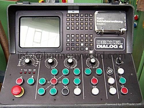

The DC spindle motor has died and I am replacing it with a VFD/Vector controlled 3phase motor. The plan will be to use both the gearbox and the variable speed of the VFD just like the original system worked. Will start studying the gearbox.comp files.
Going to spend a few days counting IO pins of the FP5NC SPS (PLC? / PC) module and the control terminal:
Will be retaining the buttons and rotary's and replacing the CRT/keypad with a LCD touchscreen.
