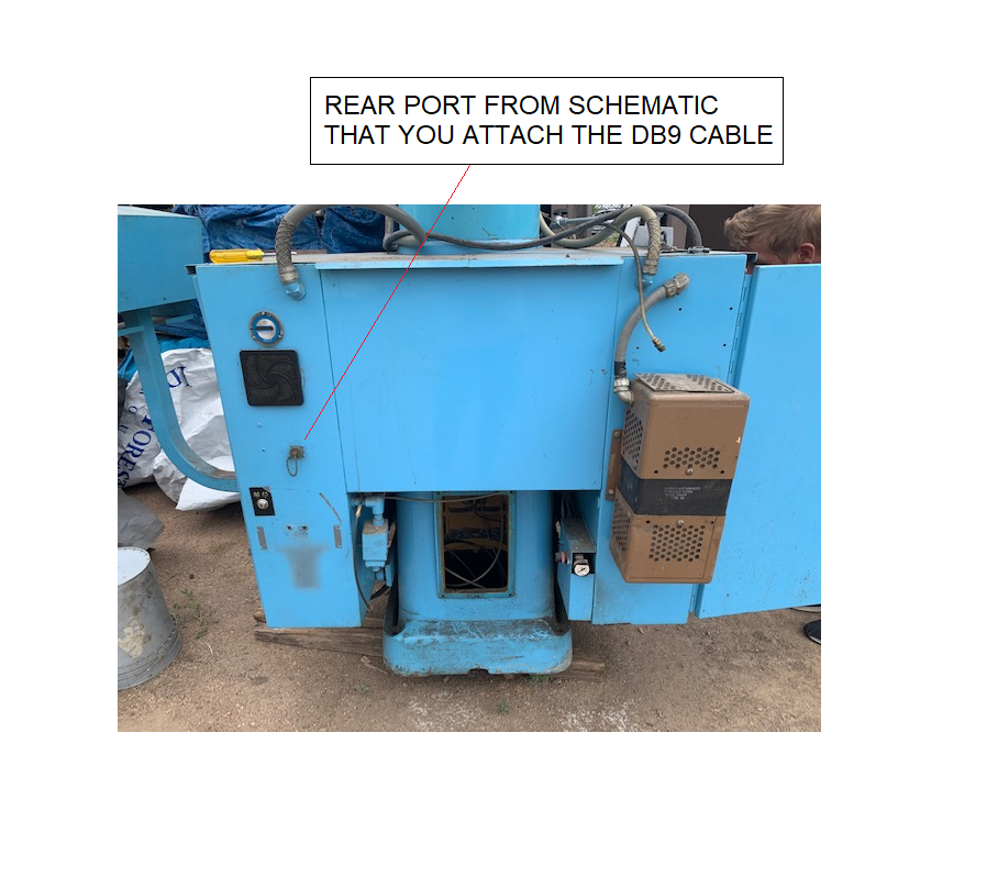

Ok, they could have had a Greco minifile hooked up to download from the machine. In other words they could have been hand coding at the pendant and when they finished getting whatever part machined correctly they then downloaded the program to use in the future. This is backwards as you usually make the part in CAD/CAM and then upload to the machine, but you never know if they were prototyping with the machine and then getting what they programmed out for future.
I figure it is a hook up tor DNC, but not sure since your saying it is feeding "out". Most DNC programs that I remember could upload and download. I don't think it would be a BTR connection, because seems like BTR's only do output, but could be wrong. I think the only thing that could do upload and download back then was a Greco Minifile. I never had one, but wanted one back in the day. You used a floppy disk to transfer the job to the machine back when 3-1/2's and 5-1/4's were in computers. But then DNC programs became prevalent by hooking up with the DB9 making BTR's and Minifiles obsolete.
Probably could bypass and use the original Hurco wiring to hook the DB9, just to see if it will upload from a computer. Would be cool if you get the Y motor working and could get the master back onto the controller to see if it would work OEM.
Robert

Now that I think about it some more... physical orientations doesn't imply anything about logical direction.
It is a single opt isolator. So it is single direction.
It connects in to the TB on the bottom of the relay module. I had sort of assumed its some sort of machine status indicator.
I probably need to figure out what the terminals it connects to are for.

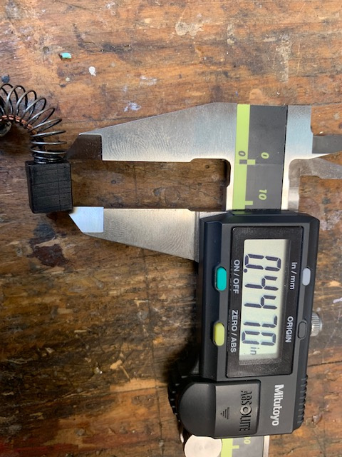

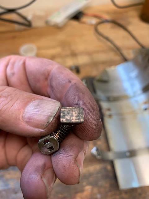

Did my best to follow the brush maintenance instructions. Nothing is obviously out of spec.
No Joy.
I took the belt off the motor just to make sure the load of the table isn't somehow messing it up.
At power up, it usually rumbles for few seconds then overcurrent fault. I tried rotating the motor while its off. It seems reasonably smooth to me. The length of time it rumbles before overcurrent seems to be somewhat related to starting position.
There must be something amiss with the armature. That's about the only thing it could be.
No Joy.
