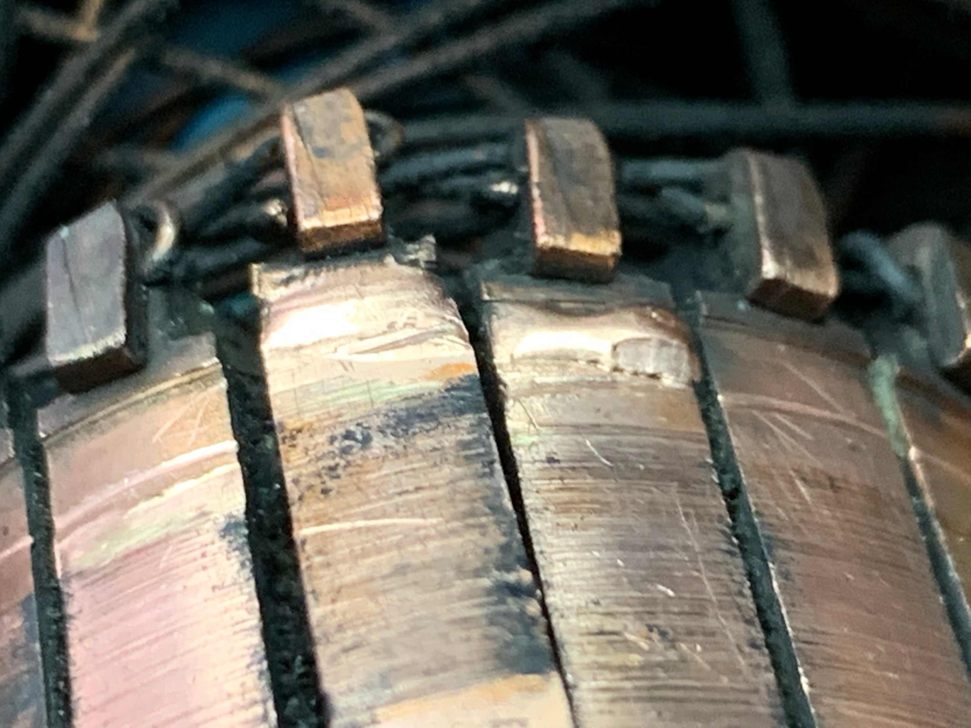

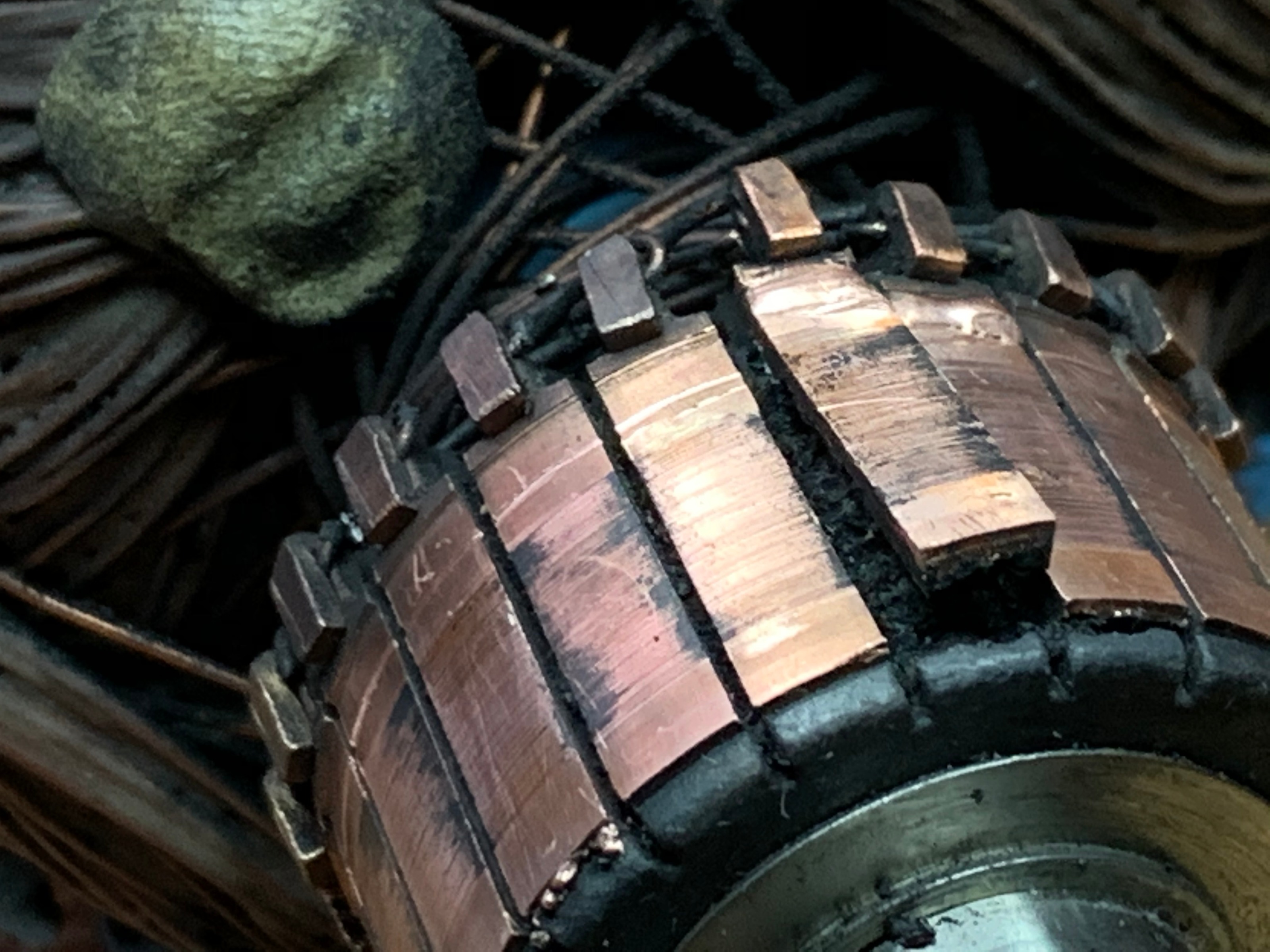

Took the ailing Y-Axis servo motor apart today. And it ain't good.You can see what looks like solder/braze blobs at the top of these commutator segments.
While trying to clean the space between the commutator segments, I noticed the left segment above was loose, sorta like a loose tooth. Pretty sure the commutator got too hot. Why is a good question.
Now my guess about the story behind this machine is the Y-Axis quit. It became the donor shop machine which is why so many pieces are missing.
Checked with a servo rebuild house. They said sure, we can rebuild your armature. Be sure and include a check for $1200 when you send us the motor.
We would end up with essentially a brand new servo motor. But I gotta wonder if we might be better off getting a new(er) motor and drive. Anybody out that have a suggestion where I could find a serviceable 1KW servo for cheap? Doesn't have to be brand new.
And, are there any issues with LinuxCNC managing heterogeneous servo paths? The two existing paths are analog with I think 200 clicks per turn encoders. A new(er) servo is likely to be step/dir and a finer encoder.

Holy freaking ouch... yeah that is bad. I was about to ask in a post last night if you had done anything with the motor. That is terrible. The only thing worse is the $1200 repair quote.
Your not dead in the water, I will give some options of what I would do and maybe others can chime in with their thoughts also.

Inspired by this....
The Electro Craft is nowhere near as bad as the motor in the video.
So why not. What's the worst that could possibly happen? I think it would still be $1200 to rebuild the armature.
If it does work, wouldn't trust my life to it. Maybe it will work long enough to find a replacement.

I just saw the post where you have the armature video. I haven't watched it yet, but just the pic is enough... LOL
EDIT: But yeah I would try it to get by and get it working for a bit. You are right, nothing to loose...

That would be a nice exercise in patience, but i would not bother with it, try to find something that fits, frame and shaft wise, with near enough characteristics.
