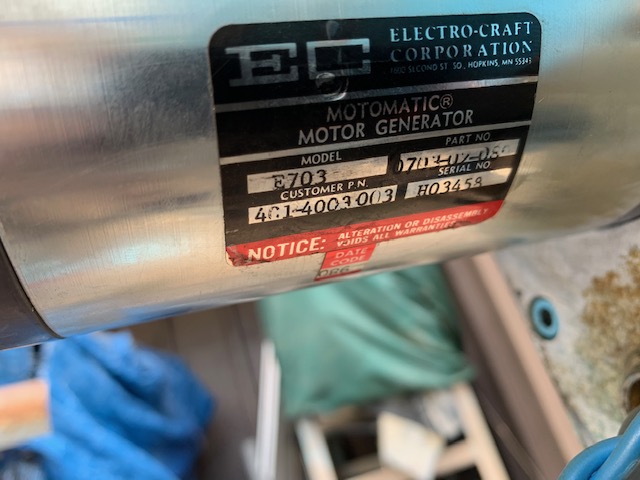

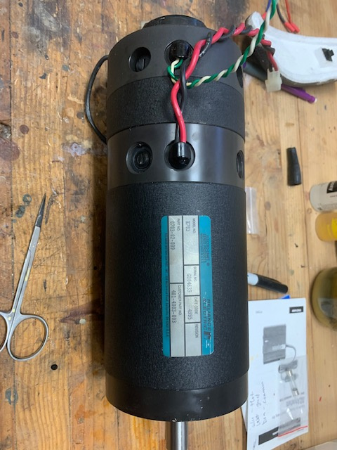

Thanks for the info. See attached photos.
The motor/generators are about 9x4.5 inches. Definitely not NEMA. I could not find an IEC match either. I think they are some sort of random thing some ElectroCraft engineer dreamed up one afternoon.
There is an adaptation plate between the motor and the machine. Nothing fancy. Expectation is new motors will be NEMA and require new adaption plates. Easy, if you have a CNC mill to make them with
1+ horsepower seems like a bit much, but what do I know? Rather overkill than under kill.
I have the drives for these motors too. If someone out there needs some prehistoric servo motors and drives to finish their collection, PM me. I'm sure we can make a deal!

@_big_
Hey I have a Hurco KMB1 that I retrofitted with EtherCAT. I have all of the schematics and manuals for the machine. Mine is a 1983 model if I remember correct. I have 2 of these machines, but am just about to start doing the retrofit on the 2nd machine. The 2nd machine is a little bit newer and closer to the SM-1 model look, but with the older KMB1 spindle head.
You can re-use the Electro-craft servos and Servomate amps. They may be 40 years old, but you will be surprised at how good they are, plus you usually can find parts cheap on Ebay.

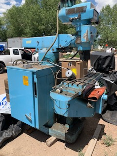

Yes those silver model in the top picture is what I have . Seems like a model 701 or 703, but would have to go look again. l use to have all of this memorized LOL.
Back in the 80's there were a lot of machines that had the Electro-Craft servos with Servo-Mate amps, they were very popular.

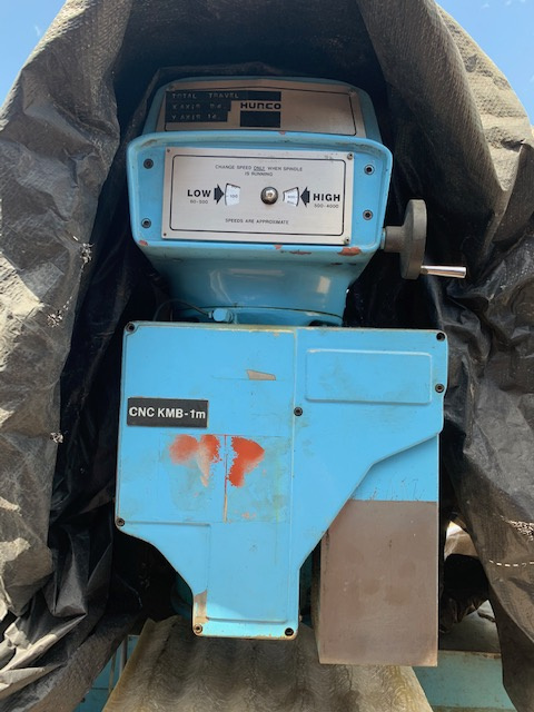

Here's some more info about the machine.
Labeled as a KMB-1m. I believe to be an early 80's model.
Cabinets on both sides. The left side is spindle power. The spindle VFD is missing. Don't think that's a big deal. New VFD should be under $500.
I believe it has a Kwik Switch 200 spindle. No tooling or wrench. This is potentially a showstopper. I don't know anything about Kwik Switch 200. Availability seems very limited. Any advice here would be appreciated.

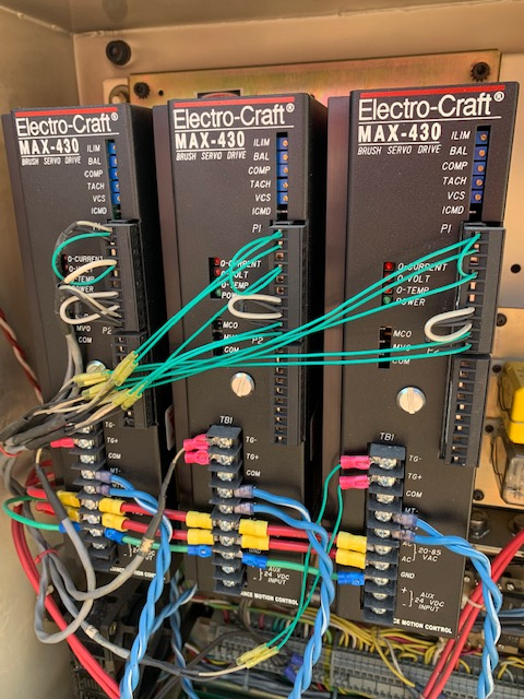

I don't have an overall picture of the right side electronics cabinet. I do have a picture of the drives. They are about the only thing that might be worth saving in the electronics cabinet.
I've been able to find absolutely no documentation about the motors or the drives. You can find a few places that claim to have repaired replacement parts for very high prices.
I don't think these are the original drives. I'm somewhat hesitant to apply power to 30+ year old power electronics. Power electronics (electrolytic caps) don't age so well. And I don't any clues about how to use them. Many of the wires are unlabeled.

Looks like you have the manual spindle, which is a little unfortunate, but its not going to be a game killer. It won't be a problem until you are running a program that has multiple up and down speed changes. Worst case you can build a simple bracket to add a servo on the manual hand wheel that cranks up and down the speed. Later models of this head had a extra servo to do what I talking about. I will find some pictures to help you understand what I am talking about, but if you look at the picture of the spindle head you can see the silver hand wheel to the right. On the newer models with this style of head, they added a servo to the left to do this automatically with the control.
Those Electro-Craft Max 430's are completely fine. I have one Max 400 but have never had to use it. I know that the 400's and especially the 430's were an upgrade when the Servo-Mate drive would give up. If I remember correctly, Midwest CNC was the company that did the most Max 430 upgrades. You are actually set up pretty well for the getting going on the moving the table and spindle as you can wire right to the 430's. Just from the looks of the wiring it does look like a upgrade from Midwest. They may have been OEM for your machine depending on the age, but from the wiring it looks like a upgrade.
