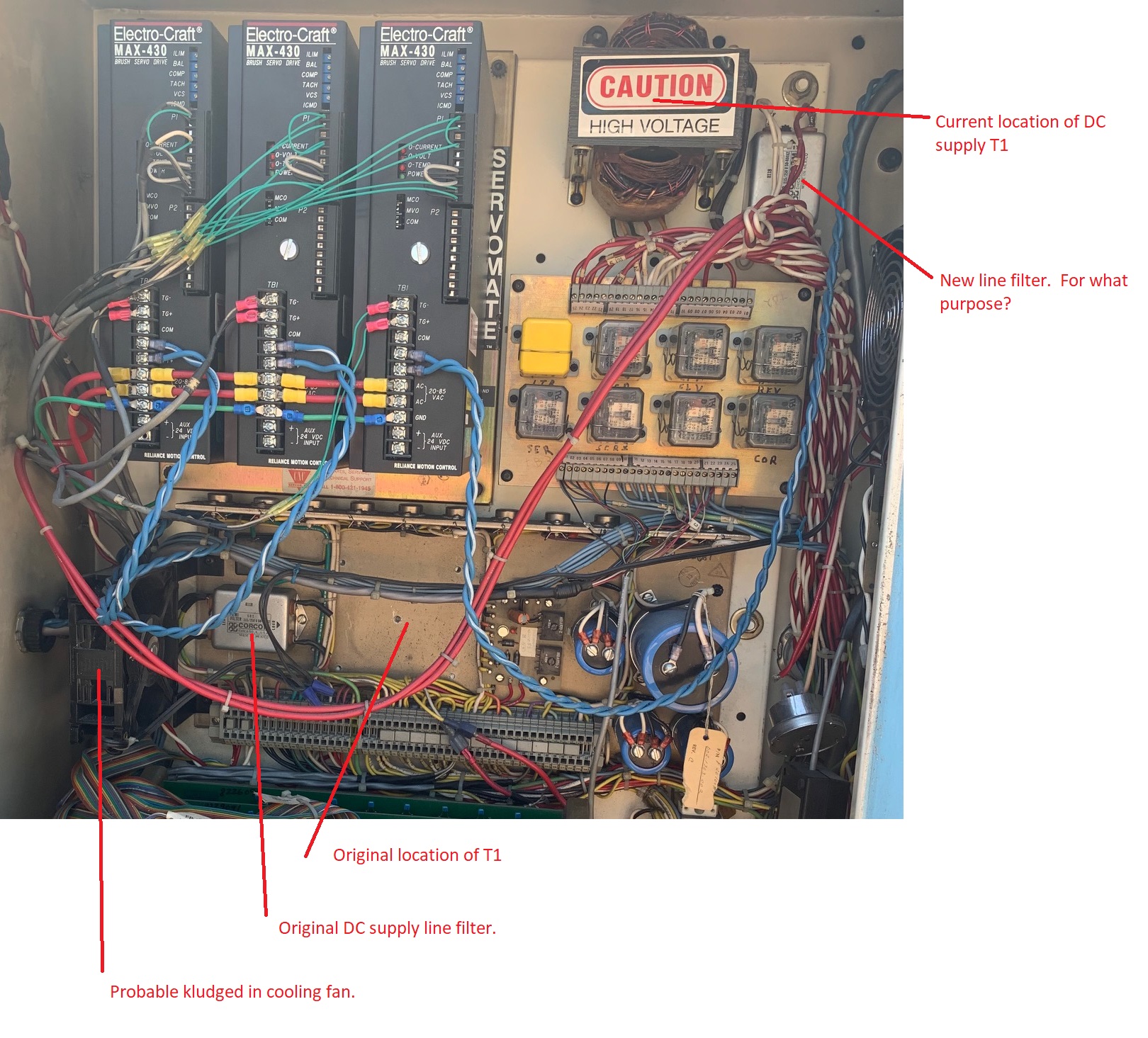

05 Aug 2020 20:11 - 05 Aug 2020 20:24 #177418
by _big_
Replied by _big_ on topic Hurco KMB-IS CNC update
Hi Robert,
Thanks again for the data.
The mystery of the Hurco deepens...
It looks like someone moved the DC supply T1 from the power supply frame to up higher in the cabinet. It also looks like they added a cooling fan on the left side of the supply. My guess is the rectifier board was overheating. So they added the fan but had to get the rectifier board out of the airflow shadow of the transformer. So they moved the transformer. A semi major hack actually.
The line filter on the DC supply frame shows in the schematic. Looks like wires were soldered and heat shrinked. So probably this line filter is still upstream of the relocated T1 transformer. And it looks like they added another line filter next to the relocated T1 transformer. Don't know what that's for.
I believe the T1 transformer takes 120VAC. The left cabinet schematic you sent me shows another transformer labeled T1 that appears to be deriving this 120VAC from the 220VAC 3 phase input. Don't see this T1 in the left cabinet. Suspect I'll have to find a replacement.
It looks like there are about seven +5VDC outputs. I don't think Hurco did it this way for "isolation". Generally speaking if any of the 5VDC supplies dies, the whole computer dies. TTL logic thresholds are referenced off the ground rail. Proper logic operation is not so dependent on all the logic parts having exactly the same VCC (+5VDC). It is not possible to simply parallel the outputs of LM323 and LM309 regulators. I think the multiple supplies was just there as a simple way of generating sufficient 5VDC.
Here's a picture that shows some of this stuff.

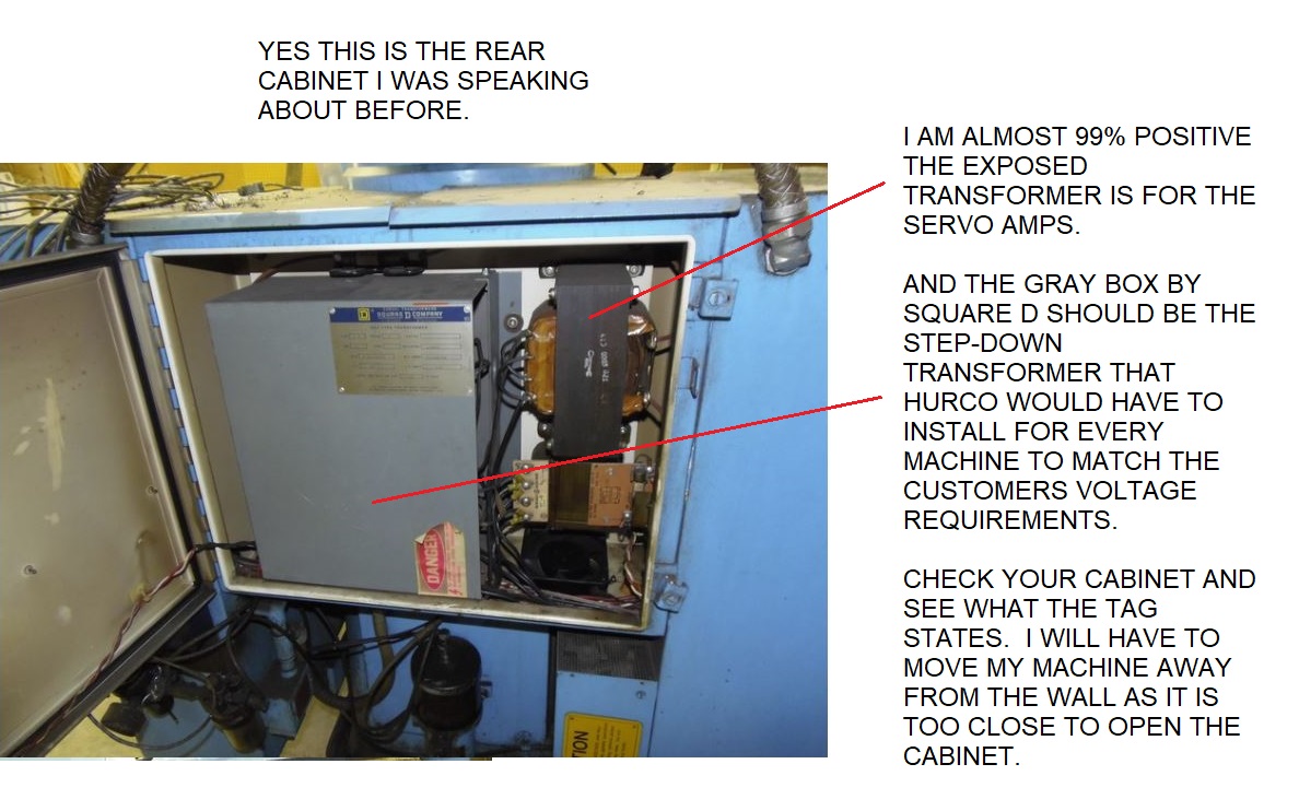

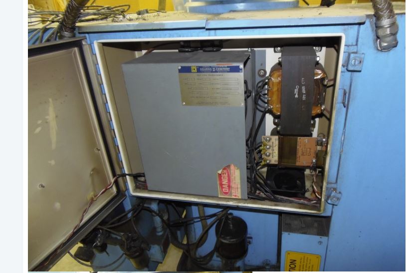

Was over on industryarena.com looking at a Hurco upgrade thread.
Discovered there is apparently a third cabinet on the rear of the machine. See pic below. It doesn't have an access latch handle like the left and right cabinets.
I expect this is where the missing T1 transformer lives. I'll have to check into this the next time I visit the machine.
This pic is a snip off the industryarena.com thread.

05 Aug 2020 22:09 #177427
by CORBETT
Leith,
Yes this is the rear cabinet I was speaking about. For some reason I was thinking they were in two separate cabinets, but that is what I vaguely remember for the transformers. Just been a really long time since I have been in them. Ok the right hand exposed transformer should definitely be the single phase transformer to the servo amps. I know that is the one. The gray box by Square D would be the step-down transformer that every machine would need before leaving Hurco headed to the customer. This makes total sense also as there is a tag on the gray box and I am sure they would have simply ordered the step-down transformer for whatever they needed to match. They would have only kept a few of the main type you use, such as 220/440V. Anything like 575V that they showed in the manual would have been ordered when they received a order from a customer and therefore that is why it is packaged. Should definitely be able to read the tag and see what it states. I will see what mine says so you have a idea.
I am going to the shop and I will take a quick look and get back on here in a bit to let you know something. Mine is almost against the wall, so I may have to take a little time and move it off the wall.
Will be back.

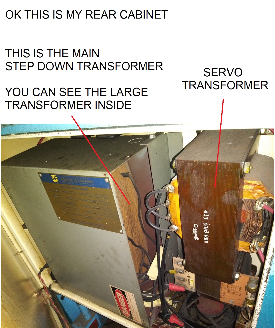

05 Aug 2020 22:52 #177430
by CORBETT
Replied by CORBETT on topic Hurco KMB-IS CNC update
Ok I was able to squeeze in enough to get pics and I am uploading to my computer now. Mine is identical to the pic from industry arena.
I am positive the gray box will be where the step down trans is at. Will know soon, have pics of my tag.
Be back in a bit.
Be back in a bit.

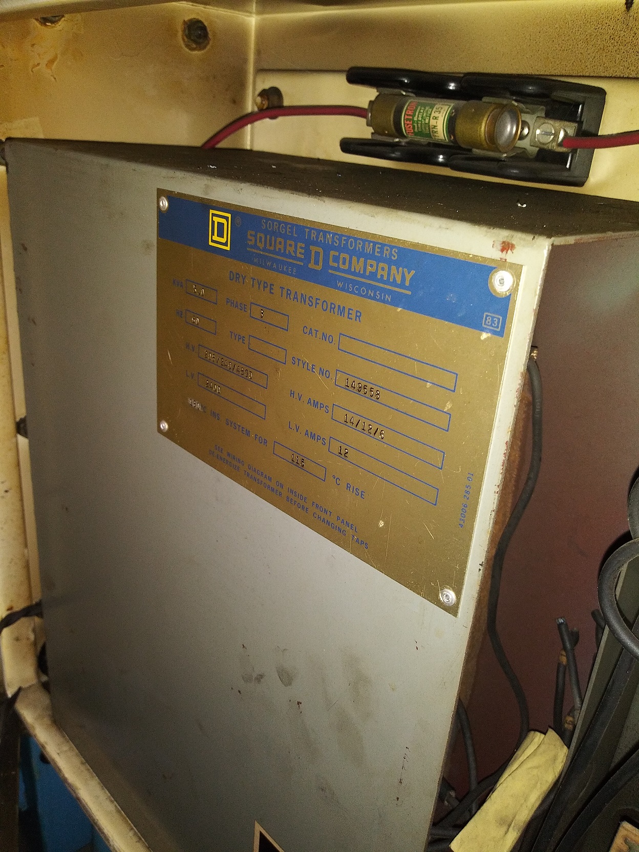

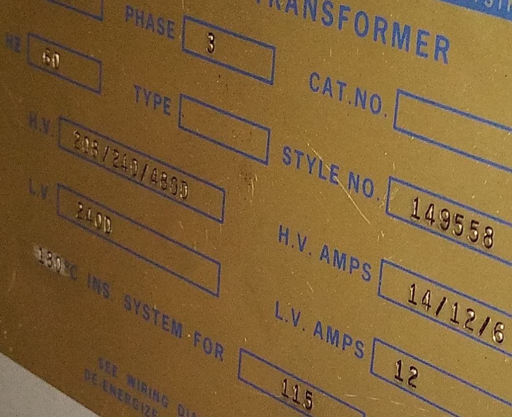

05 Aug 2020 23:20 #177439
by CORBETT
Leith,
Ok yeah just saw the tag and it's 3phase with HV input. In one of the pics, you can see into the side of the gray Square D box and it has a huge transformer the size of the gray box. So yeah that would be the main machine step down transformer, as it would have to be bigger than the servo transformer anyway. Not only is it powering it but all of the machine power will be ran by the step down transformer.
I can't make out the tag perfectly, so may have to go take pics again. but its showing:
HV" 208/220/480D
LV" 240D
KVA: 5.0
PHASE: 3
HV AMPS: 14/12/6
LV AMPS: 12
So yeah the large gray box is the main machine power step down transformer and the one on the right will be to the servo amp transformer. The smaller exposed transformer is definitely the servo transformer, I saw two red wires coming off the secondary side, and I only saw two wire supplying the primary, so that's it. Plus there were 4 taps on the primary with 2 input wires and 2 loops.
Give me a bit and I will up load pics. The lighting is getting bad here, so I may have to shut computer down for a bit.
Will be back,
Robert
