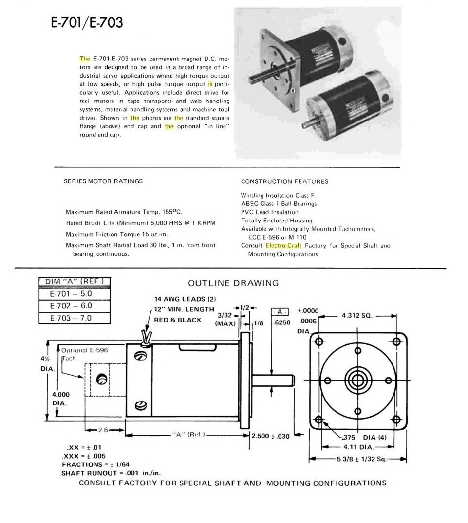

Replied by CORBETT on topic Hurco KMB-IS CNC update
There are currently three similar motors on Ebay. Part numbers are 0703-02-039 and 0703-02-049.
www.ebay.com/itm/Electro-Craft-0703-02-0...b:g:oboAAOSwhvpdxwcK

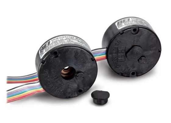

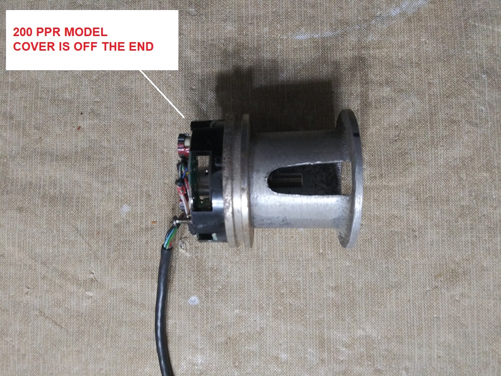

28 Aug 2020 01:21 #179768
by CORBETT
Back several post you thought the encoders were 200 ppr. I believe you have the newer encoders for the BX upgrade, as one picture I saw from way back I thought had the newer black friction mount encoders. If you have those black type, then you will have 1,000 ppr but if they are the silver looking type that bolt on the rear of the motor, then that is the 200 ppr. I will attach a pic of the original 200 ppr model, and I will get a pic of the 1000 ppr model on my machine so you can compare to see what you have. Plus, there should be a white tag on the encoder plastic cover that has the model number. In that model number, it will have the pulse per revolution (PPR) number. Those covers break really easy so be aware they are fragile. You have already seen them in the Ebay auction, but wanted to put it up for reference.

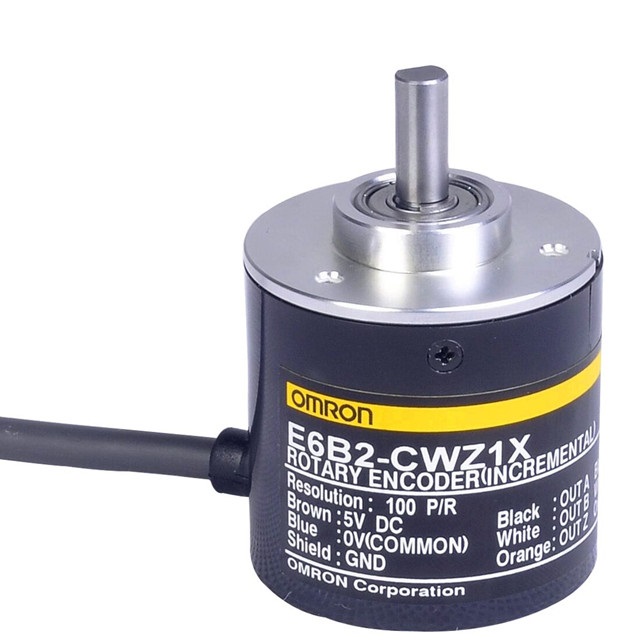

28 Aug 2020 01:49 #179774
by CORBETT
Also while on the subject of encoders.... here are some Omron encoders that you will see on Ebay for as low as $20 shipped from China. They are fake, but I use them for testing. I have 3 of them myself.
The real Omron encoders cost a little over $500 each new, so when I found out how much they cost I started checking into why they were $20 on Ebay, of course fake LOL. I thought they were actually real when I first got them as they look just like the real thing. But I am sure the bearings aren't good and everything else sub par.
I am not going to use them on any machine, but they would be good for a MPG on the pendant and learning purposes. Just wanted to share so you were aware for the future...

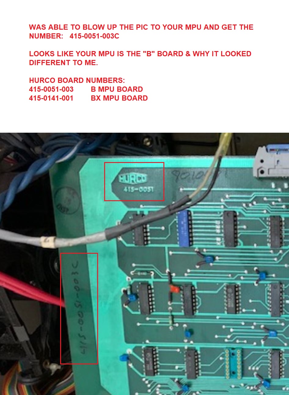

28 Aug 2020 05:17 #179784
by CORBETT
Leith,
Ok, I may have to backtrack on the encoders being 1000ppr for your machine. You will be able to check and confirm with the other pics I sent, but I went and checked out your MPU board. I was able to blow it up enough to see the part number and I checked it to see if it was the "BX" MPU as it did look different. It turns out you have a "B" board and that is probably why the one I am thinking of had more plugs. I am not sure if 1000 line encoders would work with a B board as I was under the impression you had to stay with whatever the MPU board was designed for. in other words, 200 for B and 1000 for BX. When you check the encoders, it should confirm this part... then again, you could have a board that came from another machine.. we will never know, LOL.
Got to get in bed, after 1am... will be back tomorrow.
Robert
