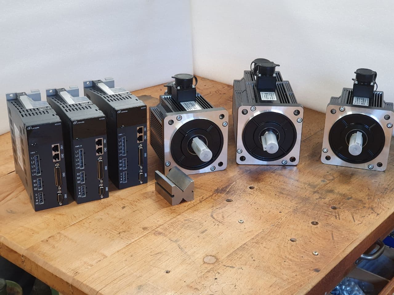

Well. After spending the past half year getting my workshop renovated i started working on the actual retrofit in december. But have only been able to gather all necessary sources and get proper new servos mounting flanges and fitting mesa cards.

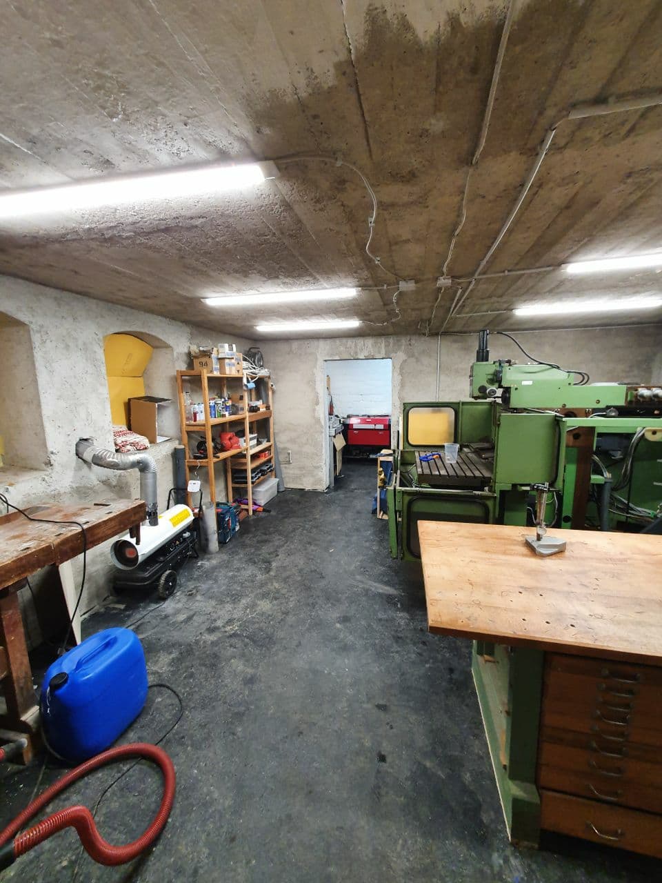

Workshop pre renovation:
Workshop after renovation: (Hole in the Wall got closed up in the meantime) Backroom picture coming soon)
Servos and Servo drives from Lichuan:

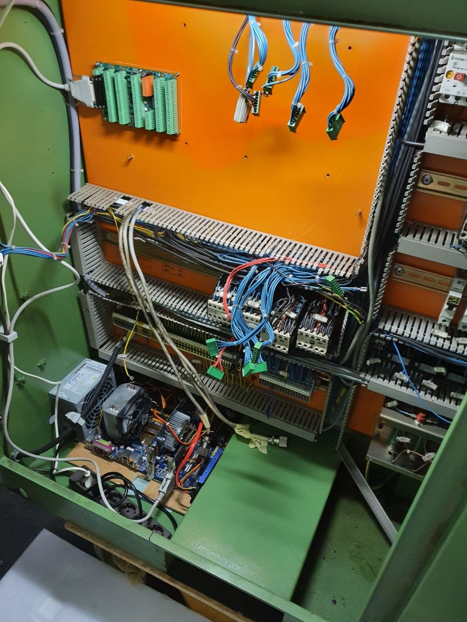

Originally the FP4A got controlled by a dialog 4 which connected to a PLC (SPS)
I decided to RIP both out and sell then to a spare part vendor as i cant afford buying replacement in case of something dying through that i nearly got the entire price of the machine back

And second of all i cant seem to find the correct relais in the wiring diagramm for the gearbox
could one of you please take a look and help me out? ?
Seems to be on page 10:
K13 for 'Block I"
K14 for 'Block II'
K15 for the 'Reduction Gear'
K16 to change the direction of the dc motors M5, M6, M7
[edit]
So you will need 9 inputs for the feedback switches and 4 outputs for the relays from the gear setting alone.
Nice even detailed schematics for the drives and power supplies.

Did you sell the SPS? That might not have been a great choice, as you will need some way to interface between the MESA's I/O's limited current capacity, and the various high current contactors. I guess you can do it all with classic ladder and a few relais, but the SPS would have had logic implemented which you will have to duplicate. Was the gearbox scheduling in the SPS or the Contour? By the Mesa, the scheduling was in the Phillips, and instead of an SPS, there is just a dumb Relais board.

19 Mar 2021 15:25 #202849 by MrSpeaky
Replied by MrSpeaky on topic Deckel Retrofit FP4A
I bought them directly from lichuan i messaged the email i got from aliexpress. So through that i managed to get then quite cheap
2 x 1.3Kw and once 2.6kw with a break with drivers for 980€ Plus shipping and Customs
Though now that i got then
the reason i bought them is because they support the +-10V from the Mesa 7i77
But i noticed that they also support Fancy Modbus over ethernet cable might actually be easier to controll then through that cause you can just connect them together but i dont know how that works
