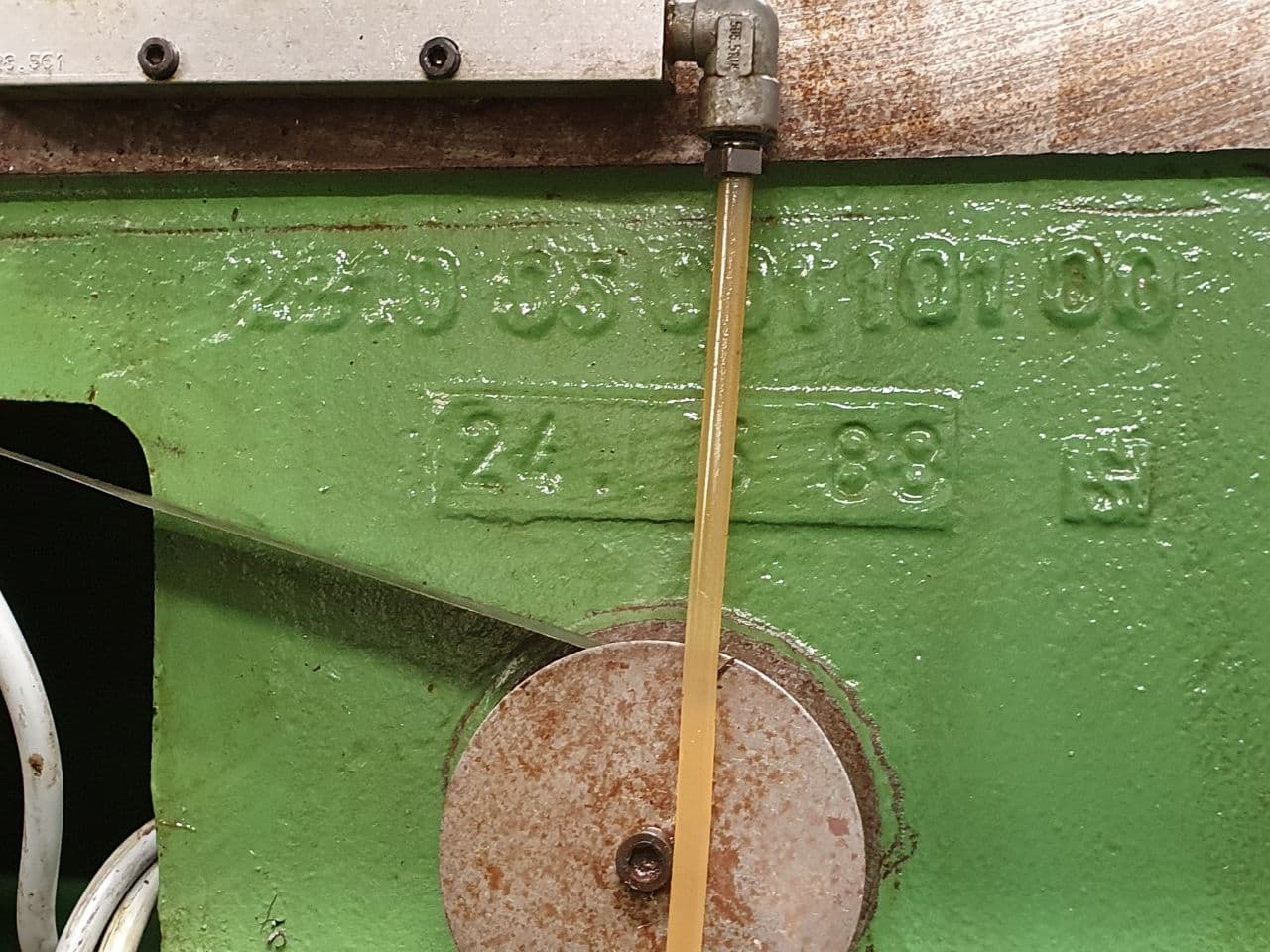

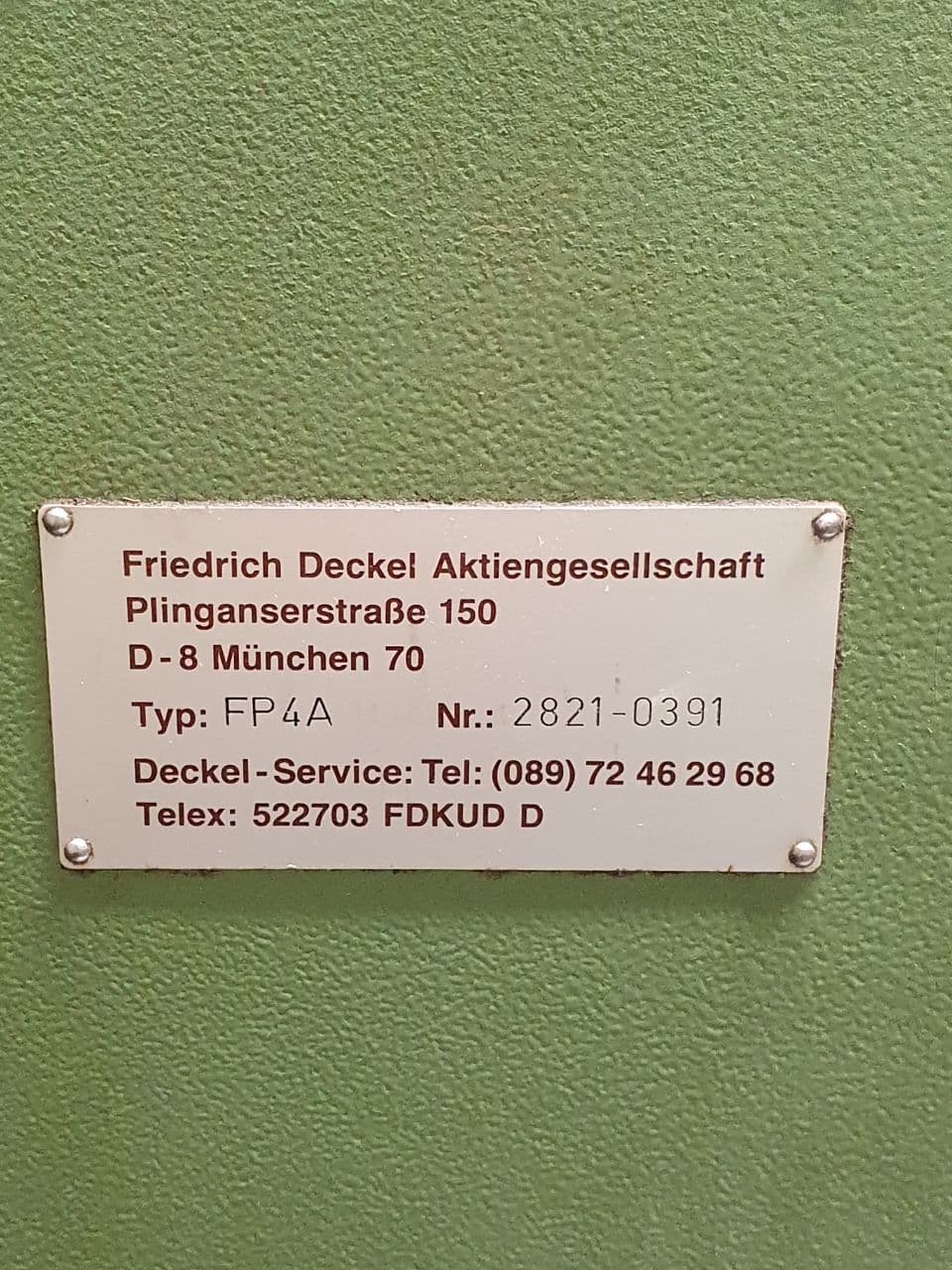

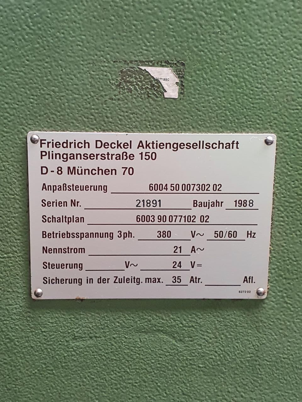

well. I found out my orange book does not fit my machine actually at least not 100%
the X Connectors do not match.
My machines has a serial number starting with
2810 -
built in 1988
which i cant find any orange books to online i also seem to have a very rare electrical cabinet being over 1.8m long
dialog5 and etc do not have the information i have.
somebody got another soruce?

- MrSpeaky
- Posts: 33
25 Mar 2021 19:42 #203656
by MrSpeaky
Replied by MrSpeaky on topic Deckel Retrofit FP4A
- db1981
- Posts: 790
- Thank you received: 276
25 Mar 2021 20:05 #203660
by db1981
Replied by db1981 on topic Deckel Retrofit FP4A
which control was this`?
- MrSpeaky
- Posts: 33
25 Mar 2021 21:27 #203662
by MrSpeaky
It was a Dialog 4 in a Contour 3 Housing (Replaced st some point)
- MrSpeaky
- Posts: 33
25 Mar 2021 21:29 #203663
by MrSpeaky
I am never gonna be this stupid again and buy a machine with an electrical cabinet that does not fit together
i noticed a small small amount of mismatch in the pin occupation of the X Connectors so i am gonna and will have to redo the entire electrical cabinet from Scratch... god this will take long
I am just gonna replace a lot now. Starting with an VFD
