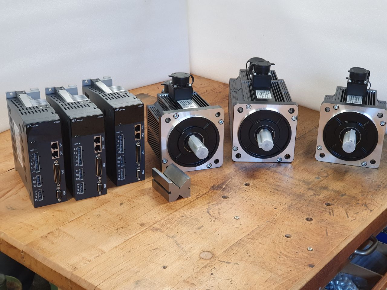

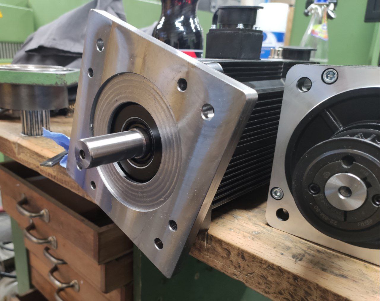

So after a long abscence from the forums k wanted to give an update
Well i got the Servo motors quite a while ago actually
They are from lichuan and seem to be yasakawa copys sadly they didnt fit to the original iec size mounting holes so i got adapters made by a friend living just 1 state away
The rest of the time got spend reverse engineering the pins of the harting connectors from the machine as i had the wrong documentation
ordering new electrical components
thinking about the wiring more and ordering more components and so on
i think for now i got a rough plan on how i could do it?
Well i am still thinking about how to exactly controll my hardware
or course i can controll my vfd with +10v
And my Servo drives with +-10V
as my mesa cards supports
but then the functionality of my servo drives which support modbus and profibuss over an ethernet cabel and my vfd supporting modbus aswell kinda would go to waste
Though i have to be honest i still dont get the difference between all thw protocolls and version
And even how to possibly go about connecting my profibus/modbus servodrives to linuxcnc which use an rj45/ethernet plug
while the vfd uses raw rs232
also i heard it would be bad necause of the delay involved?
What is your guys opinion about the topic
Of course all of this came up cause i decided to rip all the old electrics out and redo it
Thanks for reading my monologue
i hope i can show you guys one day a working mill

Replied by tommylight on topic Deckel Retrofit FP4A
You are welcomed !
To be blunt, i do not care about any of the buses = to many of them and each and every one of them has a weak and a good point, hence i never bother with them. Not sure but i think modbus is not real time capable so that leaves it out of everything for me.
My advice, use the analogue controls with encoder feedback on everything and never look back.

29 Apr 2021 16:26 #207411
by MrSpeaky
Replied by MrSpeaky on topic Deckel Retrofit FP4A
okay i will do
i just had to hear that from somebody to make me stop possibly thinking back
