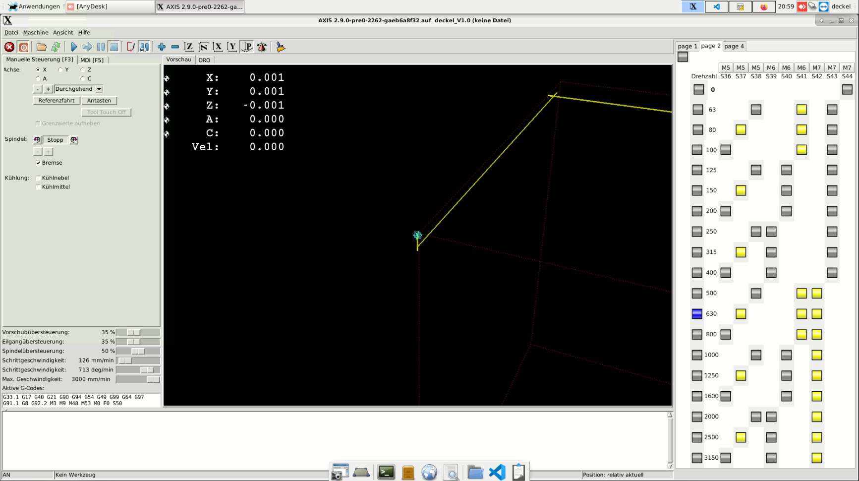

20 Mar 2021 09:21 - 24 Mar 2021 19:55 #202952
Such Panels can be integrated in axis and gmoccapy using GladeVCP .
linuxcnc.org/docs/html/gui/gladevcp.html
Replied by Aciera on topic Deckel Retrofit FP4A
does somebody know what component he used to create this interface?
Last edit: 24 Mar 2021 19:55 by Aciera.
The following user(s) said Thank You: MrSpeaky

20 Mar 2021 10:18 #202957
by MrSpeaky
Replied by MrSpeaky on topic Deckel Retrofit FP4A
Thank you
- MrSpeaky
- Posts: 33
20 Mar 2021 10:19 #202958
by MrSpeaky
not on this forum and i dont wanna name him
he doesnt wanna share it, which i can understand so i will try to edit
Marks (RotarySMP) C component which is thankfully fully commented

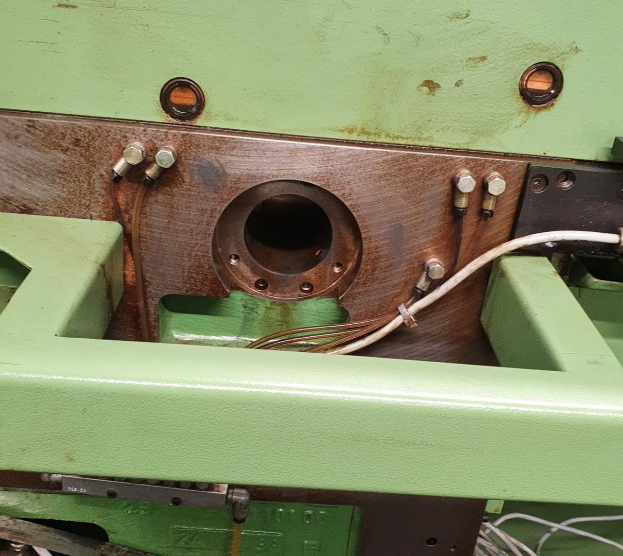

24 Mar 2021 19:39 #203534
by MrSpeaky
- db1981
- Posts: 790
- Thank you received: 276
24 Mar 2021 19:59 #203536
by db1981
Replied by db1981 on topic Deckel Retrofit FP4A
can you post an picture with more environment please,
i'm not shure from which point of view this is..

25 Mar 2021 08:34 - 25 Mar 2021 08:35 #203591
by db1981
this hole is normal. they have used the same steelcast for many versions, on manual or machines with only on axis motor or additional Handwheels there have been bearings and gears mounted.
If you look through this hole, you should see the Y axis Ballscrew.
Pay attention to the oil levels, theses are for the transmission and the spindle bearings.
Do you own an maintance manual?
Last edit: 25 Mar 2021 08:35 by db1981.
