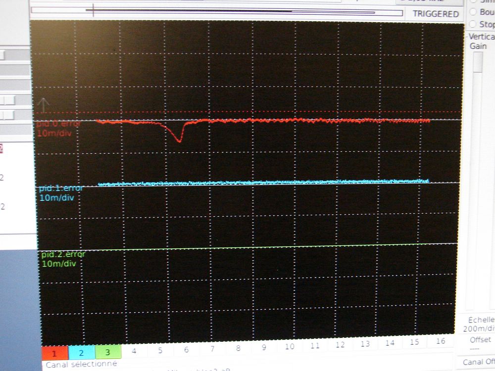

17 Apr 2021 08:22 - 17 Apr 2021 09:55 #206162 by gaston48
Replied by gaston48 on topic Retrofitting Mikron WF41C
[quote=
PS: @gaston48: As you already figured out the analog servo control of your Mikron would you be willing to share your PID parameters with us. This would probably help us quite a bit.[/quote]
Hello,
My parameters, under 2.7.15 RTAI therefore under 32 bit
servo_period 500 000 ns
In hal, encoder.velocity => pid.feedback-deriv connected
switching from analog output of the TNC 355 to analog
output of the 7i77 may require a correction of the offset
Bosch amplifiers
We set a good margin to FERROR and MIN_FERROR 200 for example
We test the activation and deactivation of the bosch amplifiers, we check that
the Z brake is indeed deactivated and reactivated ...
If necessary, offset is corrected.
Then axis 0 FF1 = 0.101 axis 1 FF1 = 0.101 axis 2 (Z) = 0.121
we test with jog if real speed = speed reference
we check if axis direction +++ also involves encoder count +++
Then we go up P and D for minimum error without oscillations and noise
my final parameters:
axe 0 P = 8 I = 0 D = 0.03 FF0 = 0 FF1 = 0.101 FF2 = 0
axe 1 P = 8 I = 0 D = 0.03 FF0 = 0 FF1 = 0.101 FF2 = 0
axe 2 P = 7 I = 0 D = 0.03 FF0 = 0 FF1 = 0.121 FF2 = 0
The "spike" at reverse motion is approximately equal to that of the TNC 407
I have not yet tested FF2 to try to minimize this error
reverse "spike" with tnc 407 dia 40 mm and halscope error spike with linuxcnc
Last edit: 17 Apr 2021 09:55 by gaston48.
