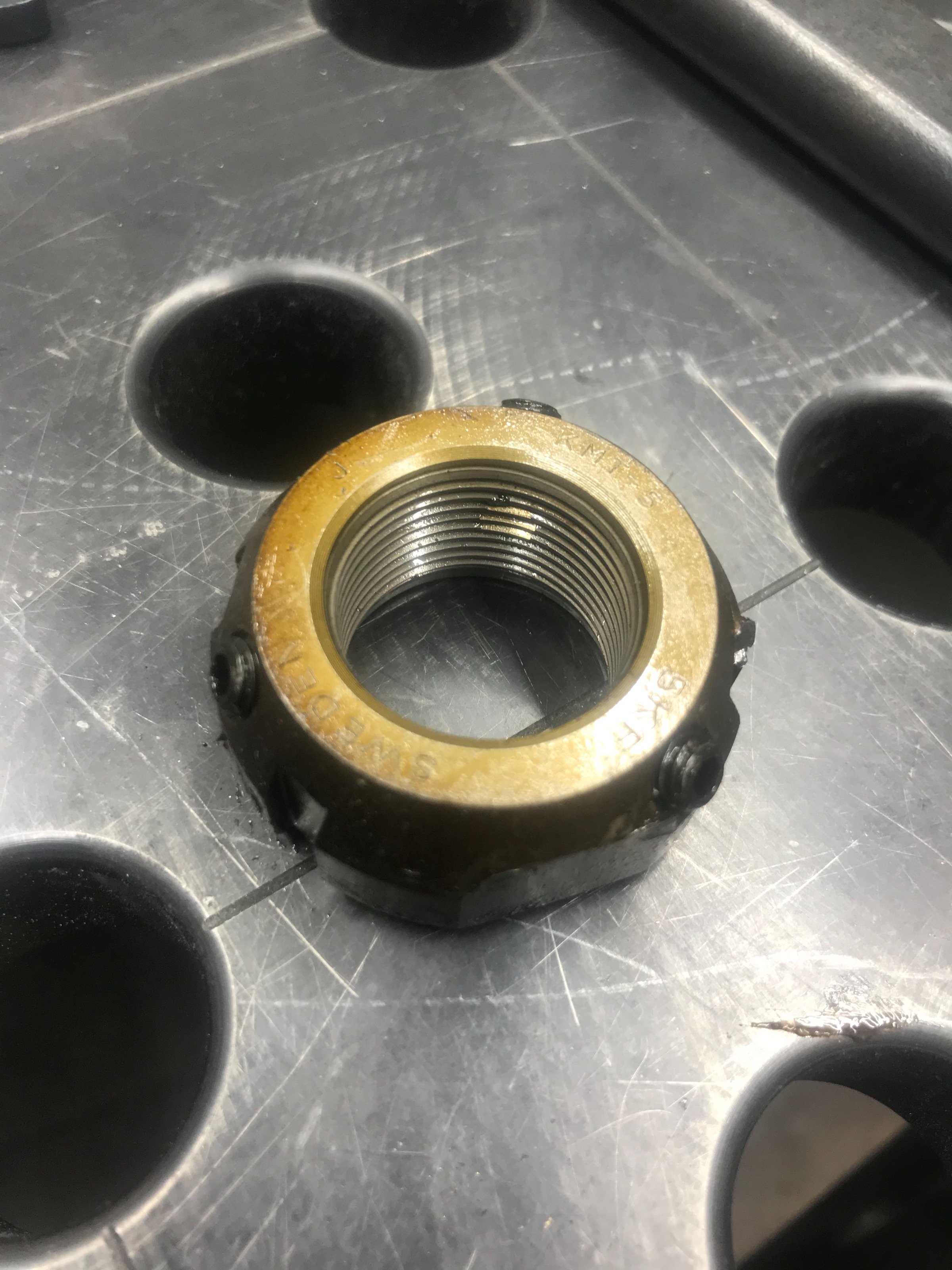

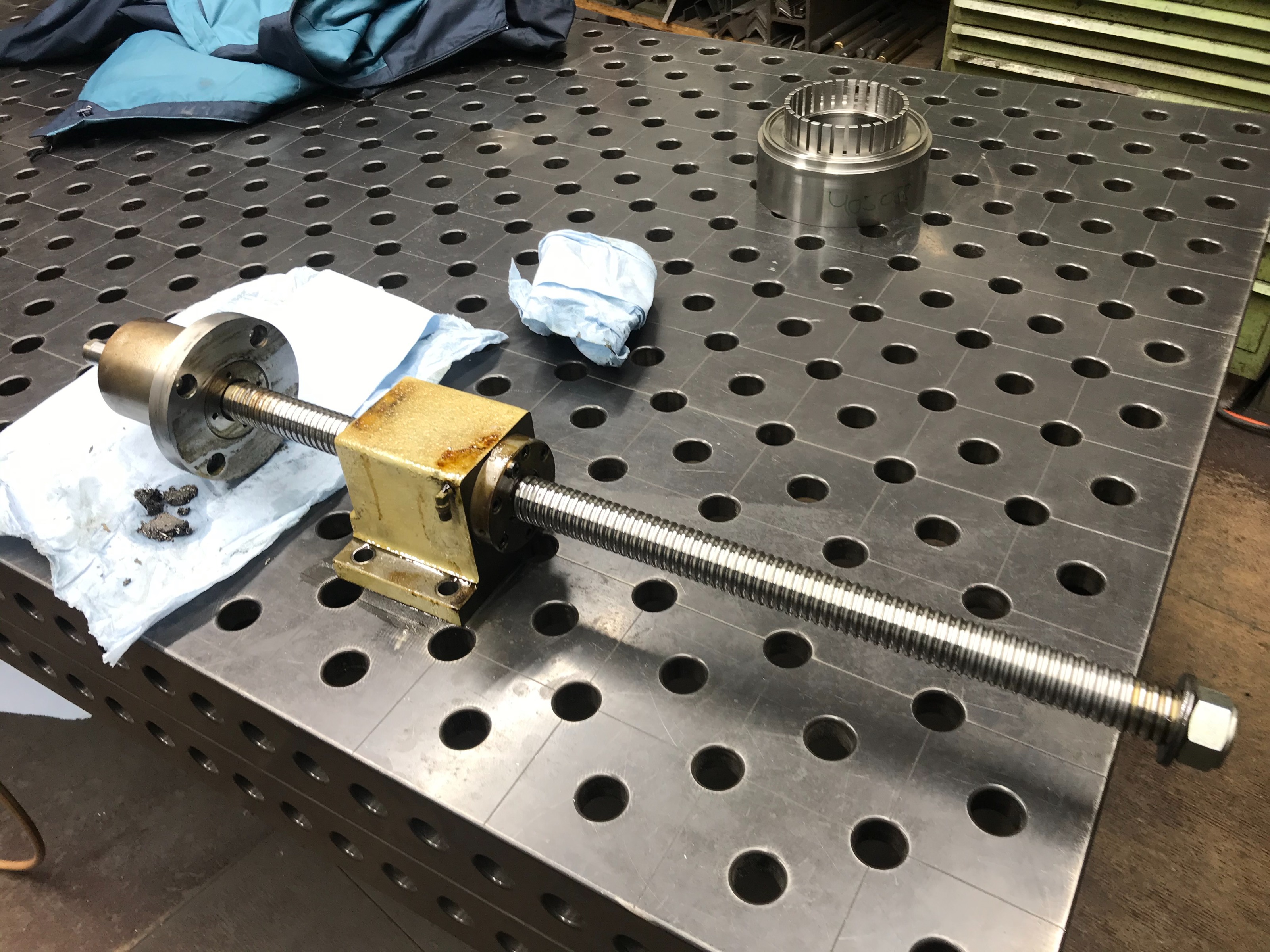

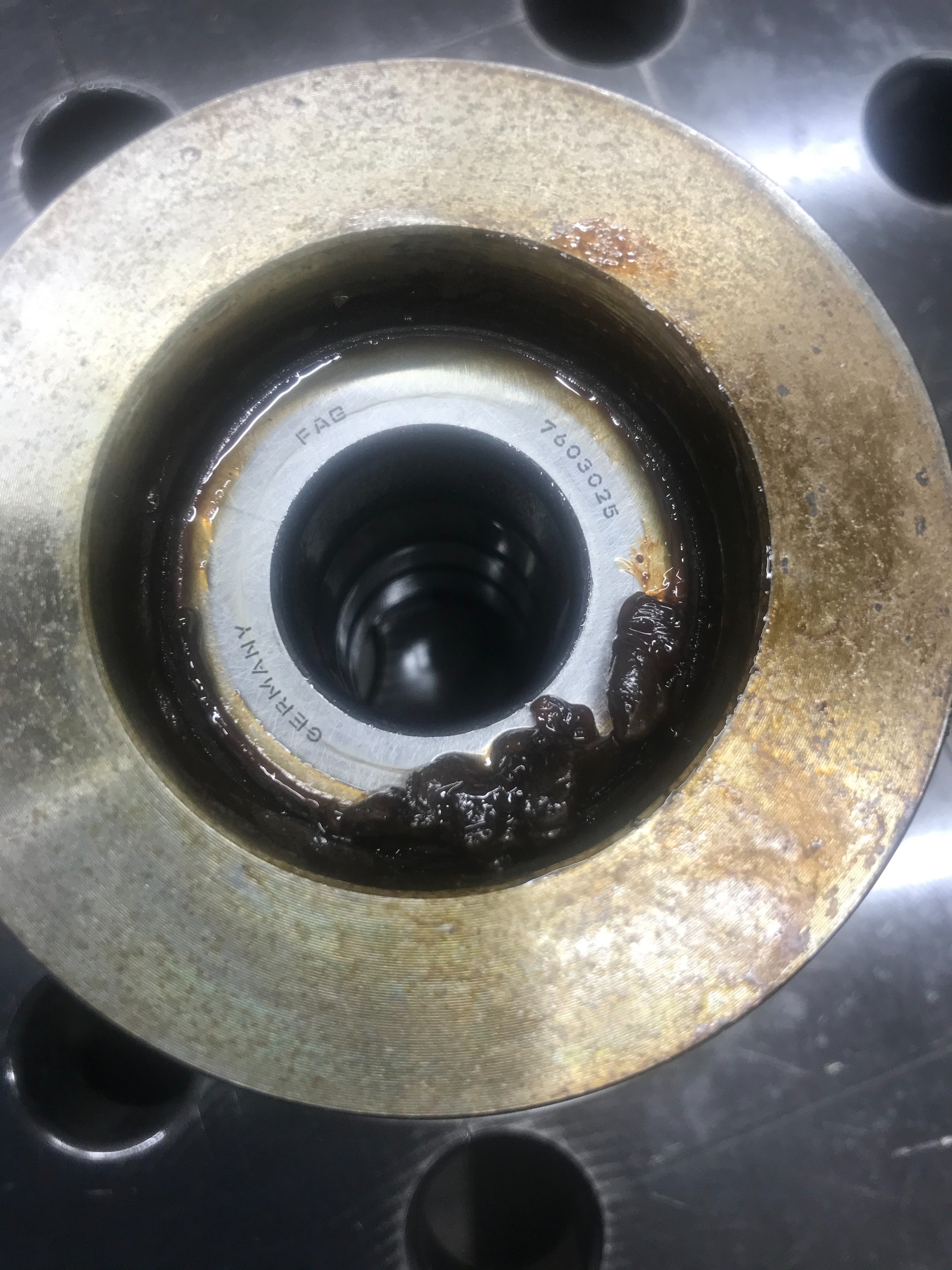

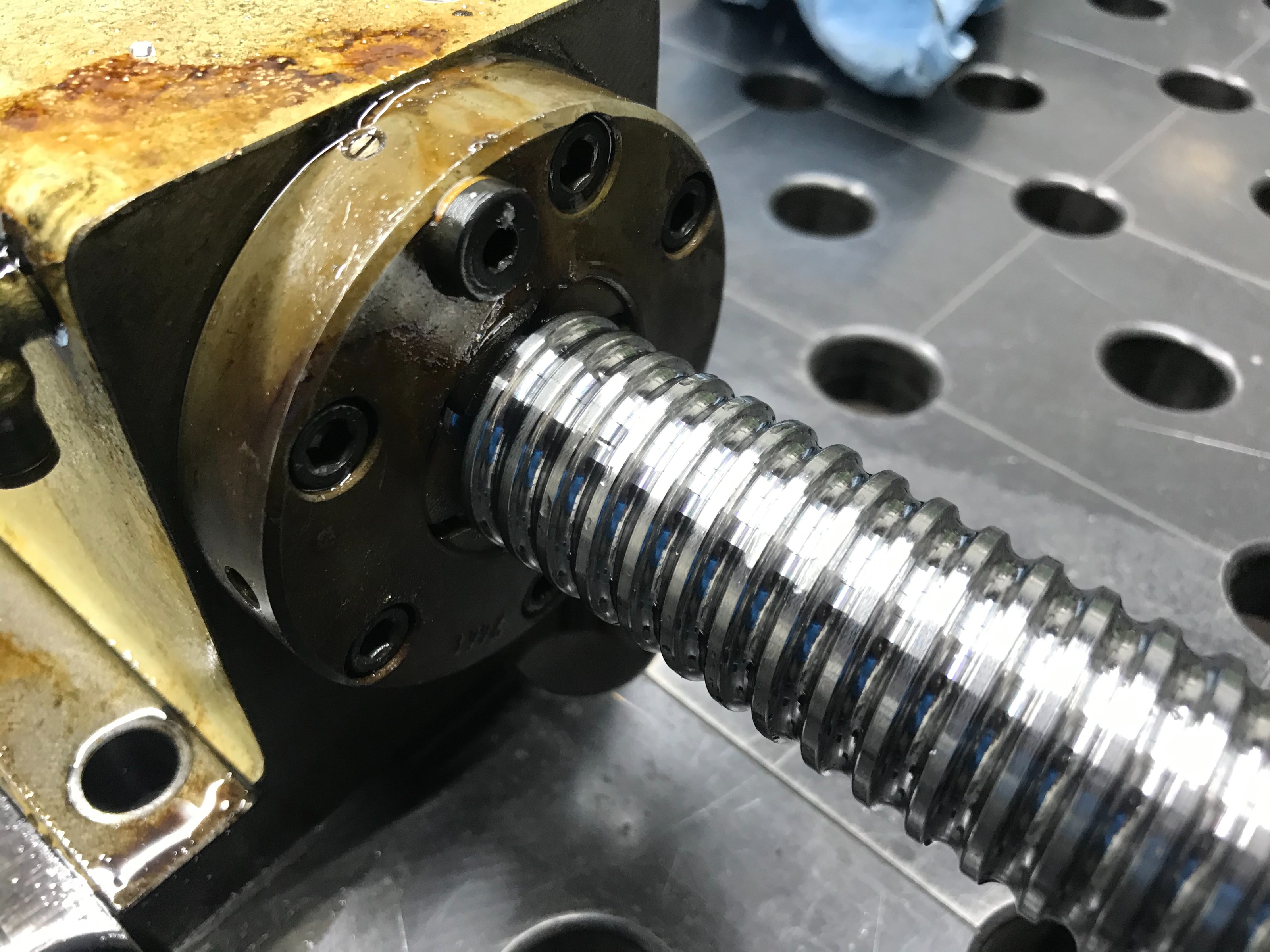

Damage update
We checked the ball screw by fixing a 0.001mm dial indicator to the ball screw nut and having it touching on the ball screw thread. Then we turned the ball-screw forth and back and like that we would see any play between ball screw and ball screw nut. The result was mind blowing to me. There was not only zero play, the surface quality of the ball screw is so perfect that the 0.001mm indicator didn't move at all. I hade to touch it several times to make sure that it was actually working. This is really a testimonial about the quality of these machines and also underlines why it is worth to still invest in them with a new control.
Then we removed the whole ball screw assembly from the machine.
Now we could very clearly feel that the bearings in the fixed block were damaged. They made a clear grinding noise when turning the ball screw by hand while as expected after the measurement the ball screw nut was moving smooth like butter.
Sow we further disabled and removed the fixed block. Here the nut that fixed the ball screw to the fixed block (notice the little brass inserts that are worked into the nut and that lock the nut onto the thread when tightening the three set-screws).
And here finally the fixed block with 4 axial trust bearings.
So after the initially excitement that ball-screw and nut were still perfect we got a little surprised when we realized that the 4 axial bearings (being as well super high quality standard) are 200 Euro each. Nevertheless still much cheaper than dealing with a broken ball screw.
Next we have now to make a little custom tool with 4 pins to remove the cap from the fixed block (see first picture) and order the bearings.
