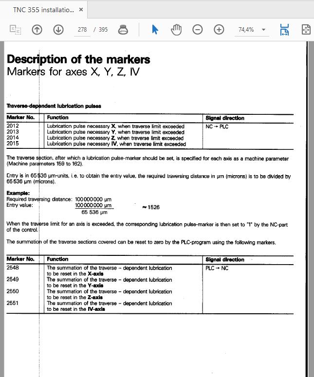

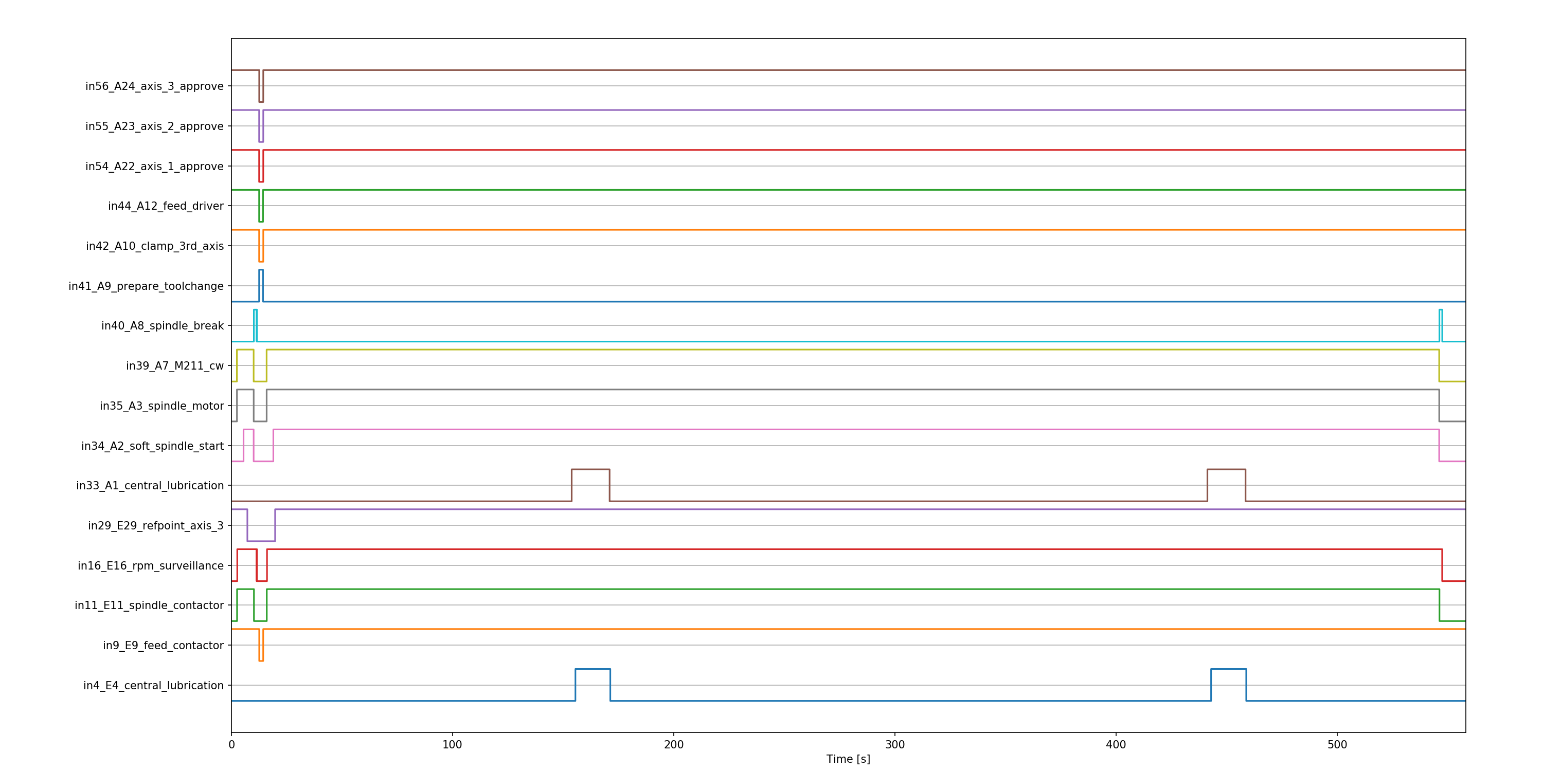

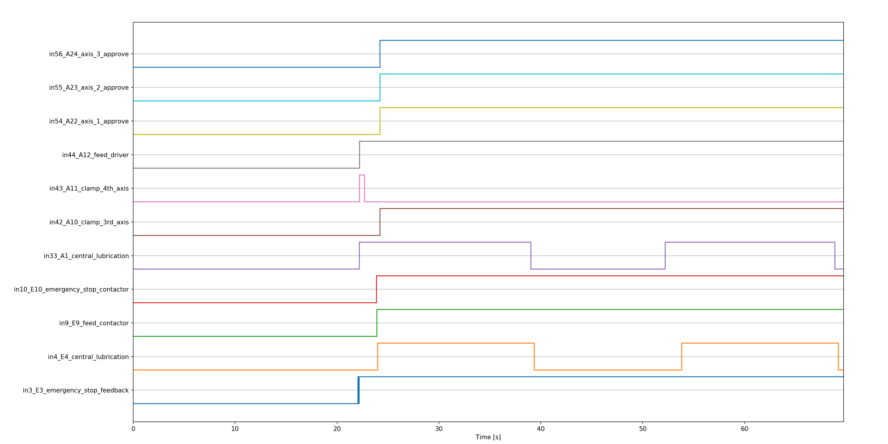

today we recorded a bunch of operations on the Mikron. Regarding lubrication I found the following:
All the lubrication cycles issued by the machine are approximately 15 sec.
At startup there are two 15 sec cycles interrupted by a 15 sec break (see first picture and data attached).
During a repeated sub-program run where the machine did a 100mm circle followed by a 100mm up and down move with Z I found that the machine is issuing as well 15 sec lubrication cycles from time to time.
Between the two lubrication cycles the described program run pretty much exactly 40 times i.e. each axis traveled 8000mm and did 80 direction changes. I assume that the distance triggered the lubrication.
I hope this is useful.

Thank you very much Marc,
I will adopt a 15 second operating delay
I consulted the TNC 355 documentation, you have the same parameters
than my TNC 407, only on the distance traveled
you must find the parameter = "122" (8000000/65536)
good continuation !
