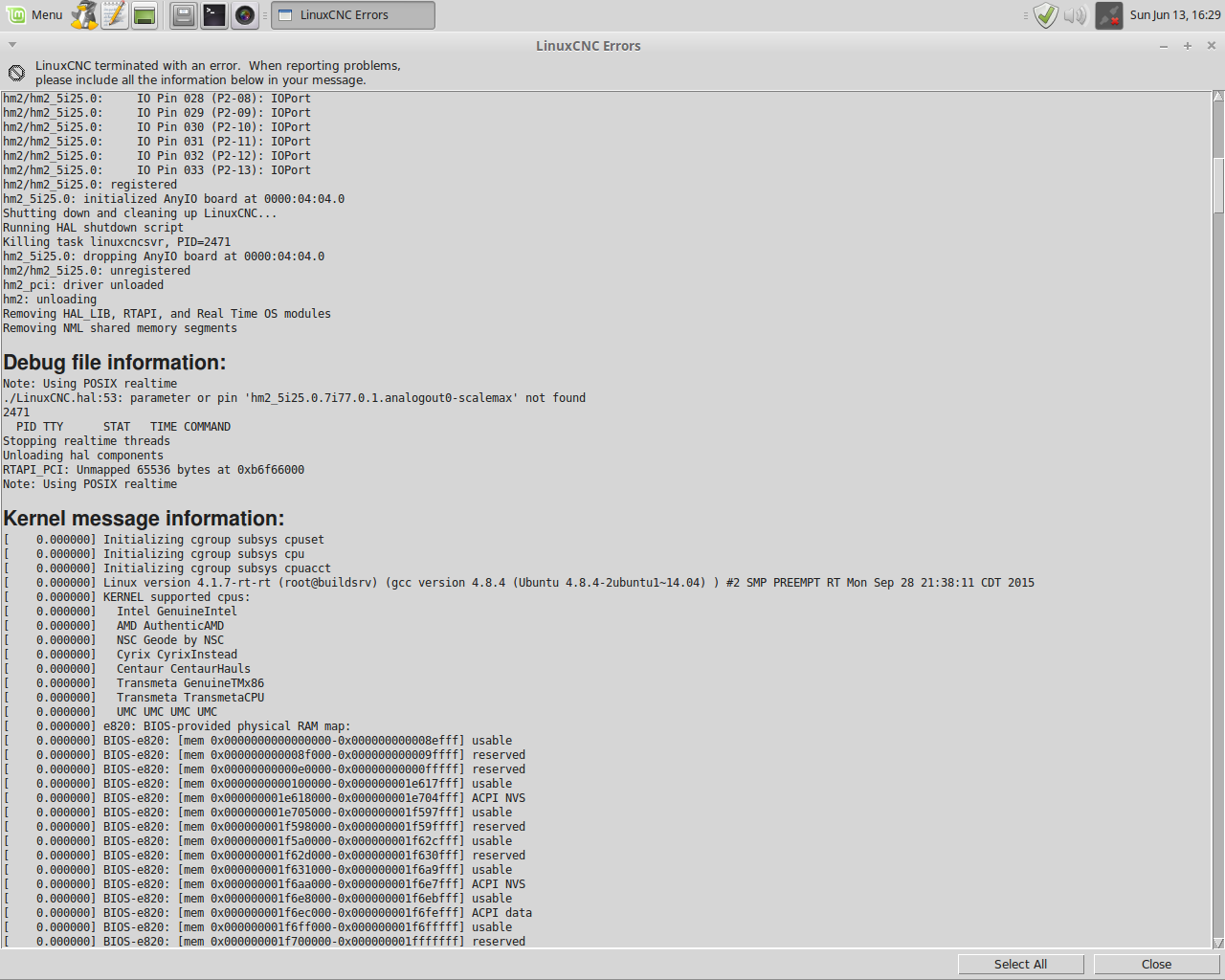

Many, many thanks, andypugh, I have read your reply:I have just got off phone with news: I am working with AMC support engineer a question has come up about when booting up LinuxCnc it appears as if I had forgotten to power up the power supply for the AMC drives

06 May 2022 19:35 #242167
Replied by andypugh on topic Set up using AMC AB15A100 drives, brushed DC motor Prototrak Plus with Encoders
5i25.0.7i77.0.1.analogoutout0-scalemax not found
This might indicate that the 7i77 field power supply (which runs a small processor on the 7i77 ) might not be connected.
This is (typically) the 24V supply used for limit switches etc, which it is quite reasonable to not expect to need yet. (It doesn't have to be 24V, anywhere from 5 to 30 is OK)

06 May 2022 19:59 - 06 May 2022 20:43 #242170
by new2linux
Replied by new2linux on topic Set up using AMC AB15A100 drives, brushed DC motor Prototrak Plus with Encoders
Many thanks, andypugh!!
I will be checking the 2 small transformers for voltage over the weekend.
Many thanks for your time.
Edit: There are 2 transformers, 1 is 5.6 v DC; the other 1 is burnt out, it was 24 v DC, went to TB-2. I plan to try the other 5.6 v DC transformer to both TB-1 & TB-2.
Many thanks, I am very greatful for the help!!

08 May 2022 14:14 #242302
by new2linux
Over the weekend, I used the 5.6 v DC transformer (power supply to TB-1) & then, used a 12 v rechargeable battery to supply power to TB-2. The same error message appears both times, "5i25.0.7i77.0.1.analogoutout0-scalemax not found". To be clear, TB-5, pins 1 & 2 are not connected to anything, yet. I have ordered replacement 24v DC transformer.
Many, many thanks for helping, all suggestions are warmly welcomed.
