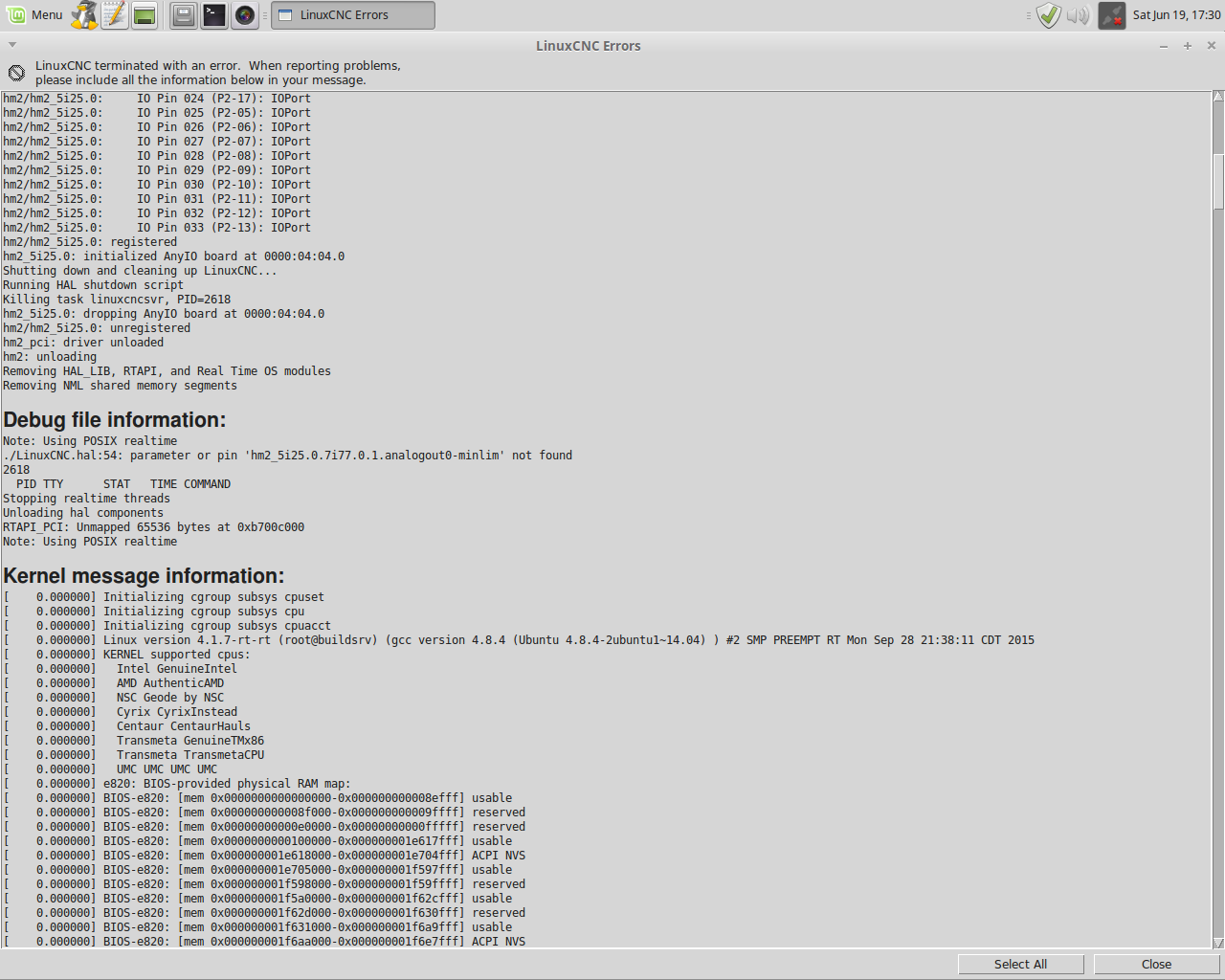

tommylight, Many thanks for all your help! This attached pic is after # to 3 lines;
#setp hm2_5i25.0.7i77.0.1.analogout0-scalemax [AXIS_0]OUTPUT_SCALE
#setp hm2_5i25.0.7i77.0.1.analogout0-minlim [AXIS_0]OUTPUT_MIN_LIMIT
#setp hm2_5i25.0.7i77.0.1.analogout0-maxlim [AXIS_0]OUTPUT_MAX_LIMIT
Many thanks
Many thanks

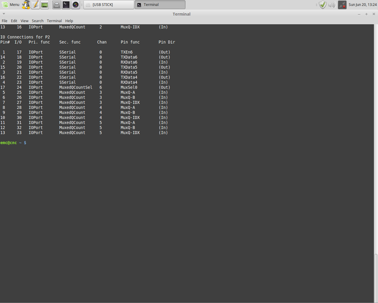

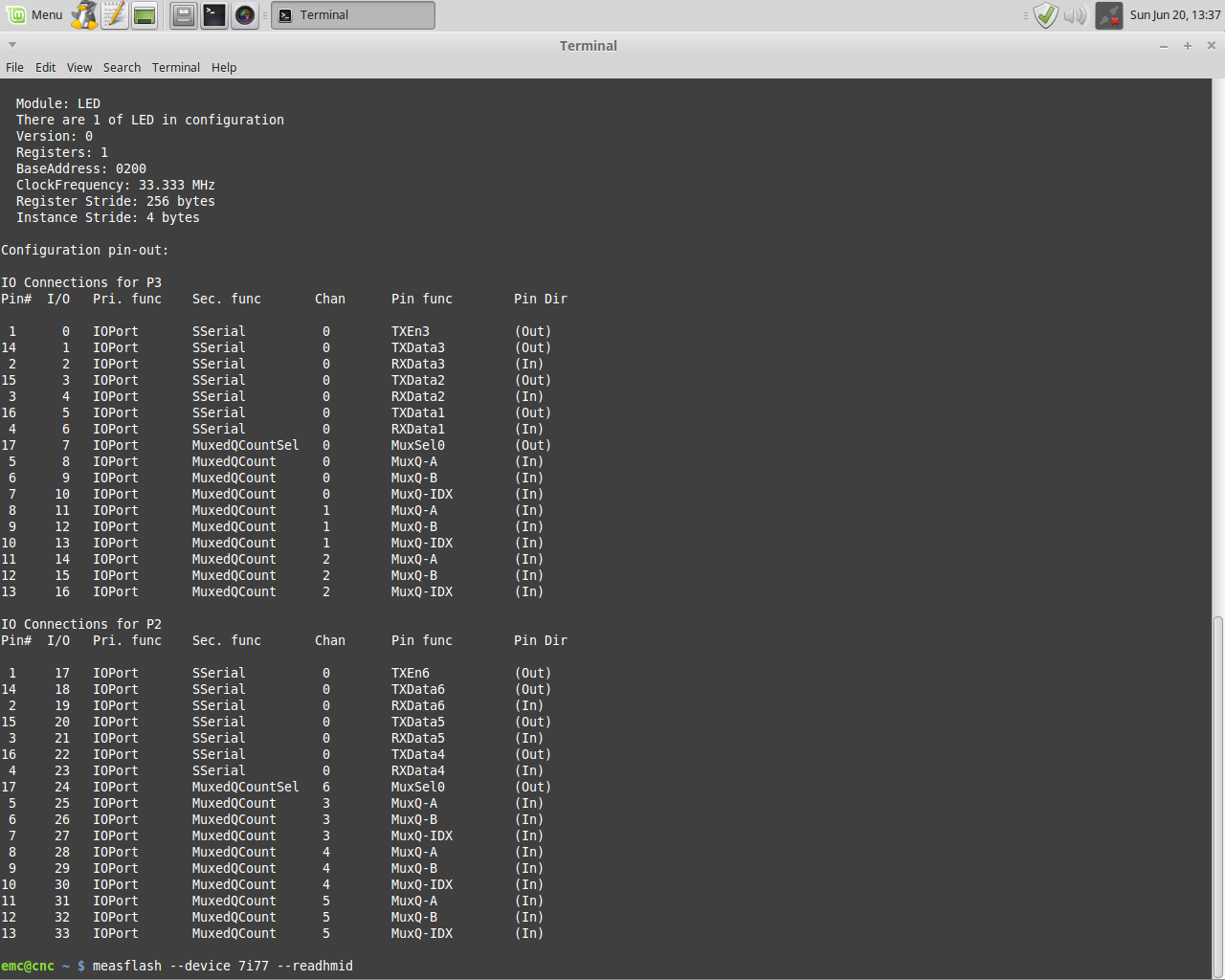

This is a pic of the results from "mesaflash --device 5i25 --readhmid" at terminal screen. I believe this is correct.
Edit: It appears there was more info, see 2nd pic. Edit: add complete file
This is a copy & paste of the 5i25 readhmid report.

Replied by andypugh on topic Set up using AMC AB15A100 drives, brushed DC motor Prototrak Plus with Encoders
LinuxCNC is not finding the 7i77. I keep saying that.
The 5i25 is working. I don't think that the 7i77 is.
Do you see _any_ HAL pins with 7i77 in them? There were none last time you posted a pin list.
Rather than screenshots of the error message, press the "select all" button at the bottom, then copy and paste it here, or to a text file. There is important information off the top and bottom of the screen.
What we _can_ see is that there are no encoders on P2 either. What does your "loadrt hostmtot2" line in the HAL say?

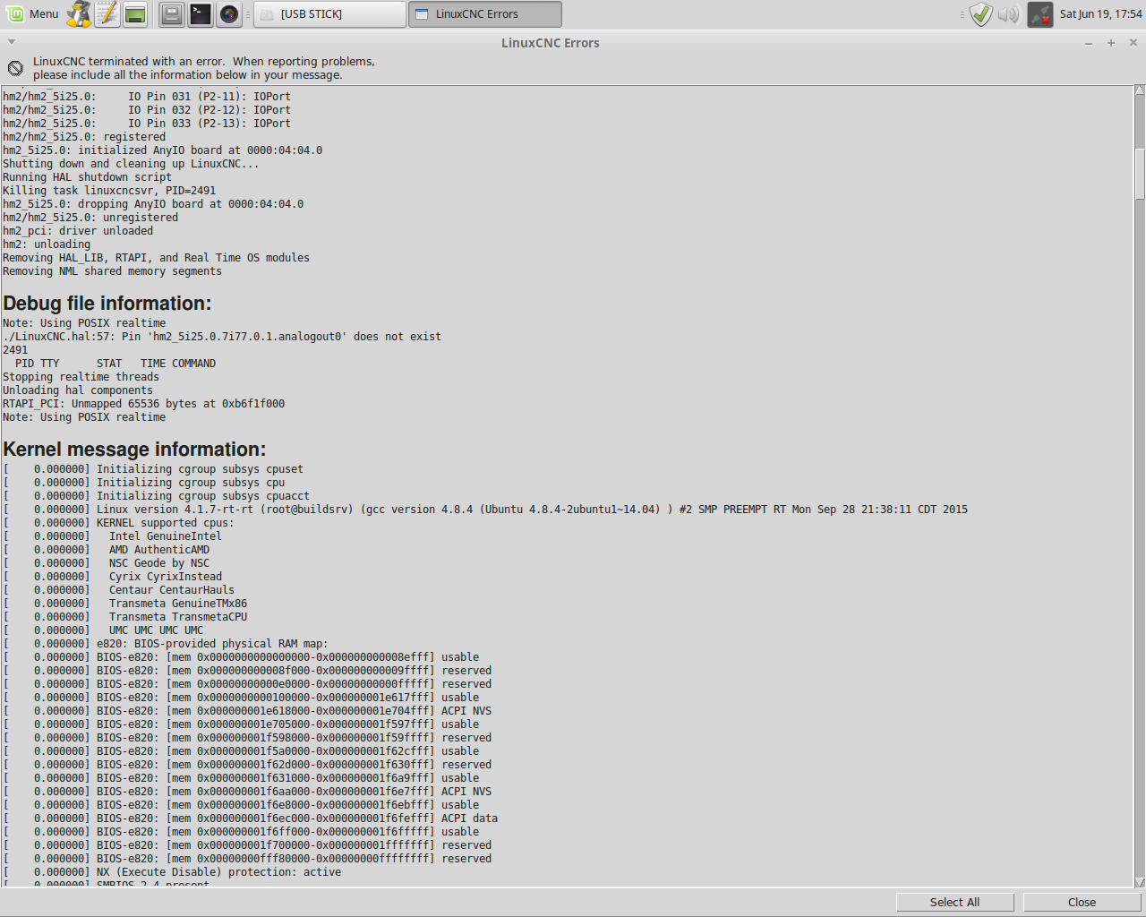

andypugh, Many thanks!! These attached files show the pin out saved as .txt file. I also included the error file with a wire going from AMC SW-1 connector; pin 11 GND going to 7I77 CARD TB-3 connector 3 GND. When the encoders were counting, this was the wiring diagram (in the 1st post) at that time.Many thanks!
Edit: This 3rd attachment is error w/o GND wire going to TB-3; everything else is the same. If you compare this part of the file that has GND to TB-3 this has encoder info:Starting LinuxCNC...
Found file(REL): ./LinuxCNC.hal

./LinuxCNC.hal:57: Pin 'hm2_5i25.0.7i77.0.1.analogout0' does not exist
Compare to the same area with GND connected, one has no encoder info.

It appears to me that w/o having GND (from encode/ TB-3) to AMC SW-1 pin 11 (GND) shows encoder. My thinking was that the encoders needed their own GND wire. In addition, when the only thing that worked was the DRO had the GND wire to TB-3.
The encoders working doesn't tell us anything, as they are passively connected directly to the 5i25.
We are not seeing any sign of the 7i77 onboard processor working.
Attach your HAL and INI files.
