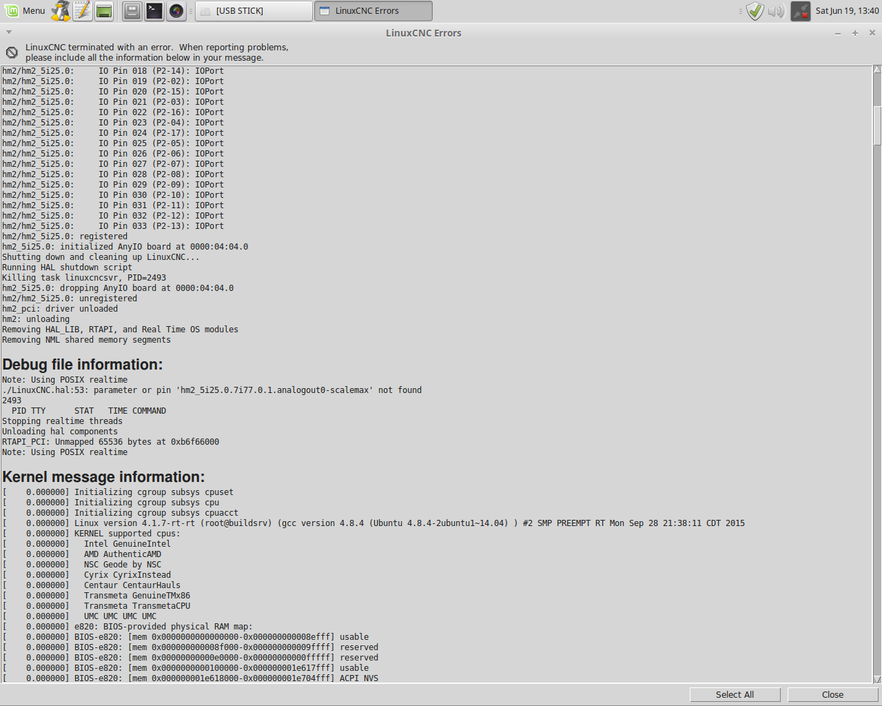

Without LinuxCNC running, open a terminal.
halrun
loadrt hostmot2
loadrt hm2_pci
show pin
exit
Copy and paste the output here.

andypugh, Many thanks!! The file is attached/inserted.
10 May 2022 23:37 #242537
Replied by andypugh on topic Set up using AMC AB15A100 drives, brushed DC motor Prototrak Plus with Encoders
It hasn't found the 7i77. The most likely explanation is that field power is not being supplied to the IO board section.

The transformer arrived early, & I installed it today. The error message is close to the same, see attachment.

11 May 2022 22:51 #242687
Replied by tommylight on topic Set up using AMC AB15A100 drives, brushed DC motor Prototrak Plus with Encoders
Most probably the 7i77 is working and found by LinuxCNC, but something is amiss with the scaling, also probably missing in the ini file.
I had this error before, so to do a quick check, just omit that line in hal for now.
With no power to the 7i77 it will complain about not finding analogout0 with no "scalemax" in the line.

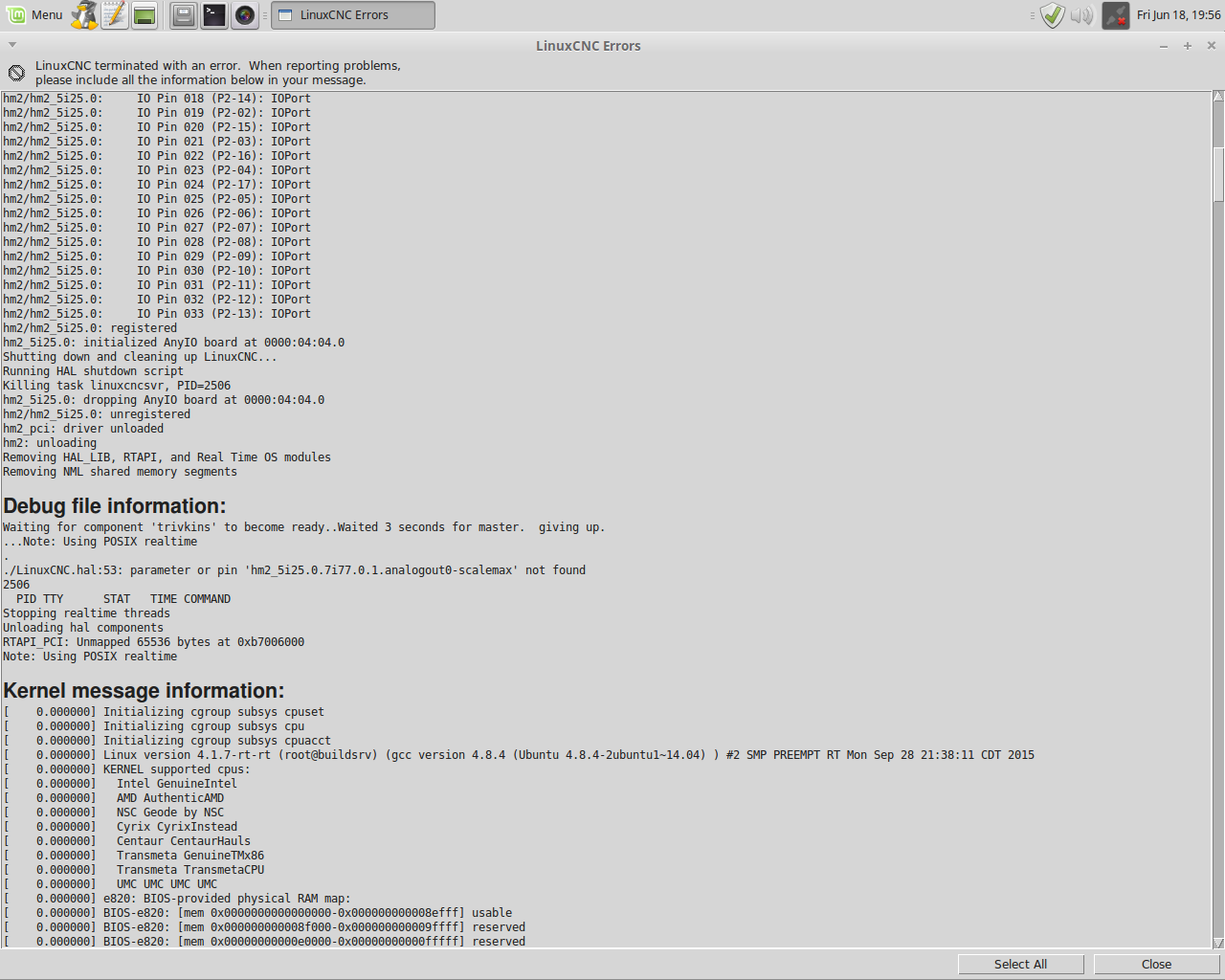

tommylight & andypugh, Many, many thanks for your help. Is there a way to, or I may be thinking of something else. Is it "Re" or another way to leave the line in and have it not recognized?
Please remember, TB-5 (Pins 1 & 2) and A-M-C SW-1 (Pins that will be used are 2 (Signal GND) & 9 (Inhibit/Enable)) on the driver are not connected. These pins are the pins that make it move, but unsure of their proper final location. A-M-C's engineer will be returning soon. As I recall, a check of some kind is needed to know the exact final diagram.
DB25 cable; the cable I am using is the same cable from the "back EMF" system, have not changed it.
Many thanks for all the help & support!!
In front of the line.

Many thanks, I found that line only 1 place & use # in front of it, but a similar error code, see attachment. Included is a copy of .ini file with #.
thanks!!
