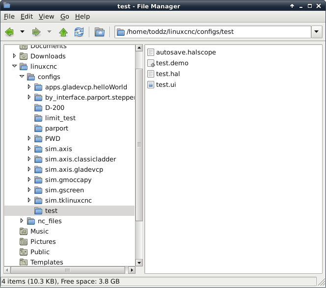

15 Aug 2022 12:45 #249776
Replied by Todd Zuercher on topic Set up using AMC AB15A100 drives, brushed DC motor Prototrak Plus with Encoders
The diagram looks fine.
Did you make the file "test.demo" executable?
There are two ways to open the file, the first is choose it from the Linuxcnc Config Picker, the 2nd is to type "~/linuxcnc/configs/test/test.demo" at the command prompt. (Assuming you have it saved to that dir.)

15 Aug 2022 12:50 #249778

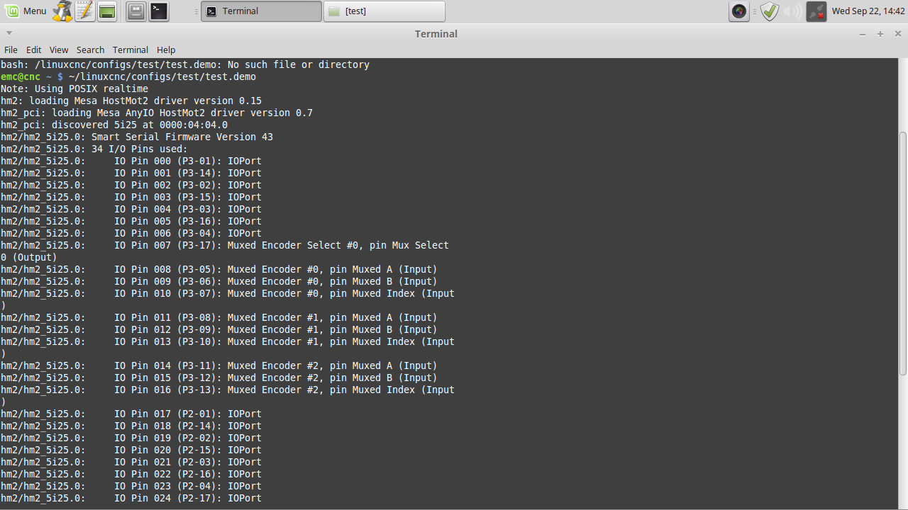

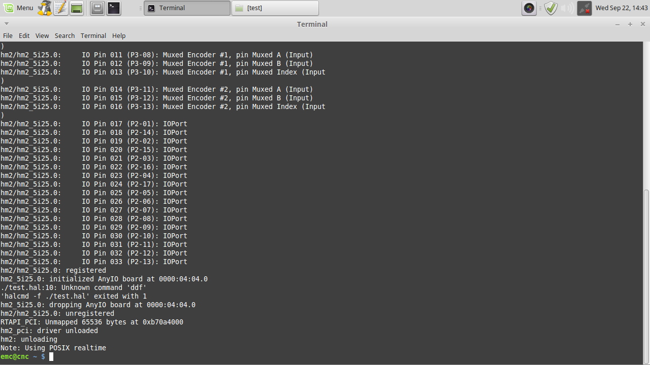

15 Aug 2022 14:24 #249786
by new2linux
Replied by new2linux on topic Set up using AMC AB15A100 drives, brushed DC motor Prototrak Plus with Encoders
Todd, many thanks! A pic of the error message from opening "test" in terminal. The screen is long so 2 pics.
I am working attaching the short temp wires to TB5 & the P1 connector.
Many thanks!
Many thanks!

15 Aug 2022 16:01 #249794
Sorry about that. There is a typo on line 10 of the hal file (test.hal)
The hal file should be

15 Aug 2022 16:06 #249795
The unknown command "ddf" on line 10, should have been an "addf". The "a" was left off.
