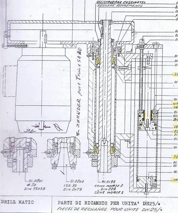

07 Feb 2022 21:13 #234291 by jpg
Good evening, I found a diagram of spindle with oblique bearings + some other examples
The following user(s) said Thank You: OT-CNC

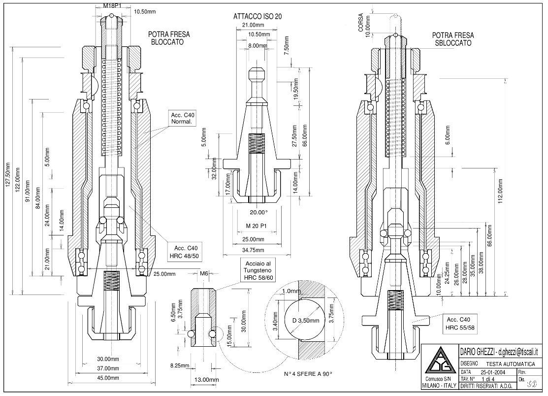

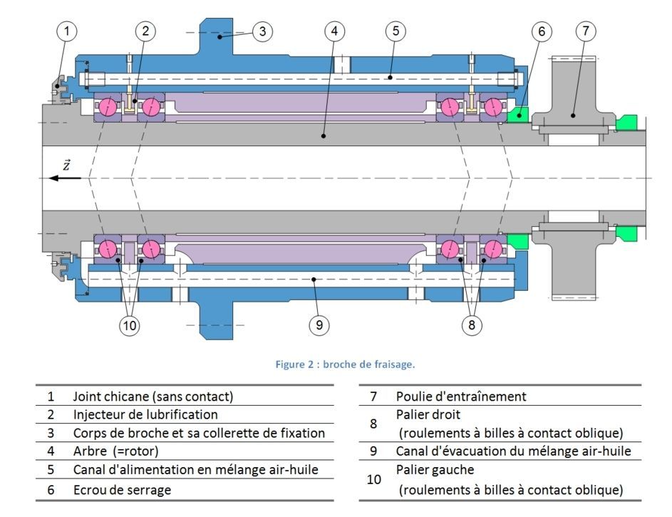

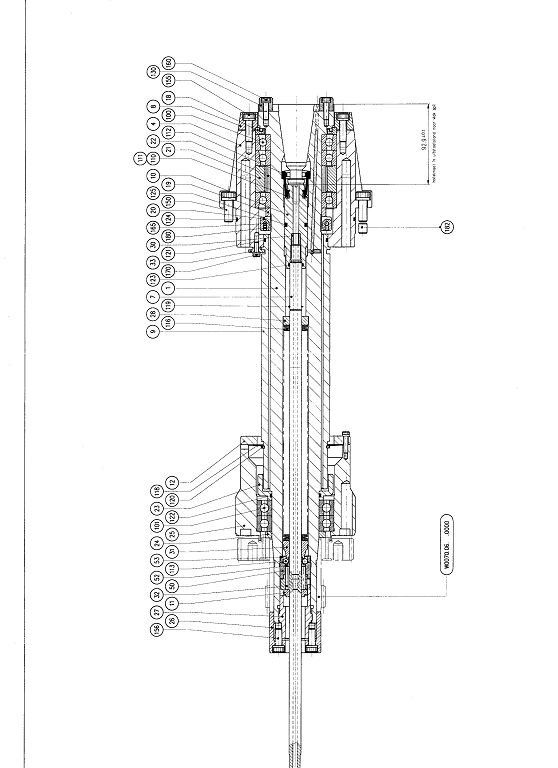

07 Feb 2022 21:36 #234293 by jpg
