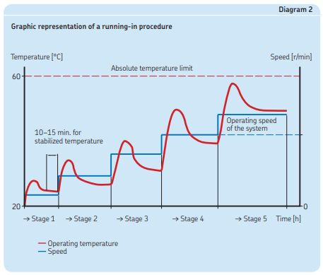

09 Feb 2022 00:31 #234366
by MrK
I do not know really how bad it is that one of my bearing pairs is P5 (the mysterious Koyo bearings). I see similar specs. for rpm also for P5 bearings. I should, as you say, check temperature and go slow. In fact I think the 18000 rpm in a back to back configuration with grease is a bit on the edge for my bearings.
If I will have to run the spindle slower, at the moment that is not the end of the world. The machine is right now a "brick" and priority is to get it up and running. If (I mean when...) I do get the machine fully operational then buying some higher grade bearings (still old stock from e-bay I would presume) would be an investment.
The run in process you describe is very similar to what I read about. like in picture below.
/MrK
Replied by MrK on topic Retrofitting 5 axis Willemin W400 with LinuxCNC
Yes indeed. But while P5 might be normal for spindles it is two tolerance classes above what at least SKF uses as "normal" tolerance.I'm pretty sure that P4 is more precise than P5. (P5 is considered standard precision and P4 is high precision.)
/MrK

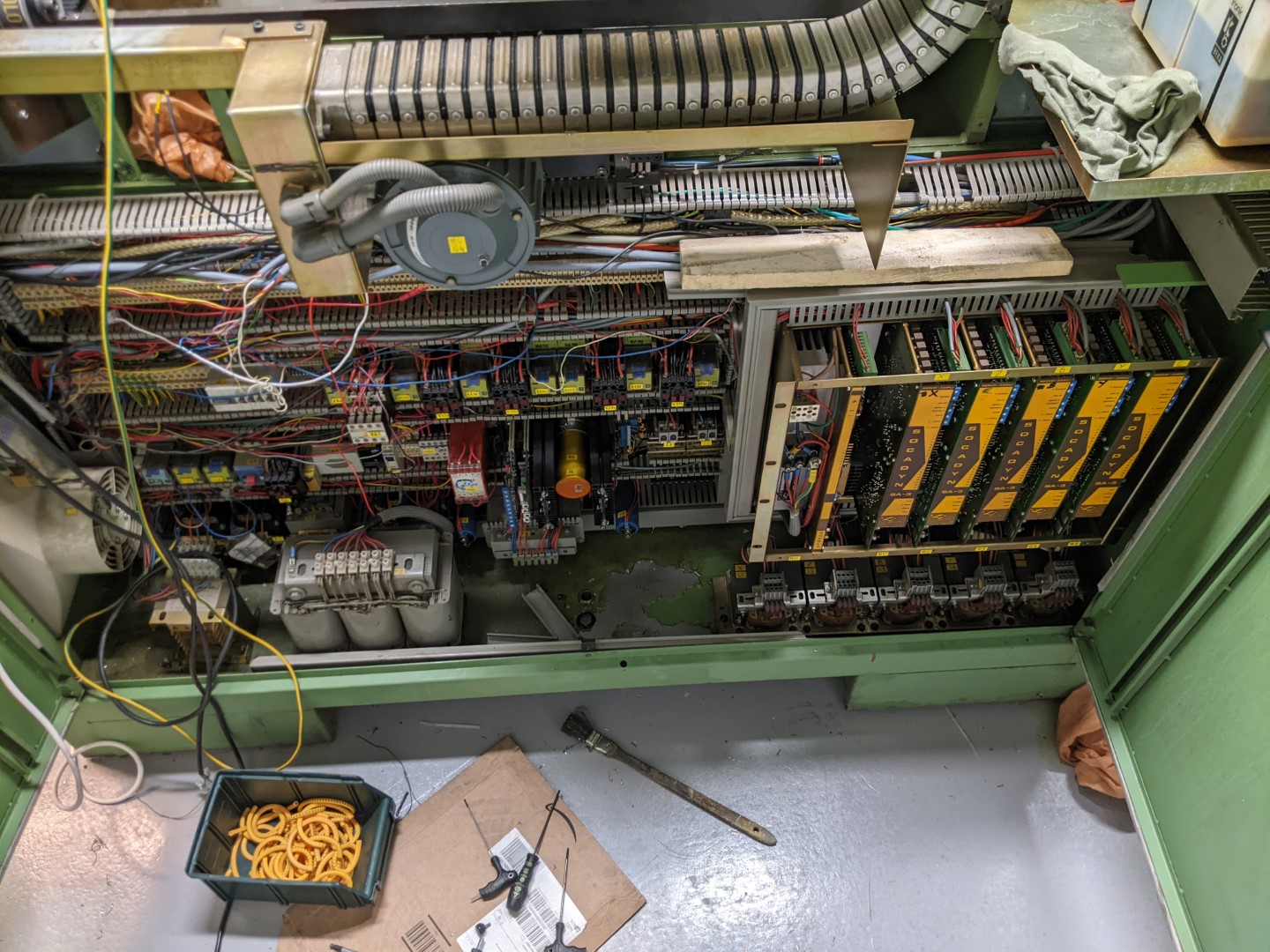

09 Feb 2022 00:53 #234367
by MrK
...and this is what it looks like inside the cabinet.
SOCADYN SA-3 servo amplifiers.
Anyone who has any kind of documentation for these drivers?
I suspect one of them is damaged. I can only move the B-axis (head tilt) in one direction. I have to move it in the other direction by hand. My guess is that it maybe (?) is one leg of the H-bridge that is damaged.
I suppose I really should replace the electrolytic capacitors. Both in servo drivers and other places.
/MrK
/MrK

10 Feb 2022 16:47 #234492
by billykid
Replied by billykid on topic Retrofitting 5 axis Willemin W400 with LinuxCNC
Hello
a friend of mine bought a willemin identical to yours. there is no documentation of those drives, we have repaired one that crashed due to high current. but it's not a mosfet or igbt or bjt drive but a scr! 3 scr double semikron ... we found one defective and as soon as it was replaced it started working fine again.
to tell the truth it doesn't seem like this to me, you can try to see if the analog command voltage arrives.
if my friend still has pictures of the open drive I post them.

11 Feb 2022 07:35 #234554
by MrK
Ok, so it is an SCR drive. Same but different... I am pretty sure the analog voltage arrives because I can drive it in one direction but it could be that this is the case. It could off course also be that the analog command is getting there but the analog drive is corupting the negative portion due to some error.
Base don experience my guess is that it is either a bad soldering, a capacitor or a driver transistor/SCR. Will find out when I open it up... (I hope...)
Is your friend using the NUM-control or converting it? Any other findings from this machine? Would be great if you could get your friend to pay a visit to this thread.
/MrK

11 Feb 2022 12:53 #234567
by billykid
My friend got the original numerical control working for now but wanted to change it later with mesa cards. I asked him if he can find the photos but it's been at least four years that will be difficult. we do not live very close, the drive was in current limitation we tried to lubricate guides but it was not a mechanical problem ... so we swapped the drive with another and the defect passed to the other axis. after a few days he decided to open it and he sent me the photos, I told him the measures to do and he found a shorted scr. he ordered and assembled it by himself. less than a month ago my phone died irremediably and with it the photos. I would try the reference if it is right then if you open it and post the photos I will gladly help you. for my friend it's a very busy time he doesn't want distractions. sorry for bad english i use translator. regards Mauro
