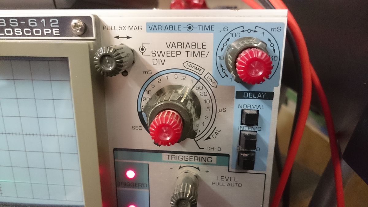

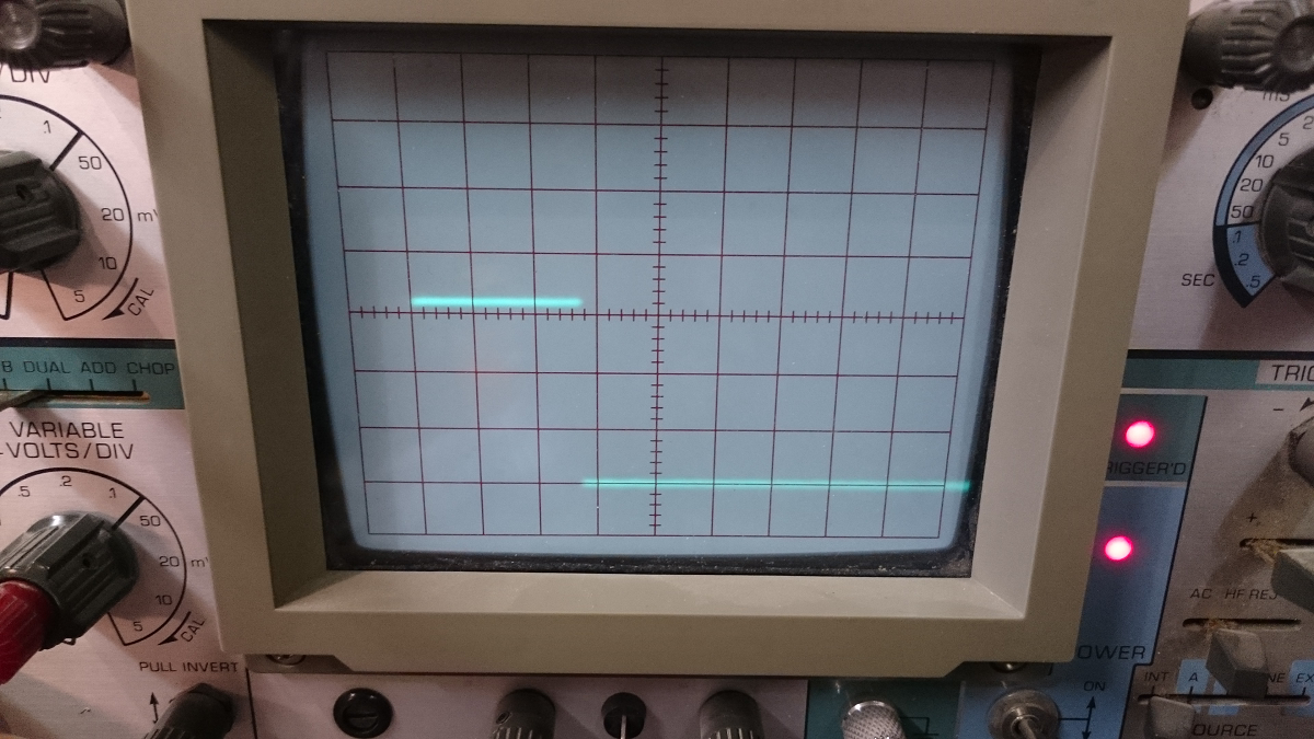

25 Apr 2017 16:20 #92072
by tecno
Replied by tecno on topic Mach3 XML and Stepconfig issues.
- tecno
- Posts: 1850
- Thank you received: 127

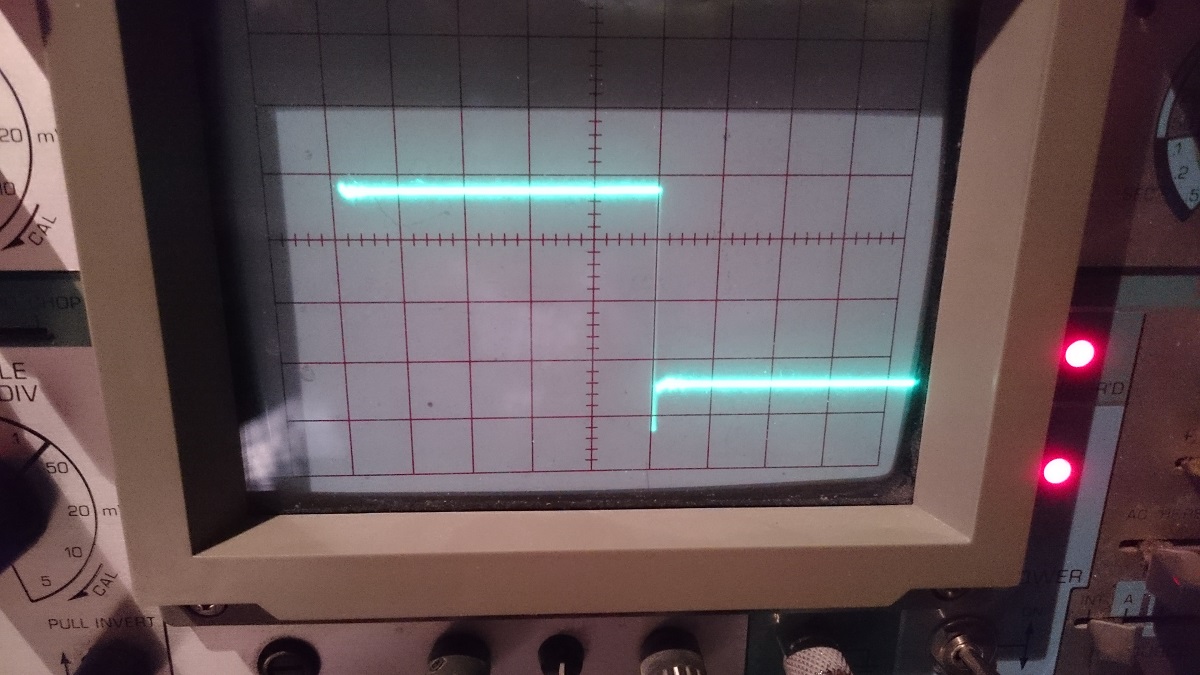

25 Apr 2017 16:33 #92075
by tecno
Above is with 250000 steplen so it figures, but shorter and spindle will not start.
Will go down after dinner and test stepping down until there is no spindle starting.
Tested with 2500 and nothing
Obviously I am missing something here

25 Apr 2017 17:23 #92084
by tecno
Testing in 0,0,0
Now I have set steplen to 5000 and I can start spindle BUT it takes for ever about 35 to push the plus sign before spindle starts. Scope says 30mikro s and not 5.
Now also I have smooth spindle rotation.
How to get spindle starting earlier and why not working in MDI?
