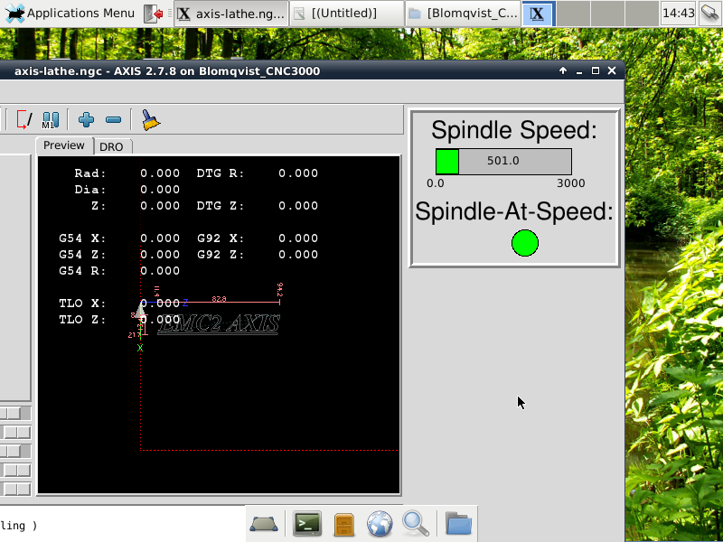

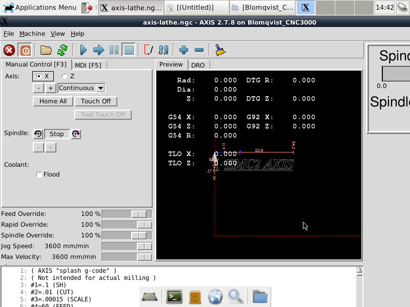

Will do some setup tomorrow now that we have it working, some tweaking still to do get the scale correct so commanded speed will be correct.
Where can I find information on how to get LCNC screen to be scaled to 800x600 and get the Spindle at Speed small window fully visible as well as LCNC screen?

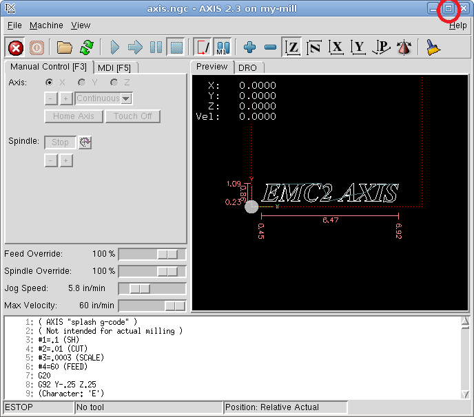

26 Apr 2017 12:08 #92135
Replied by andypugh on topic Mach3 XML and Stepconfig issues.
What happens if you press the "maximise" button?
There is a program called "devilspie" that I have never used but have seen mentioned in this sort of context.
- tecno
- Posts: 1850
- Thank you received: 127
26 Apr 2017 12:13 #92136
by tecno
Replied by tecno on topic Mach3 XML and Stepconfig issues.
"maximise" button?
Where can this be found?
- Posts: 19896
- Thank you received: 4648
26 Apr 2017 12:30 #92137

- Todd Zuercher
- Posts: 4781
- Thank you received: 1471
26 Apr 2017 13:02 #92141
Replied by Todd Zuercher on topic Mach3 XML and Stepconfig issues.
Andy, unfortunately I don't think that is going to help him. I'm afraid Axis with a pyvcp add on does not fit on his maximum 800x600 screen resolution.
You can use one of the lower resolution user interfaces such as TKlinuxcnc, or Mini. Also, I think Gaxis_no_plot might fit, but I'm not sure how functional it is.
