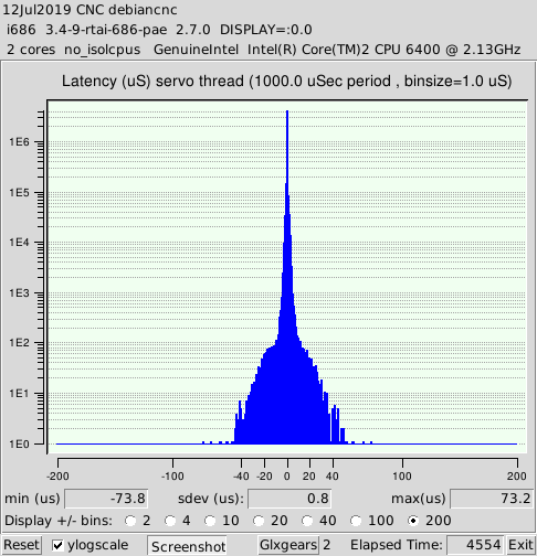

I did it before I bought the Mesa cards to know if the purchase was worth it. However I just executed the command as you say, like the normal latency test, I understand that I will have to abuse the system even if the computer is only destined to LinuxCNC.
The only thing I can not do is surf the web, I do not have internet in the workshop.
The motherboard is a Gigabyte Ga-945P-S3 with integrated audio and video (currently disabled) I say it because I do not know if removing the graphics card and audio and activate the integrated ones could solve something.
I have not found anything similar to what you mention in all my BIOS.

Replied by PCW on topic moving problem
On a 945 , I would use the on-board video
Getting a real time error with just a 1 ms servo thread means something fairly
major is wrong with the host CPU system
What OS and LinuxCNC version are you running?

I´m running a Debian Wheezy 2.7 version on a Intel Core 2 CPU 6400@ 2.13 Ghz with 3 Gb of RAM. Here you have the test results.

The realtime delay error appears if I run linuxCNC and shake the window
