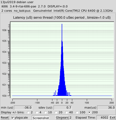

13 Jul 2019 15:16 #139258
by RoberCNC
Replied by RoberCNC on topic moving problem
Hello, it seems that finally there is good news. I mounted an old hard drive and graphics that I had out there and executed the LiveCD and the Realtime Delay error seems to have disappeared. I have also run the latency test again that you said PCW and the results are notoriously better (attached). Regarding the movement of the stepper (I only have the X connected) I have reviewed all the wiring and the manual of the 7i76 and there were a couple of things wrong, once I have corrected my failures with movement symptoms !!! It is poor and erratic but it moves at least, it makes a noise like a submachine gun and it does not correspond to the 5mms that I order from far away, but I consider it a breakthrough.
Now my question is whether to try the old graphics with the HD that I had before or if I put it aside and install the OS as it is and start from there, as you can see?

13 Jul 2019 15:38 #139259
Replied by tommylight on topic moving problem
Nice !
Leave it as is and install, then we can deal with moving those motors smoothly .
