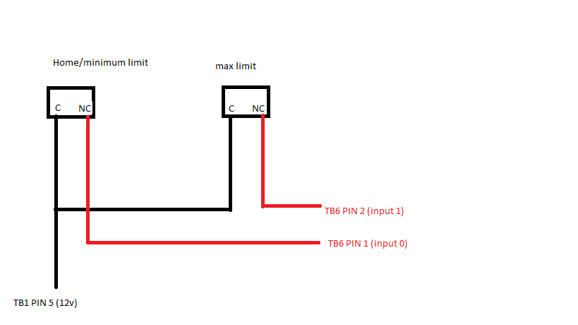

01 Aug 2019 08:09 #141078
by RoberCNC
Replied by RoberCNC on topic moving problem
good morning to everybody!
I've finally installed the precision ballscrews and now all the axes are really fine. My new task is to install all the limits, I have an idea to configure them as NC, if I understand well with what I have read here I must join the GND to the common (my card is a 7i76, not E or D) and the NC to the pin input that I configure.
Is this correct or should I deny the pin? Maybe it's easier to put them as NO? Let's see what you can tell me guys, thanks.

- RoberCNC
- Posts: 230
- Thank you received: 25
01 Aug 2019 15:02 - 01 Aug 2019 15:03 #141112
by RoberCNC
But i must wire voltage or ground? I should use diferent inputs for each limits and + - , i have imputa enough

- Posts: 21779
- Thank you received: 7443
01 Aug 2019 15:28 #141118
Replied by tommylight on topic moving problem
So i do not have to read everything again, what board are you using?
Or is it directly to parallel port ?
For parallel port you need to wire one pin of the switch to the input of parallel port and the other to the ground. You can use NO or NC as you can change that in hal.
- Posts: 18004
- Thank you received: 5289
01 Aug 2019 15:37 #141119
Replied by PCW on topic moving problem
For a 7I76, the switch common is field power (normally 12 or 24V)
NC switches are recommended so a broken wire causes a fault
When NC switches are used with a a 7I76, you will need to use the -not hal pins
The following user(s) said Thank You: tommylight, RoberCNC
- RoberCNC
- Posts: 230
01 Aug 2019 15:53 #141120
by RoberCNC
Thanks a lot PCW, you mean something like the attachment for each axis, then edit the hal file and add -not
