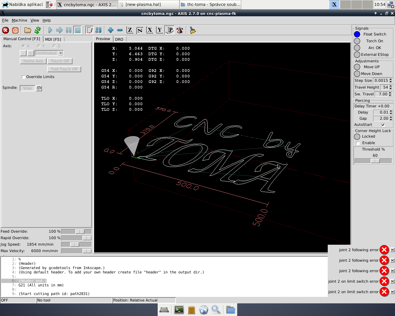

Hello,
i build the plasma router 1m x 1m. I used LinuxCNC 2.7. and THC by Proma. On webpage Proma is simple config for LinuxCNC.
I used this config and modified the parallel port settings for my machine.
On axis Z i have float_switch and if i ON this switch, then on screen is error - "joint 2 flolowing error"
Can you please some help me, what is the problem ?
Many thanks !

hi
quite a distorting file setup
but its ok
it coudt be all in 2 files
why are the
Zaxis scale 320 steps per mm the driver wont make it at 400mm/sec thats 160000steps per second no way to folow
a plasma Z shoudt have no more then 100 even less 0.01mm on THC is pretty low and you use 0.003mm 3times
you messet up on
setp stepgen.2.dirhold 45000
setp stepgen.2.dirsetup 45000
setp stepgen.2.maxaccel [AXIS_2]STEPGEN_MAXACCEL
but its ok
why are the
you messet up on

21 Jul 2019 15:29 #140112
Replied by tommylight on topic Linuxcnc - plasma router - joint 2 flolowing error
Have a read through howto and thc.hal file, everything is explained there.
For the float switch you already have two lines in thc.hal, just omit one and use the other.

31 Jul 2019 12:04 #141016
by kofaki
Replied by kofaki on topic Linuxcnc - plasma router - joint 2 flolowing error
Hello Tomy,
i changed the config from Grotius (i found it in post forum.linuxcnc.org/plasma-laser/34978-th...-with-how-to?start=0) and this is the error :
What is please wrong ?
Debug file information:
./stepper.hal:45: Pin 'joint.0.motor-pos-cmd' does not exist
5793
PID TTY STAT TIME COMMAND
Stopping realtime threads
Unloading hal componentsWhat is please wrong ?
- Posts: 22027
- Thank you received: 7502
31 Jul 2019 13:33 #141026
What version of Linuxcnc are you using ?
That config is for 2.8 or 2.9, it will not work with 2.7 as it has joint/axis info in it.

aahhh, thank you, yeah, i use now 2.7. I upgrade it to 2.8
