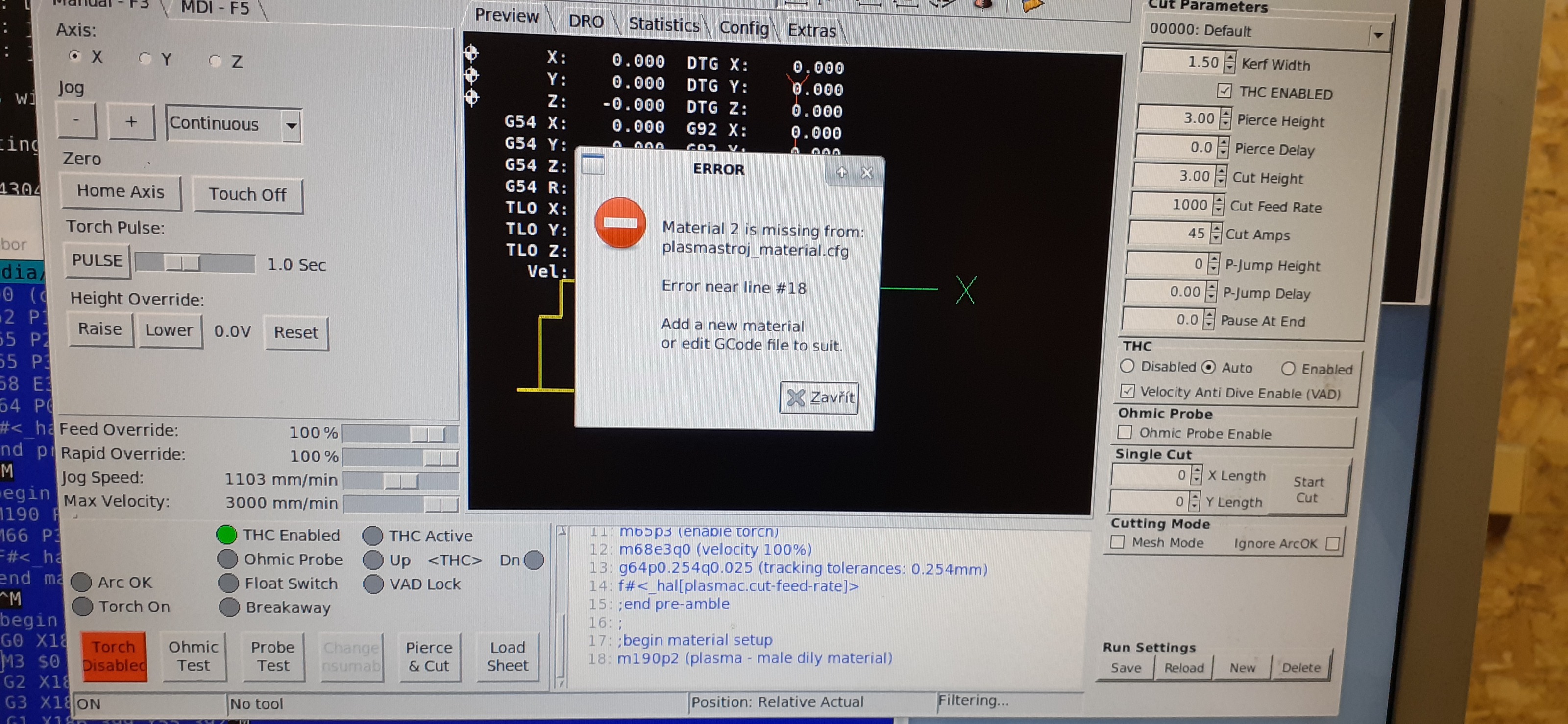

Hi Tommy, you are best !! . It seems, that THC works !!!. I am very happy ....
Now .... i am newbie user of Sheetcam. I use this post for PlasmaC (github.com/DenkBrettl/plasmac_sheetcam_postprocessor)
So, i created some G-Code and now i try upload this to LinuxCNC and i have this error.

Replied by rodw on topic Linuxcnc - plasma router - joint 2 flolowing error
Why wouldn't you use the post processor from the author of Plasmac?
forum.linuxcnc.org/plasmac/38438-plasmac-post-processors

Replied by kofaki on topic Linuxcnc - plasma router - joint 2 flolowing error
i don't know,,,,but i try it
......thank you Rodw
Ok, sheetcam is fine, now i have still problem with torch height.
If i cut some small holes, then i have the error " Valid Arc Lost" or "Float Switch Activated Program Paused"
I think, that if i try cutting through small steel plate (thick 2mm), then the problem is more frequent, because the steel still bended.
Maybe some bad settings .....i tried change the 'cut height' from 2 - 4 mm and 'feed rate' from 200 - 2000 mm/min.
If i tried cut for example "STAR" into big steel plate (thick 3 mm), then all is OK.
My last question is : the PROMA THC is set now for 162V. This voltage must be changed for different thick of steel plate or is the stable one value ?
Many thanks,

Replied by razplaz on topic Linuxcnc - plasma router - joint 2 flolowing error
"My last question is : the PROMA THC is set now for 162V. This voltage must be changed for different thick of steel plate or is the stable one value ?"
Hi, on my Proma SD I change the voltage settings for different thicknesses of steel. For mine with Hypertherm Powermax 45XP using 50:1 voltage divider; 99v for 11 ga, 103v for 7 ga, 105v for 1/4", 110v for 1/2".
