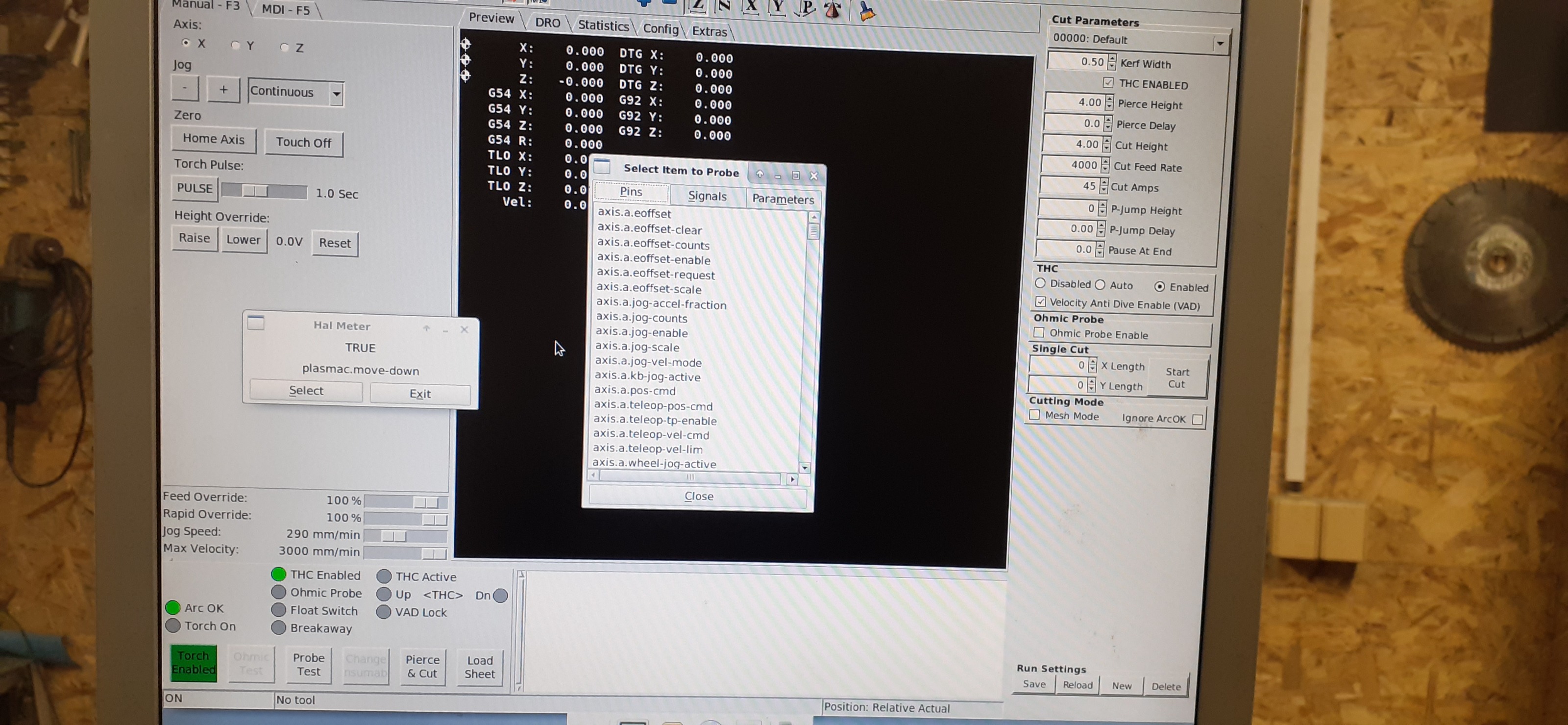

Hi all,
i replaced the my bread board to 5-axis chinesse board and moving of all axis works perfect, the Z float switch too. Now i want use PROMA THC .... i set it and now try the test of function of THC. The signals UP/DOWN works in Hal meter ...but the moving of axis Z nothing.
Can you please help me ?

Did you set PlasmaC to Mode 2 ?
Uploading the config folder might help, so on the "config" tab click on "backup" and upload the resulting file.

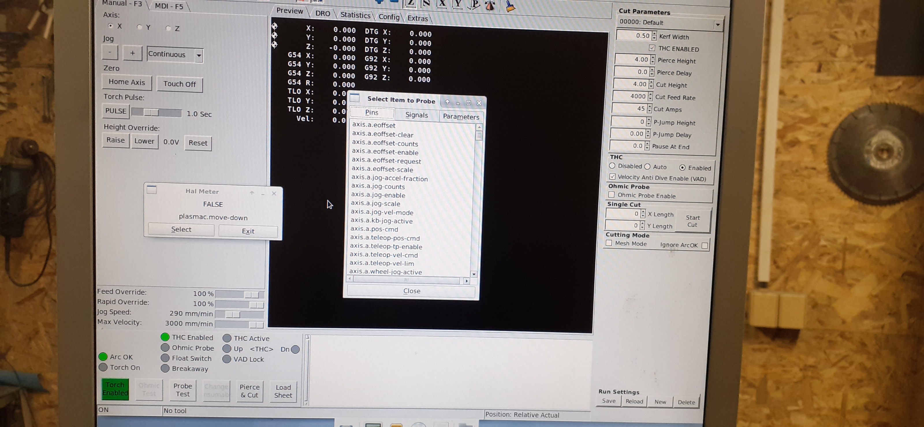

Z axis won't move up or down unless you are cutting.
If you want to check if the up/down signals are getting from the Proma to plasmac then watch the following two pins:
plasmac.move_up
plasmac.move_down
plasmac.move_up
plasmac.move_down

Thanks, Phillc54 , yes, that works (both signals works in test mode of PROMA)

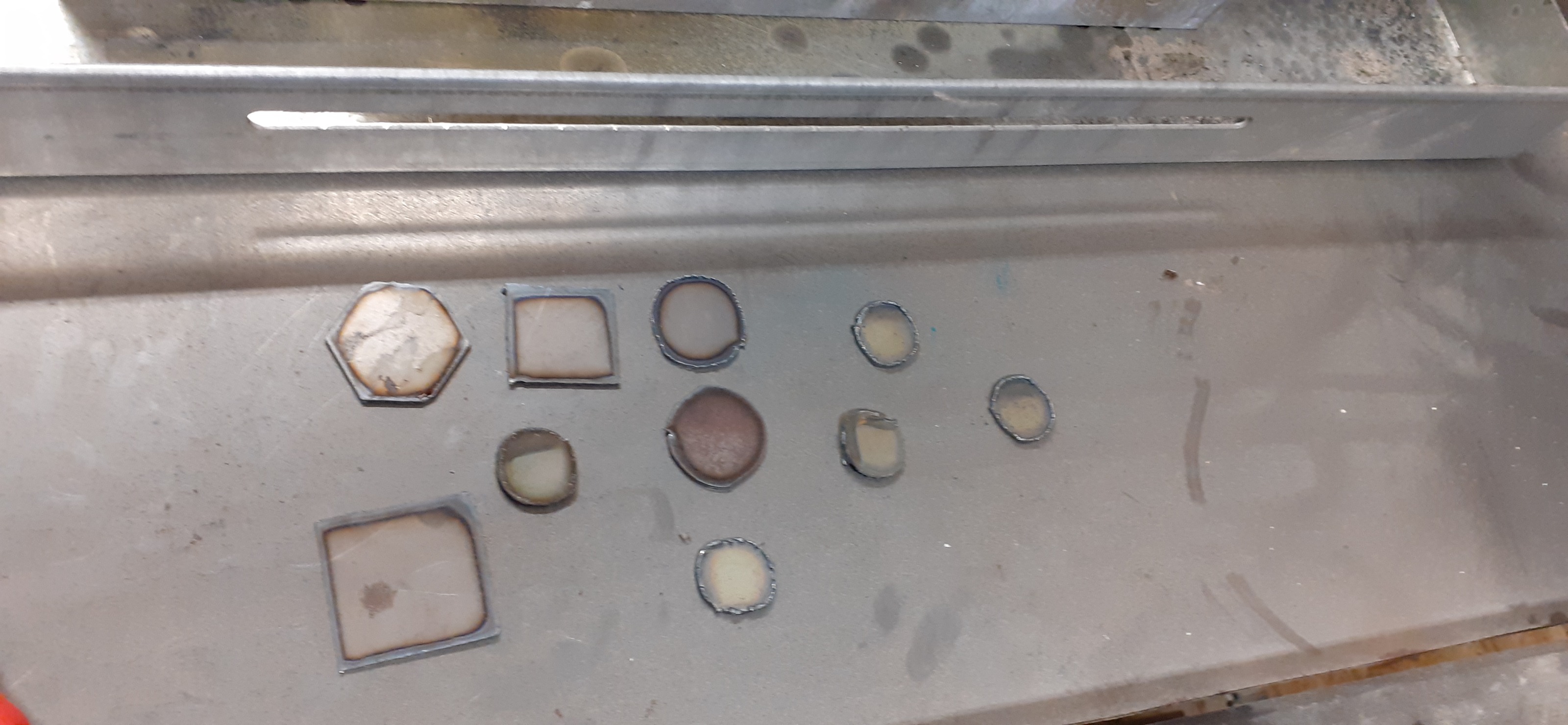

1) i tried set the PROMA THC voltage, but the voltage is very float (from 144 - 200V). If use 1mm think steel plate, then voltage is 162 - 164 V.
I set this voltage (163 V) to PROMA and start cutting ... "VAD lock" is active many times .... sometimes I see THC moving up or down ... and in many cases I have an error "program paused - float switch is active "or" ARC is not valid "..... only sometimes is the cut completed
In PROMA i have HYS 4V (+-2V), DELAY 0.5 and High voltage 200V.
2) i bought the Sheetcam software + post processor "EMC Plasma" , but in LinuxCNC i have problem with upload code (errors on line 6 and 11), what is please wrong ?
3) if i cut the square, than the dimensions of this are OK, but if i try cut circle, then the dimensions are very bad. What is wrong ?

N0110 Z3.00003) if i cut the square, than the dimensions of this are OK, but if i try cut circle, then the dimensions are very bad. What is wrong ?
