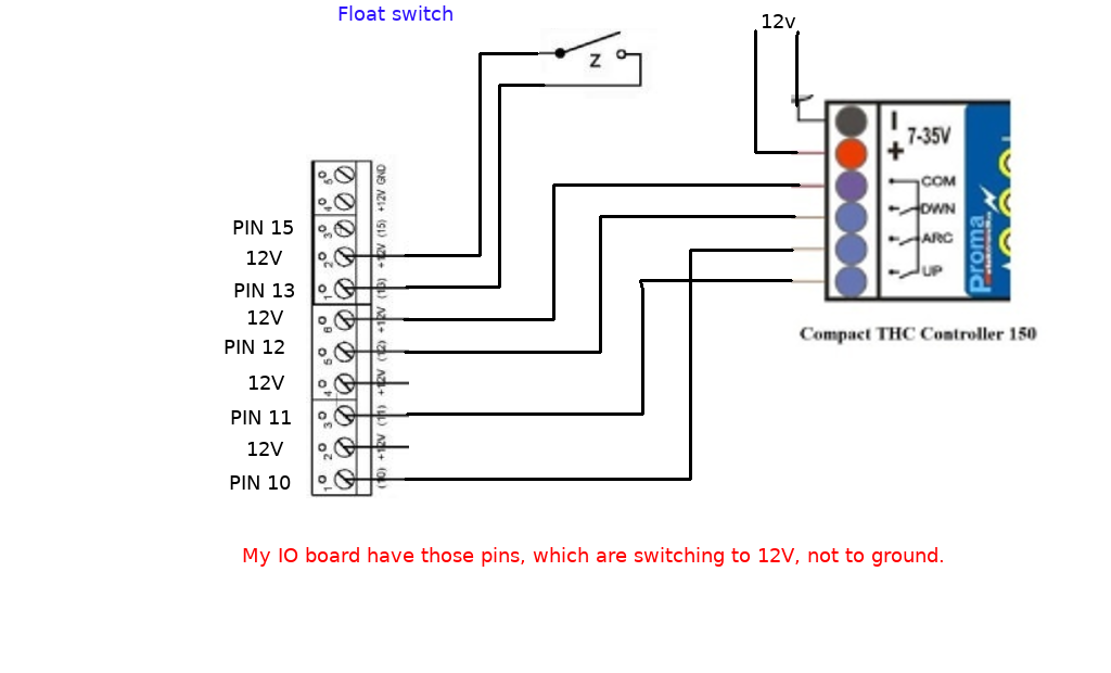

No, i want to use only the float switch ...it is connected to parport pin 13 .
I tried new config, please check this ...
here is IO.hal
here is IO.hal
net MoveDown parport.0.pin-10-in => or2.0.in0
#net MoveDown parport.0.pin-10-in-not => or2.0.in0
net MoveUp parport.0.pin-11-in => or2.0.in1 mux2.1.sel
#net MoveUp parport.0.pin-11-in-not => or2.0.in1 mux2.1.sel
# Change the pins to corespond to Z-Home limit swith and ARCOK input from THC or BOB
# For negative inputs use the omited part
net FloatSwitch parport.0.pin-13-in-not => or2.1.in1 and2.4.in0 and2.5.in1 and2.6.in1
#net FloatSwitch parport.0.pin-13-in => or2.1.in1 and2.4.in0 and2.5.in1 and2.6.in1
net ArcOK parport.0.pin-12-in => or2.4.in1 xor2.1.in1 oneshot.2.in
#net ArcOK parport.0.pin-12-in-not => or2.4.in1 xor2.1.in1 oneshot.2.in
net TorchOn => and2.3.out parport.0.pin-01-out oneshot.1.in not.2.in

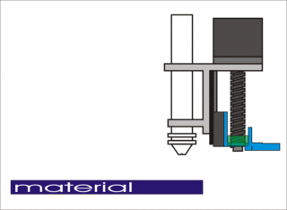

Ok, i mistake, i don't write, that is the Z limit, because i want to use the float switch to detect the material.
Maybe this is not understanding.
- kofaki
- Posts: 31
30 Oct 2019 20:07 #149211
by kofaki
Replied by kofaki on topic Linuxcnc - plasma router - joint 2 flolowing error
i thinked, that the Z limit switches = End switches. And the float switch is other function
... sorry.

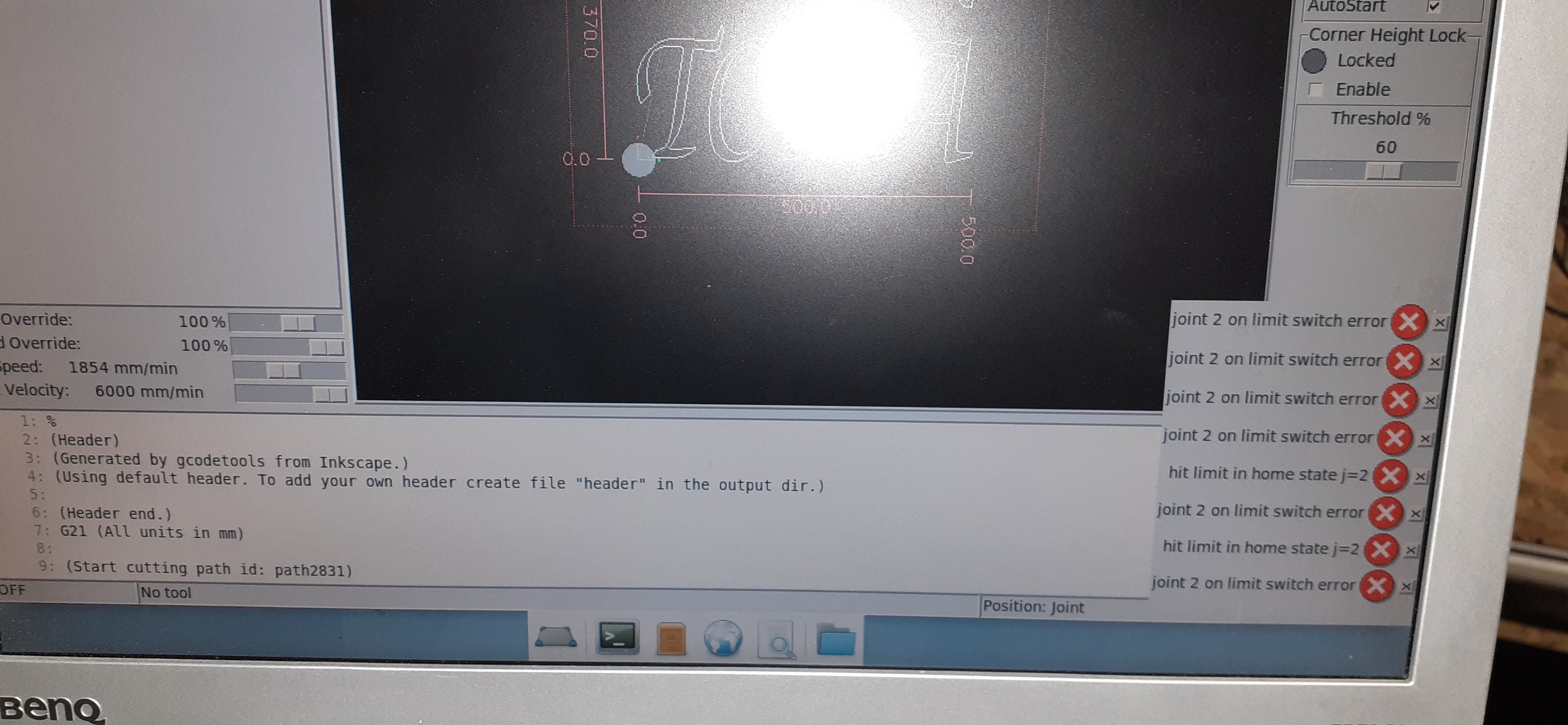

yes, i start from beginning, use now the same config from your thc_toma, i edit only motor configuration in thc_toma.ini ( scale ) .
> join 2 on limit switch error

27 Jan 2021 16:07 #196776
by kofaki
Hello all,
i closed my plasma cutter project in year 2019 and now i want to open it and finish.
I reinstalled PC with "LinuxCNC 2.8.0 Debian 10 Buster PREEMPT-RT ISO" and then i use the toma-thc config.
I have still "joint 2 flolowing error" (i tested both variant :
Next, if i disable the Float switch in config, then i can start the machine and all axis (x,y,z) works fine.

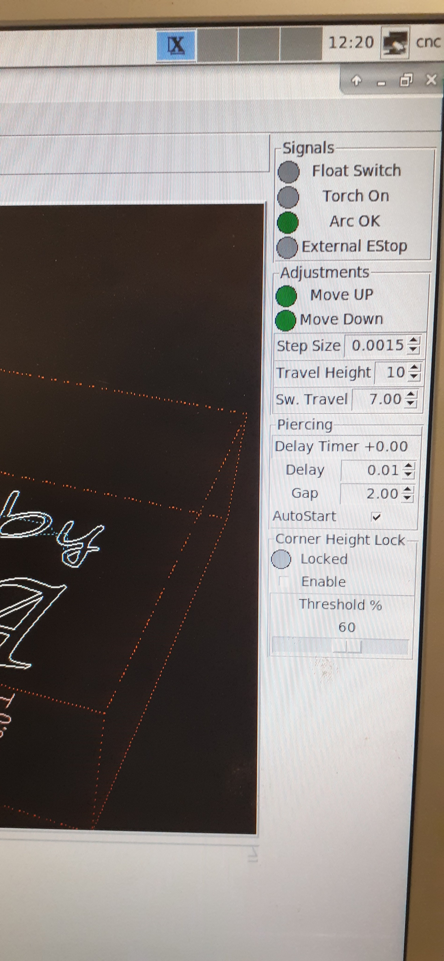

I tried TEST on PROMA 150 and in LinuxCNC the first light indicator was green ARC OK. In the second step, if the THC tests go to "MOVE UP", then the green "MOVE UP" light will be in LinuxCNC. It looks fine, but this light will be solid green permanently. The THC test goes to "MOVE DOWN" in the next step and the light in LinuxCNC will be green and then will be too steady green.
The axis Z does not move in test of THC, nothing move. no error.
Ok, can you please some check my config ?
Many thanks,
