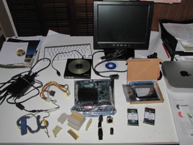

Hi gera229:
Here's some links straight to three images on Flickr - these are the original size. I was in too much of a hurry to post them here (not having uploaded things here before).
1. Front panel header with ATX switch lead plugged in. Standby power LED is lit (although camera flash obscures this a bit)
www.flickr.com/photos/alex1n/7446800986/sizes/o/in/photostream ;
2. The Mini-Box Pico150 (150W) 24+4-pin PSU plugged into the D525MW's ATX socket; "P4" connector likewise plugged into the CPU's power socket
www.flickr.com/photos/alex1n/7446802880/sizes/o/in/photostream/ ;
3. General overview
www.flickr.com/photos/alex1n/7446804968/sizes/o/in/photostream/ .
Note that the SSD and the memory have been disconnected in these snaps, but were installed during failed attempts to get the board cranked up.
I'm currently reading the board's manual *gasp*
Another couple of notes: the three-pin CPU fan taken from the old machine (a PII chip) runs when the power is connected; an LED from the old machine lights up (steady glow, no flash-sequences) when plugged into the front panel header (pins 1 & 2).
3. General overview

26 Jun 2012 10:31 #21344
Replied by andypugh on topic Re:PC hardware to run LinxCNC
AlexN wrote:
I don't think it does any harm. Though I was starting my board by touching the pins with a screwdriver for a few days.Presumably shorting pins 6 & 8 with a shunt is right out given that the ATX appears to be a momentary on type.
The topic has been locked.
- Posts: 23377
- Thank you received: 4966
26 Jun 2012 10:32 #21345
AlexN wrote:
Ah, that seems to indicate that the MB is powering up now.
Still nothing at all on the monitor?
- AlexN
- Posts: 59
26 Jun 2012 10:45 #21347
by AlexN
Replied by AlexN on topic Re:PC hardware to run LinxCNC
Nothing at all. Not a flicker from it, and I know that the monitor works, I tired it out on the G5 PowerPC. *scratches head*
- AlexN
- Posts: 59
26 Jun 2012 10:46 #21348
by AlexN
Maybe the video circuit is kaput?
