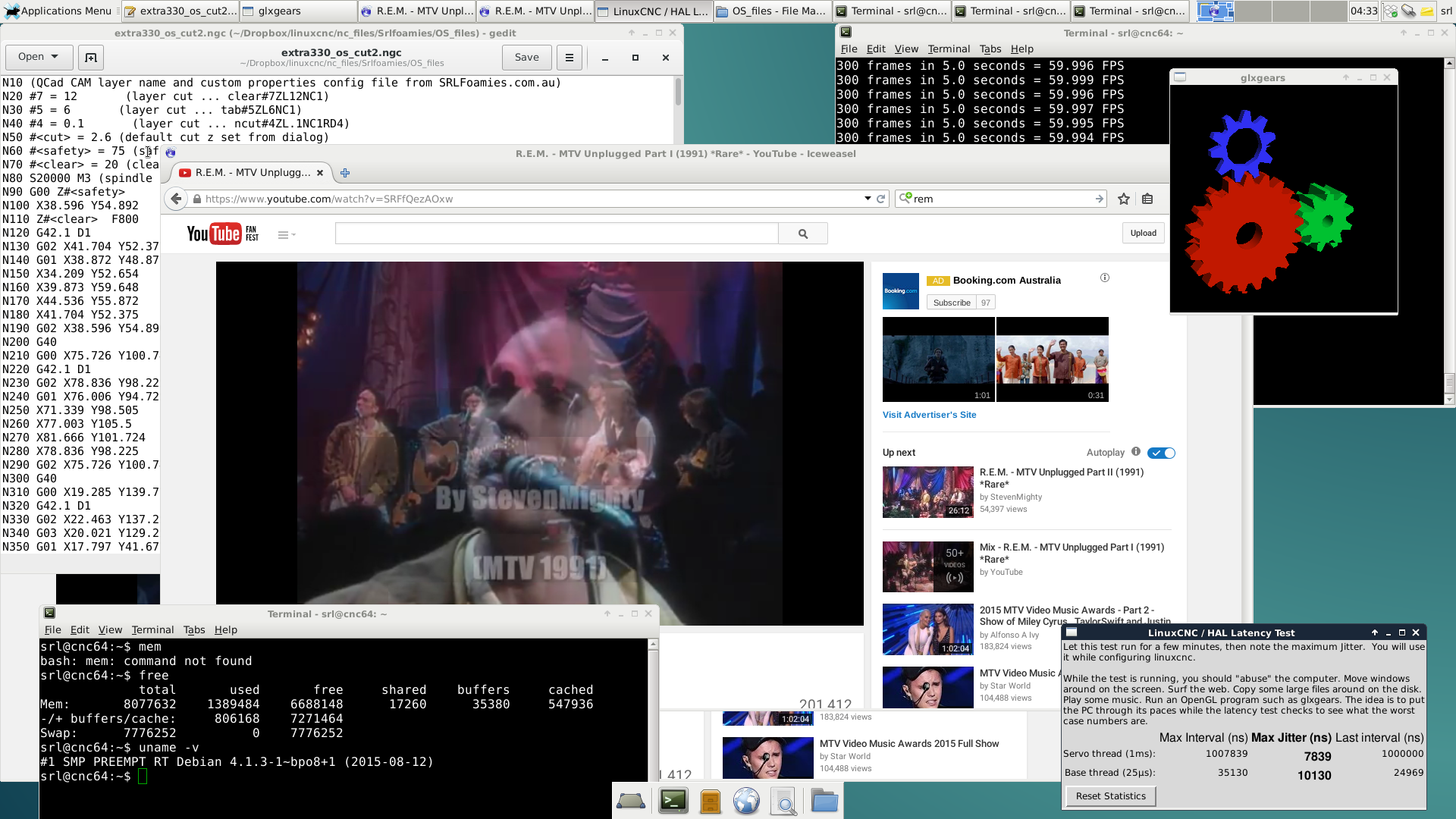

That was after a full screen youtube with no bios changes. I've used it many times for milling and it works fine. Twice I had it pause during a 40 minute job I think due to the screen saver but it resumed without missing a beat.
I wouldn't watch full screen youtubes while a job was running.

Just bought one of these: www.gigabyte.com.au/products/product-page.aspx?pid=5017#ov to run my machine along with 8Gb DDR3 1600MHz memory and a Pentium G3260 LGA1150 3.30GHz CPU. I'll report back when I get everything installed.

All installed with the latest debian iso (2.7). bios tweaked to turn everything off that didn't need to be there and this is the result of the latency test. In this shot this stuff has been running for 8 hours after beating the machine up and going to bed. Best I have EVER had out of a PC for LinuxCNC

I got the same main board too last week from Mwave but I got the 'K' processor for it, the 3258. It has a up to date FC bios so its a rev 2 or 2.1 . I all ready had the 1333 8 gig ram and a Nivia 450gts. Did my first over clock this evening from 3.2 to 4 and got 10000 on Preempt RT 64bit Jessie. Now I can watch youtubes while jobs are running.
