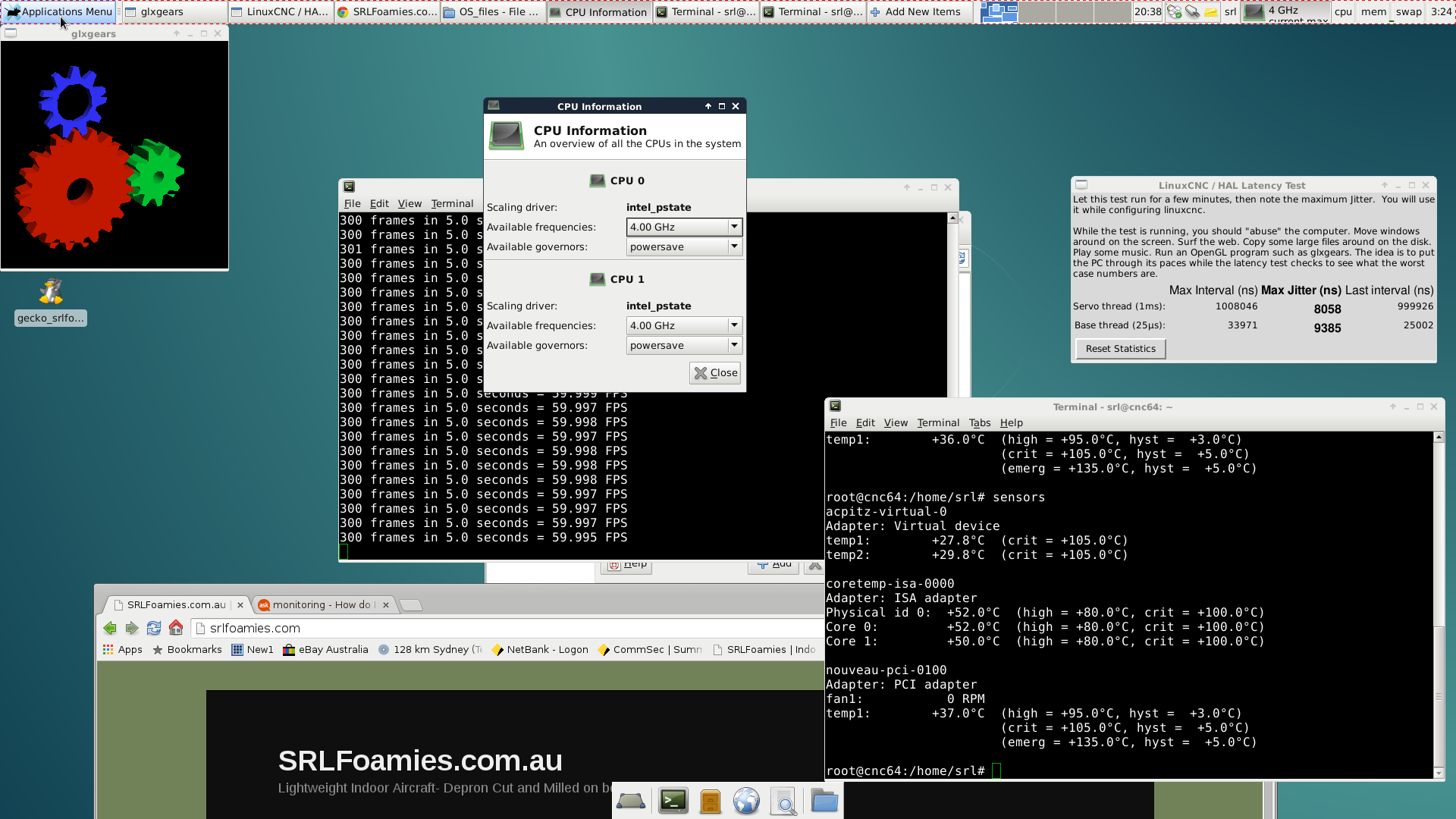

Here is a screenshot with the over-clock information.
It would be nice to put it in one of these.
