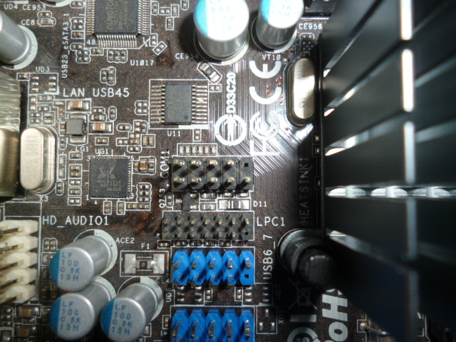

I just received my motherboard shown on LinuxCNC latency-test page: "ASRock E350M1 mini-itx - AMD Dual-Core Zacate E350/E350D APU 1.6GHz" , but I was stunned to see that it hasn't a parallel internal port, but has does a male LPC connector socket, that I have no idea how get the signal to my Router. Guys any help will be welcome and very appreciated.
If you mean it has a female D25 output, lots of boards including Mesa do, it is safer, just get a gender changer

Thank you ArcEye, I'll upload a picture later because is a bit difficult to me explain what kind of connector it is (LPC non LPT)
I saw the LinuxCNC latency motherboard list and I trusted thinking it had the port for parallel.
That seems to be a serial port header. The specification makes no mention of a parallel port :(
www.asrock.com/mb/AMD/E350M1USB3/?cat=Specifications
The PCI slots eems to be a PCI-e x16 rather than a conventional PCI slot, so I am not sure that a cheap parallel port card is the answer either.

I just checked, and PCI-e parallel port cards exist:
www.ebay.it/itm/Sienoc-1xPorta-PCI-E-a-D...?hash=item4d31ff7a1e
Despite the fact that it is a long 16x sot, the short 1x cards ought to work:
it.wikipedia.org/wiki/PCI_Express
A large proportion of LinuxCNC users do not use the parallel port, so that might explain why the board had good latency numbers but no mention of the lack of p-port.
Incidentally, instead of the Parallel port card, you could consider a Mesa card, though those are quite a lot more expensive.
eusurplus.com/index.php?route=product/pr...63_291&product_id=54

This is the LPC internal port: imgur.com/jjJ7OOq
Explain me please how I can post a picture... :(
30 Sep 2015 22:27 #63274 by ArcEye
Replied by ArcEye on topic Intel cpu on board motherboard suggestion
Not what I was expecting, it only has 13 pins :(
In theory you should be able to connect to that to create a parallel port:
en.wikipedia.org/wiki/Low_Pin_Count
But in practice I am not sure that you can.
I think it will be simpler to use the PCI-e connector.
