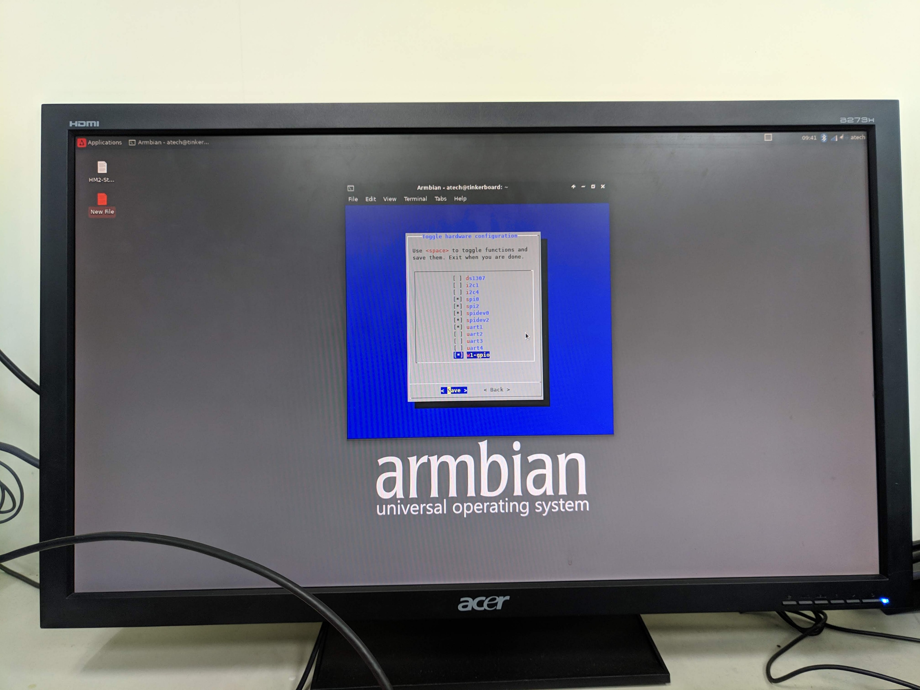

11 Sep 2019 00:11 - 11 Sep 2019 00:23 #144779
by JackyWu
Replied by JackyWu on topic Can Asus Tinker Board run LINUXCNC
I installed LinuxCNC following the guide of (linuxcnc.org/docs/devel/html/code/building-linuxcnc.html)
I had run the "sudo make setuid" when I tried to run "loadrt hm2_spi" yesterday.
The message showed when I ran the "sudo make setuid" were
And I ran "source ../scripts/rip-environment" and "halrun" after that.
Is there anything wrong?
P.S. The SPI function is enabled as the attached image "spi_enable" shown,
