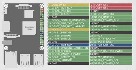

07 Nov 2019 06:36 #149845 by andypugh
Replied by andypugh on topic Can Asus Tinker Board run LINUXCNC
Are you sure that the board is in SPI2 and not SPI0?
Possibly SPI and SPIDEV are mutually exclusive?
07 Nov 2019 20:06 #149898 by terry1992
Replied by terry1992 on topic Can Asus Tinker Board run LINUXCNC
Yes, the 7i90hd card is connect to the spi2 pin of the tinker.( pin19=TX, pin21=RX, pin 23=CLK, pin24=csN0 )
However, I cannot tell if the hm2_tkboard use spi0 or spi2 from the source code.
I connect to spi2 because the author of the driver and the youtube video tell me it use spi2.
I also tried to do the spi communication when the spi2 is turned off and when spi2dev is turned off.(test1 & test2)
test1: spi2 : off spi2dev: on;
test2: spi2 : on spi2dev: off;
Both of the test shows cannot find device.
