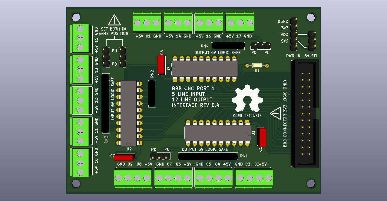

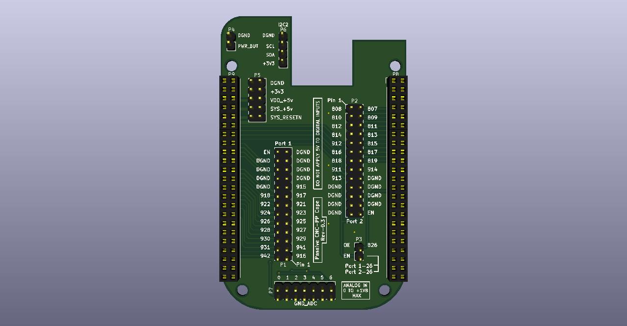

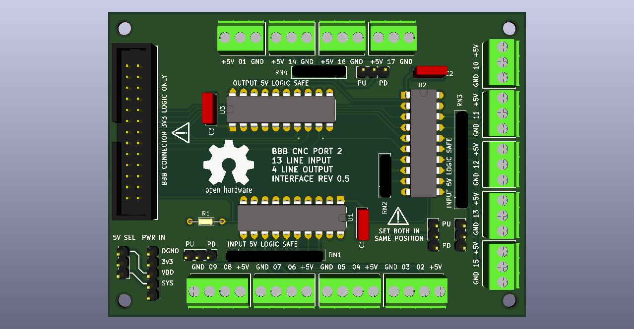

- BeagleBrainz
- Visitor
05 Mar 2020 04:50 - 05 Mar 2020 04:51 #159241
by BeagleBrainz
Replied by BeagleBrainz on topic Raspberry Pi 4
This was my solution:
A cape that fits onto the BBB
Two daughter boards that connect via small ribbon cables.
I was able to bring out 34 lines fro I\O and the 25th to enable the outputs whilst keeping HDMI
I ran this until I switched to Linuxcnc with an ealry wheezy image that was well before things were split
This is my github with more info github.com/ozzyrob/
