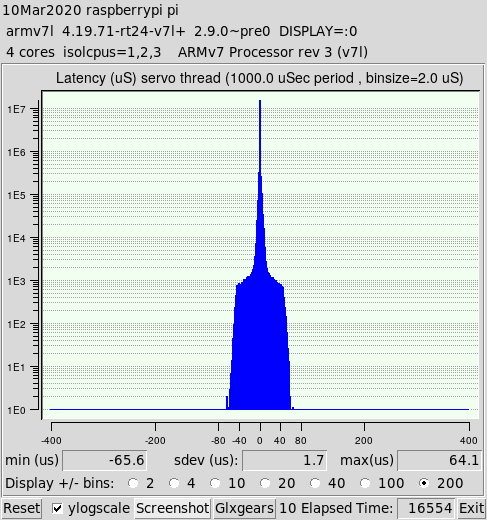

Heres what I get with a servo thread only (about 4 hours):
Replied by PCW on topic Raspberry Pi 4
I just run latency test. Base thread is good, around 50,000.

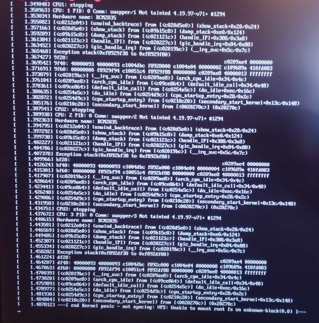

I followed the directions on John Thornton's gnipsel page and got as far as rebooting the rpi4, but it hangs and I get the following message:
---[ end Kernel panic - not syncing: VFS: Unable to mount root fs on unkown-block90,0) ]---
I'm pretty sure I followed the steps to the letter, but I wonder if I didn't leave a space when appending the following to the boot file:
quiet splash lapic noxsave acpi_osi= isolcpus=1,2,3 idle=poll acpi_irq_nobalance noirqbalance vmalloc=32MB clocksource=acpi_pm net.ifnames=0
Is there any way to correct this without starting over?

The /boot directory generally sits on a fat partition and will automatically mount on Windows, Mac and of course Linux. Remove the S.D. card, stick it into an appropriate card reader on another system, and edit the file.

What's the whole content of cmdline.txt ?
It would appear that the kernel is looking for the root filesystem but can not find it to mount.
