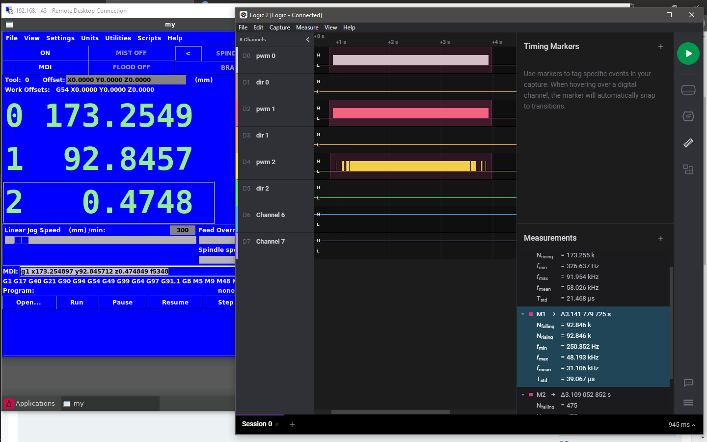

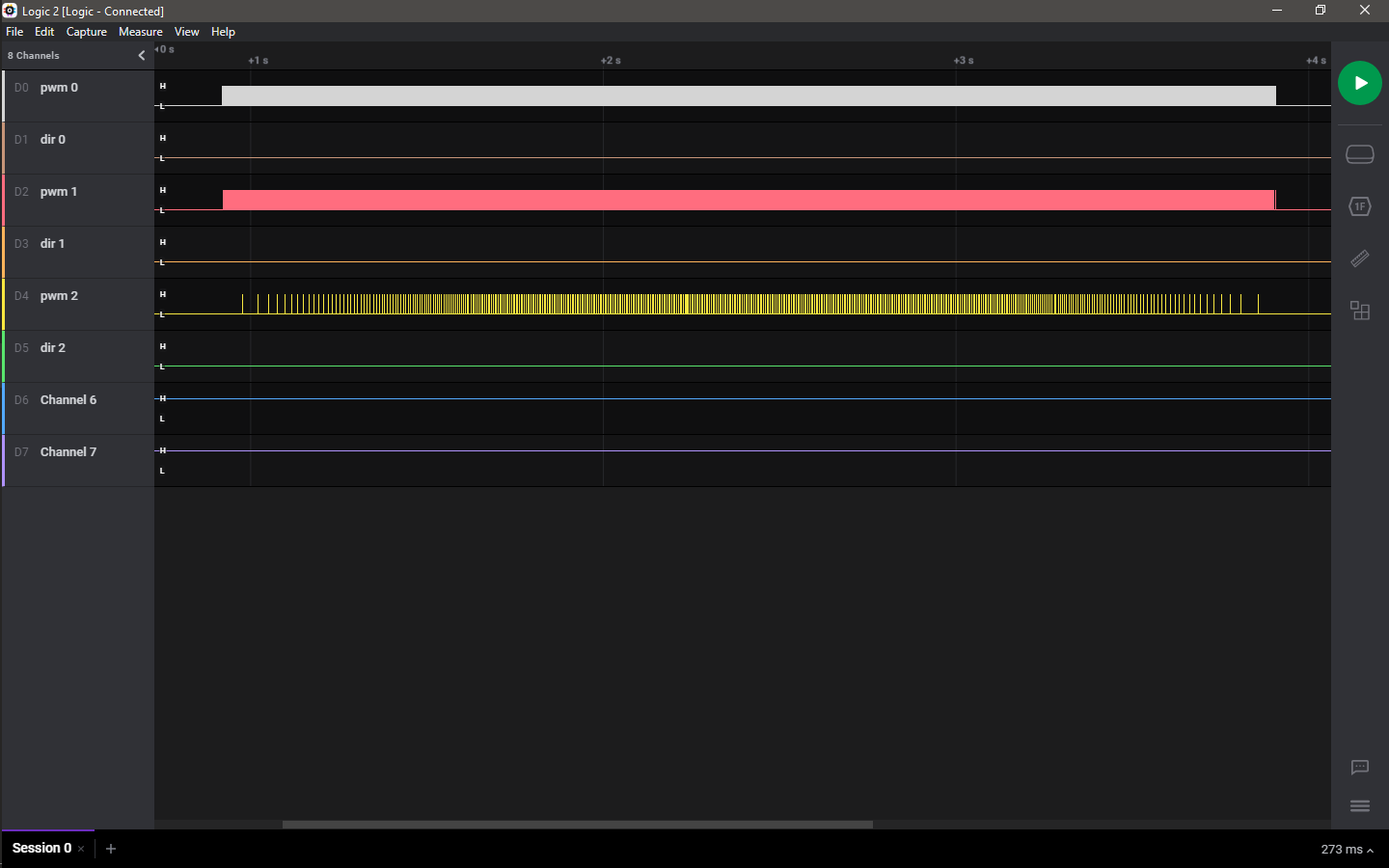

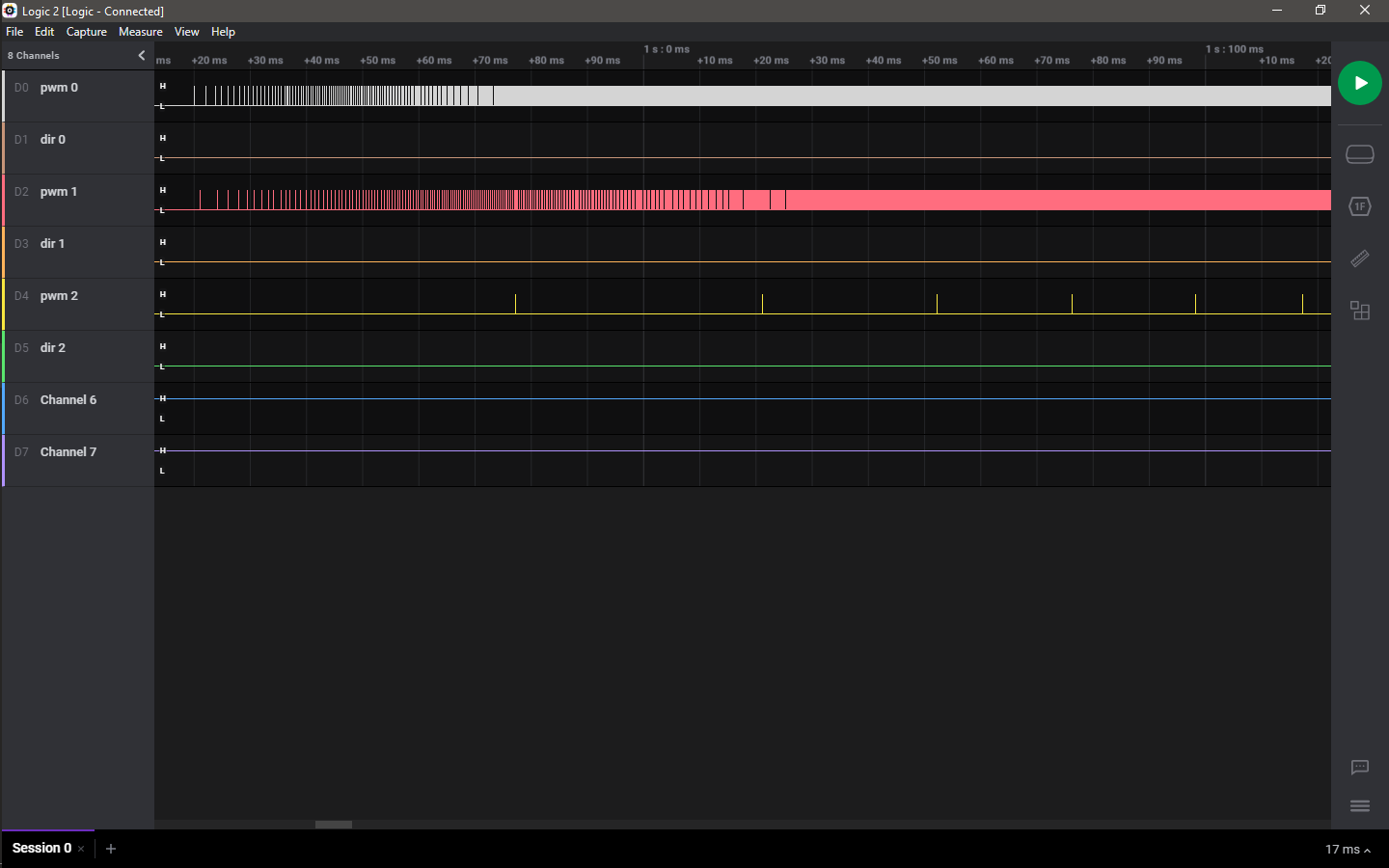

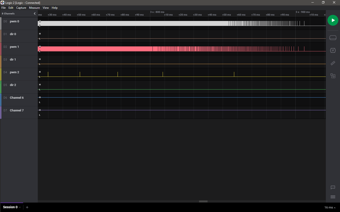

Made a smooth frequency acceleration. Works fine. Position following is nice. Here is an example of logic analyzer's output. Absolutely random movement. 1mm = 1000 steps. See all attached images..
New installer is WIP.
Encoder module is WIP too.
