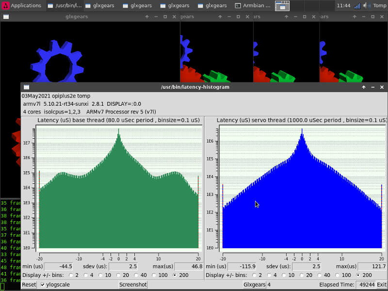

04 May 2021 05:21 - 04 May 2021 05:23 #207790
by tjtr33
Replied by tjtr33 on topic LinuxCNC + Orange Pi
Hi Bari Hi MXMaster
I ran latency-histogram on the opi+2e armbian buster xfce
withadded to command.tct and compiled
params ofand 4 glxgears
and got (after more than 13 hours)
base -44.5 +46.8
servo -115.9 +121.7
the editing for isolcpus and idle definitely help
it does slow down the axis gui, but acceptable
( if you "lower your expectations" TM SNL )
todo:
Add the ntp 'fix' from samco
Move the os from sd to emmc
Drive these closed loop stepperd LC57H380+LCDA357H
www.alibaba.com/product-detail/3-Phase-n...-2N_62339788859.html
Build and study the app 'tuna' for tuning rt environments
Regards
tomp

04 May 2021 06:15 #207793
by Bari
Replied by Bari on topic LinuxCNC + Orange Pi
Tom,
I have similar jitter here. I also tried with isolcpus=2,3 and =3 and GUI performance was snappier and the jitter stayed about the same.
