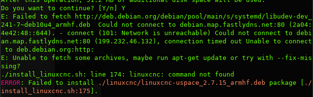

@MX_Master, thanks for sharing this project. I am a high school student. after i saw your posting about orangecnc (orange pi + linuxcnc), i want to build my own cnc too. I use orange pi pc plus in my project.
but, I get the problem in installation part. this is the error that I get. could you help me to solve this problem?
thanks

I had the same problem.
I did „apt update“.
After this installation worked.
I did „apt update“.

i have try this, but still not working
and thanks for your reply

I'd wait for MX and TJT to be done first since the old code doesn't step properly anyway.

I Only got it to work with on an old versions of Armbian, only the version from Mai 2020
On newer versions the keyboard and Mose don’t work. I agree best is to just wait for the new version. Why fix something that is soon going to be obsolete.
