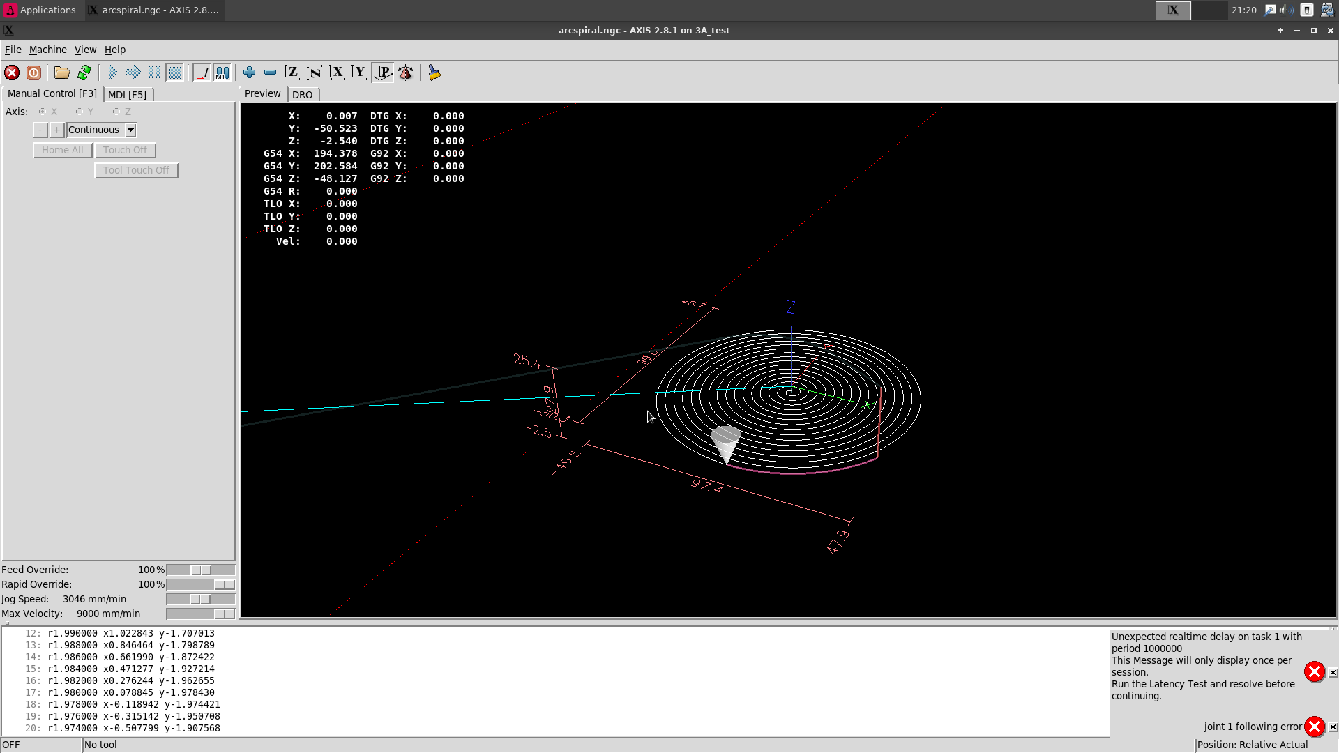

Hey! This is how everything is going util now:
When I try to run a file it stops somewhere with joint following error on one of the axis. Usually it is the axis 1, but not aways. Also, I got this "unexpected realtime delay" message almost everytime I open AXIS. I'm using the default values for PERIOD on my HAL file. I have my files set to reflect my actual machine configuration, like the real travelling size for the axis, home position, and scale according to my screws (25 mm X and Y axis and 20 mm for Z) and 1/32 microsteps. I'm attaching those files.

What does uname -r give for output?
Which board is this on? Which CPU #, core speed and number of cores? How much RAM?
Run the latency test for at least 5-10 minutes and post the scores.

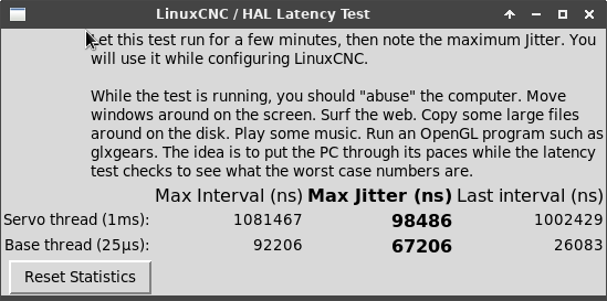

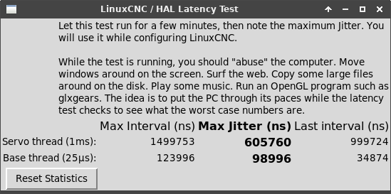

28 Jul 2021 23:14 - 28 Jul 2021 23:53 #216160
by Dolence
It's an Orange Pi PC 1GB RAM H3 Quad Core. I think it's running at 1.37 GHz.
Something very strange hapenned when taking the screenshot. Before the capture the values are as in the first pic, but when saving the file it jumped to a higher value.
Replied by Dolence on topic LinuxCNC + Orange Pi (allwincnc)
orangepipc:~:% uname -r 5.10.21-rt34-sunxiIt's an Orange Pi PC 1GB RAM H3 Quad Core. I think it's running at 1.37 GHz.
orangepipc:~:% cpufreq-info cpufrequtils 008: cpufreq-info (C) Dominik Brodowski 2004-2009 Report errors and bugs to cpufreq@vger.kernel.org, please. analyzing CPU 0: driver: cpufreq-dt CPUs which run at the same hardware frequency: 0 1 2 3 CPUs which need to have their frequency coordinated by software: 0 1 2 3 maximum transition latency: 2.04 ms. hardware limits: 480 MHz - 1.37 GHz available frequency steps: 480 MHz, 648 MHz, 816 MHz, 960 MHz, 1.01 GHz, 1.10 GHz, 1.20 GHz, 1.30 GHz, 1.37 GHz available cpufreq governors: conservative, ondemand, userspace, powersave, per formance, schedutil current policy: frequency should be within 480 MHz and 1.37 GHz. The governor "performance" may decide which speed to use within this range. current CPU frequency is 1.37 GHz (asserted by call to hardware). cpufreq stats: 480 MHz:0.23%, 648 MHz:0.03%, 816 MHz:0.03%, 960 MHz:0.14%, 1.0 1 GHz:0.09%, 1.10 GHz:0.18%, 1.20 GHz:0.14%, 1.30 GHz:0.25%, 1.37 GHz:98.90% (7 22) analyzing CPU 1: driver: cpufreq-dt CPUs which run at the same hardware frequency: 0 1 2 3 CPUs which need to have their frequency coordinated by software: 0 1 2 3 maximum transition latency: 2.04 ms. hardware limits: 480 MHz - 1.37 GHz available frequency steps: 480 MHz, 648 MHz, 816 MHz, 960 MHz, 1.01 GHz, 1.10 GHz, 1.20 GHz, 1.30 GHz, 1.37 GHz available cpufreq governors: conservative, ondemand, userspace, powersave, per formance, schedutil current policy: frequency should be within 480 MHz and 1.37 GHz. The governor "performance" may decide which speed to use within this range. current CPU frequency is 1.37 GHz (asserted by call to hardware). cpufreq stats: 480 MHz:0.23%, 648 MHz:0.03%, 816 MHz:0.03%, 960 MHz:0.14%, 1.0 1 GHz:0.09%, 1.10 GHz:0.18%, 1.20 GHz:0.14%, 1.30 GHz:0.25%, 1.37 GHz:98.90% (7 22) analyzing CPU 2: driver: cpufreq-dt CPUs which run at the same hardware frequency: 0 1 2 3 CPUs which need to have their frequency coordinated by software: 0 1 2 3 maximum transition latency: 2.04 ms. hardware limits: 480 MHz - 1.37 GHz available frequency steps: 480 MHz, 648 MHz, 816 MHz, 960 MHz, 1.01 GHz, 1.10 GH[code][code][code]z, 1.20 GHz, 1.30 GHz, 1.37 GHz available cpufreq governors: conservative, ondemand, userspace, powersave, per formance, schedutil current policy: frequency should be within 480 MHz and 1.37 GHz. The governor "performance" may decide which speed to use within this range. current CPU frequency is 1.37 GHz (asserted by call to hardware). cpufreq stats: 480 MHz:0.23%, 648 MHz:0.03%, 816 MHz:0.03%, 960 MHz:0.14%, 1.0 1 GHz:0.09%, 1.10 GHz:0.18%, 1.20 GHz:0.14%, 1.30 GHz:0.25%, 1.37 GHz:98.90% (7 22) analyzing CPU 3: driver: cpufreq-dt CPUs which run at the same hardware frequency: 0 1 2 3 CPUs which need to have their frequency coordinated by software: 0 1 2 3 maximum transition latency: 2.04 ms. hardware limits: 480 MHz - 1.37 GHz available frequency steps: 480 MHz, 648 MHz, 816 MHz, 960 MHz, 1.01 GHz, 1.10 GHz, 1.20 GHz, 1.30 GHz, 1.37 GHz available cpufreq governors: conservative, ondemand, userspace, powersave, per formance, schedutil current policy: frequency should be within 480 MHz and 1.37 GHz. The governor "performance" may decide which speed to use within this range. current CPU frequency is 1.37 GHz (asserted by call to hardware). cpufreq stats: 480 MHz:0.23%, 648 MHz:0.03%, 816 MHz:0.03%, 960 MHz:0.14%, 1.0 1 GHz:0.09%, 1.10 GHz:0.18%, 1.20 GHz:0.14%, 1.30 GHz:0.25%, 1.37 GHz:98.90% (7 22)Attachments:
