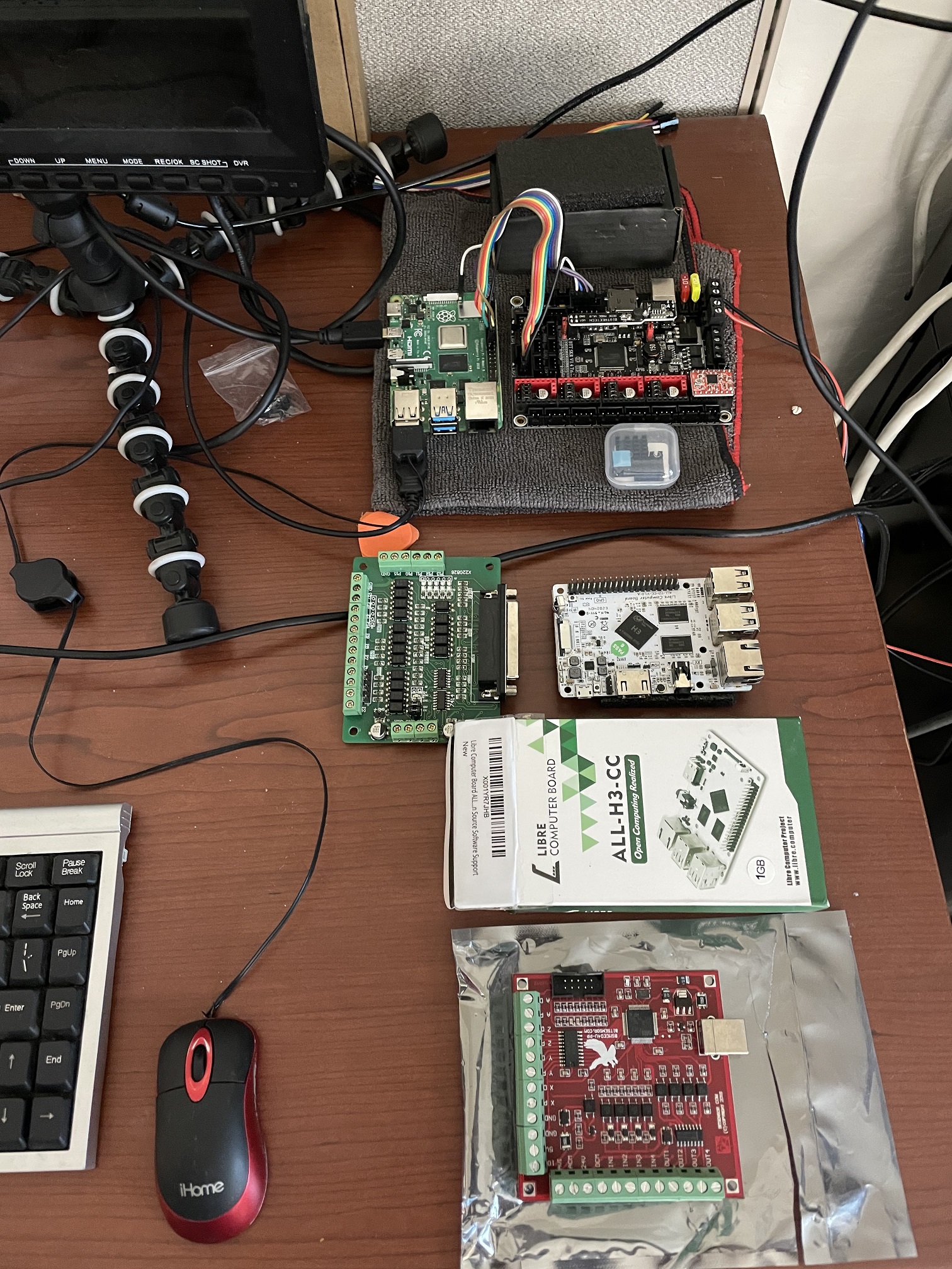

by Cncninja
Replied by Cncninja on topic LinuxCNC + Orange Pi (allwincnc)
What does Archived mean?? no more development, unfinished?? I'm making a big pile of unusable LinuxCNC controllers. RPI4 with Remora got it up and running and found out it's limited to 25khz...#$%@^. ESP32.. Lossing hair over, Bought an H3 board and now the unfinished project is Archived and says don't load current as it will brick the board.. What version should I load?

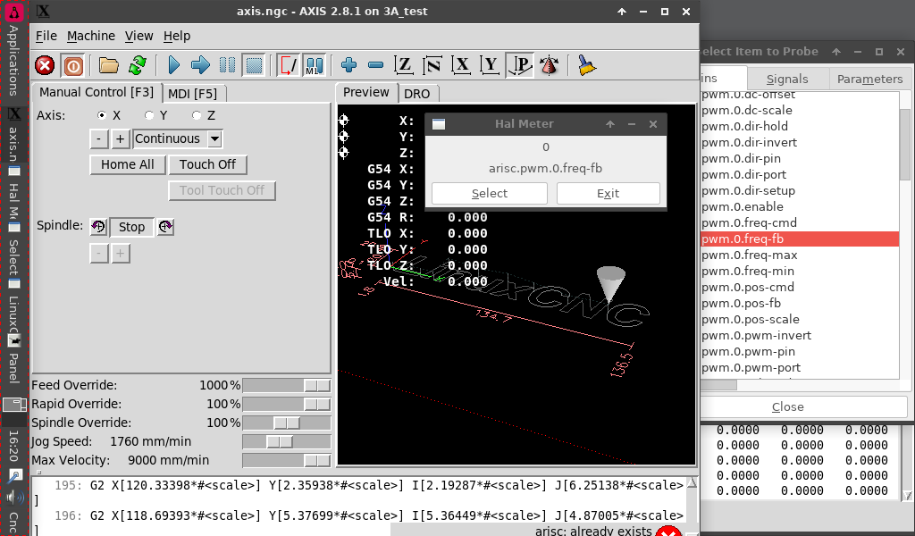

ok so it running and I can cut the Linuxcnc logo no problem, but if I load one of my g codes it just sits there ( linuxcnc post-process fusion360.) and is locked up have to close and re-open.
Could someone else try the code so i can see if it's the config or the gcode. the system runs the linuxcnc tool path fine but will not run anything I load.

Replied by envyvan on topic LinuxCNC + Orange Pi (allwincnc)
Hi Cncninja,
T1 M6 is a g-code command that tells the mill to use tool index 1 (see Note above), and M6 tells the virtual machine to go to its tool change position and execute the tool change.
If you don't set to use this funtion, should remove it from your Gcode.
