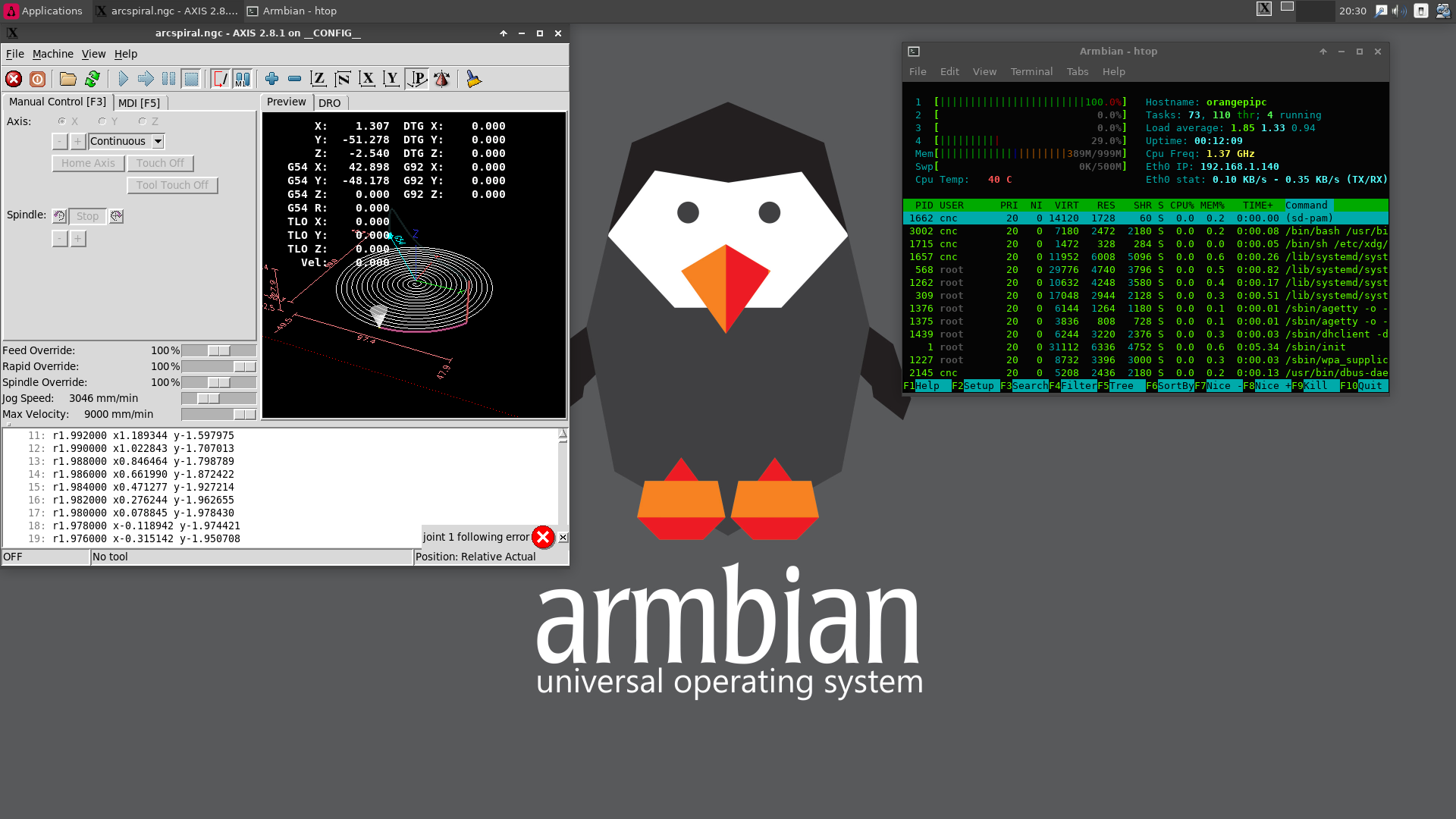

29 Jul 2021 20:49 - 29 Jul 2021 21:01 #216267
by Dolence
Replied by Dolence on topic LinuxCNC + Orange Pi (allwincnc)
Thank you very much for all the help. It is really very appreciated!
Ok, so today I run a few more tests...
Fixing the CPU min and max frequency to the same value and adding isolating CPUs editing /boot/armbianEnv.txt like this solved my latency issues.
I still getting the joint following errors. Even with out of the box configuration files (just adding the option to ignore homing) I still getting this error. So far I've tried to use higher values for FERROR and MIN_FERROR and adding STEPGEN_MAXVEL and STEPGEN_MAXACCEL values 20% higher than MAX_VELOCITY and MAX_ACCELERATION, but none of these helped.
It doesn't matter much at this moment since I'm getting the same error with provided example configuration, but my real hardware is as follow:
1.8 degree 200 steps per revolution Easy Servos on X, Y and Z
X and Y screw pitch are 25mm per revolution
X and Y microsteps = 32
Z screw pitch is 20mm
Z microsteps = 16
extraargs=isolcpus=1,2,3 idle=pollI still getting the joint following errors. Even with out of the box configuration files (just adding the option to ignore homing) I still getting this error. So far I've tried to use higher values for FERROR and MIN_FERROR and adding STEPGEN_MAXVEL and STEPGEN_MAXACCEL values 20% higher than MAX_VELOCITY and MAX_ACCELERATION, but none of these helped.
[TRAJ]
COORDINATES = XYZ
LINEAR_UNITS = mm
ANGULAR_UNITS = degree
DEFAULT_LINEAR_VELOCITY = 15.0
MAX_LINEAR_VELOCITY = 150.00
NO_FORCE_HOMING = 1
[EMCIO]
EMCIO = io
CYCLE_TIME = 0.100
TOOL_TABLE = tool.tbl
[AXIS_X]
MAX_VELOCITY = 150.0
MAX_ACCELERATION = 750.0
MIN_LIMIT = -9999.0
MAX_LIMIT = 9999.0
[JOINT_0]
TYPE = LINEAR
HOME = 0.0
MIN_LIMIT = -9999.0
MAX_LIMIT = 9999.0
STEPGEN_MAXVEL = 187.50
STEPGEN_MAXACCEL = 937.50
SCALE = 256.0
FERROR = 10.0
MIN_FERROR = 1.0
HOME_OFFSET = 0.0
[AXIS_Y]
MIN_LIMIT = -9999.0
MAX_LIMIT = 9999.0
[JOINT_1]
TYPE = LINEAR
HOME = 0.0
MIN_LIMIT = -9999.0
MAX_LIMIT = 9999.0
SCALE = 256.0
FERROR = 10.0
MIN_FERROR = 1.0
HOME_OFFSET = 0.0
[AXIS_Z]
MAX_VELOCITY = 100.0
MAX_ACCELERATION = 200.0
MIN_LIMIT = -9999.0
MAX_LIMIT = 9999.0
[JOINT_2]
TYPE = LINEAR
HOME = 0.0
MIN_LIMIT = -9999.0
MAX_LIMIT = 9999.0
STEPGEN_MAXVEL = 120.0
STEPGEN_MAXACCEL = 240.0
SCALE = 160.0
FERROR = 10.0
MIN_FERROR = 1.0
HOME_OFFSET = 0.0It doesn't matter much at this moment since I'm getting the same error with provided example configuration, but my real hardware is as follow:
Z microsteps = 16
Last edit: 29 Jul 2021 21:01 by Dolence.

30 Jul 2021 06:08 #216311
by envyvan
Replied by envyvan on topic LinuxCNC + Orange Pi (allwincnc)
SCALE = 256.0
I think this value is quite fast for a hobby cnc.
If I don't get it wrong, SCALE should be how many pulse for 1mm or inch, then you set up the VELOCITY to 150mm per second.
I not sure the H3 CPU would able to handle it.
And I also notice AXIS GUI seems like to show up quite much warning and error which tklinuxcnc GUI does not.
SCALE = 256.0

Hi Dolenece,
i reply inline....
>>> so no more Unexpected RealTime Delays?
>>> did you fix ( nail down ) the cpu speed?
>>>You can use Armbian-config to set the min and max to the same value
>>>and choose the governor as performance
>>> the arisc_pwm_stepgen is not the same animal as linuxcnc stepgen
>>> the arisc criiter doesnt have the same params, so dont add flippers onto a cat.
>>> dont add stepgen_max_accel etc to arisc stepgen
>>> some ferrors could be due to a varying cpu speed, see above
>>> did you follow the urls send by Bari concerning following errors?
i reply inline....
Z microsteps = 16
>>>summary
>>> read the ferror docs
>>> please fix (nail down) the cpu freq
>>> please adapt a supplied config.ini, dont add items that did not exist in original
>>> try 1 thing at a time, and post your results
hth
tomp
ps: somebody explain to me how to include the orig text in this goofy editor ( forum editor )
i swear there used to be a button
Last edit: 30 Jul 2021 06:24 by tjtr33. Reason: stupid editor, stupid editer
