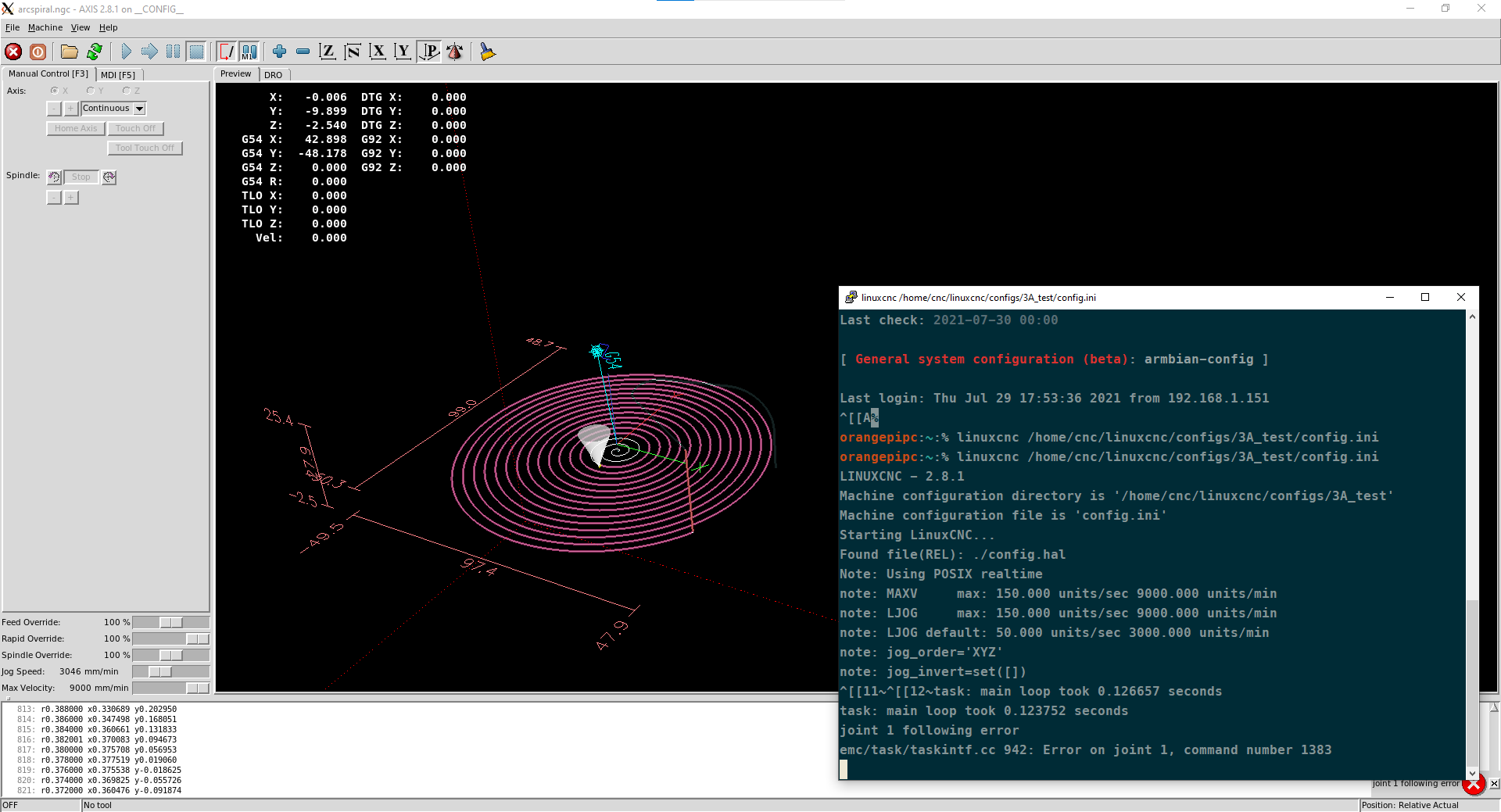

30 Jul 2021 22:16 - 30 Jul 2021 22:17 #216405
by Dolence
It's weird, but I just noticed that if I launch linuxcnc over ssh using Xserver forwarding (Xming putty on Windows) the code run almost entirely without errors. Usually it pops after a few seconds of moviment, but this time it almost run entirely. I didn't stop the lightdm service on the Pi board, just launched the AXIS UI over SSH on my local network.
Replied by Dolence on topic LinuxCNC + Orange Pi (allwincnc)

31 Jul 2021 02:10 #216417
by envyvan
Replied by envyvan on topic LinuxCNC + Orange Pi (allwincnc)
Hi Dolence,
Thanks for you explain, I have slow system that on the opposite side from you.
I also have the same error with stock configuration (3A_TEST example) same as you.
But I run the 3T_Test configuration with no error. So I guest CPU of the pi was not handle the AXLE GUI well.

31 Jul 2021 05:14 #216424
by Bari
Replied by Bari on topic LinuxCNC + Orange Pi (allwincnc)
Is it using software or hardware rendering? More little things to add up to does it work well or not. It just needs a good going over and some cleanup.

31 Jul 2021 10:06 #216439
by envyvan
Hi Tjtr33,
They already talk about the GPU hardware accel drivers issue in page 14.
Try to close the tool path drawing and swith to just show the DRO reading.
I can run that with the store 3A_CONFIG with no Follow issue.
But if I try to open a firefox. the Follow issue comes out.
I think is the cpu have the hard time for handle the feedback from "arisc.pwm.0.pos-fb" to "joint.0.motor-pos-fb" when it doing heavy duty work, Then it cause the Follow XX issue.
