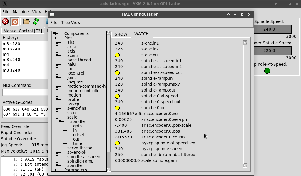

Can you look at the encoder velocity?
I have a configuration for a lathe, but i need to scale RPS to 60 000 000 to have a "correct" spindle-at-speed. and the RPM change range only 25 RPM on the encoder. If I command 240 RPM the encoder velocity is showing 225, or 250 (if speed up, the next will be 275, 300, 325 and so on)
In % to reach the spindle at speed I need to change the value from 1.01 (to be in 1% of error) to 1.5 (50% error) in the .hal to get green light. On slower speed is worst... (I will use a servo drive encoder output - 13 bit = 8192 in LCNC scale)
Is it possible to correct it some how?

I've added new output to HAL (period_ticks) for testing the ARISC code. It is pin A period in raw timer ticks. Then the hal driver calculates velocity from period output, until about 110kHz when it switches back to frequency. Of course this is rather poor, and we should use method described by PCW. Anyway this code seems to work orangePi H3 (the only board I have).
