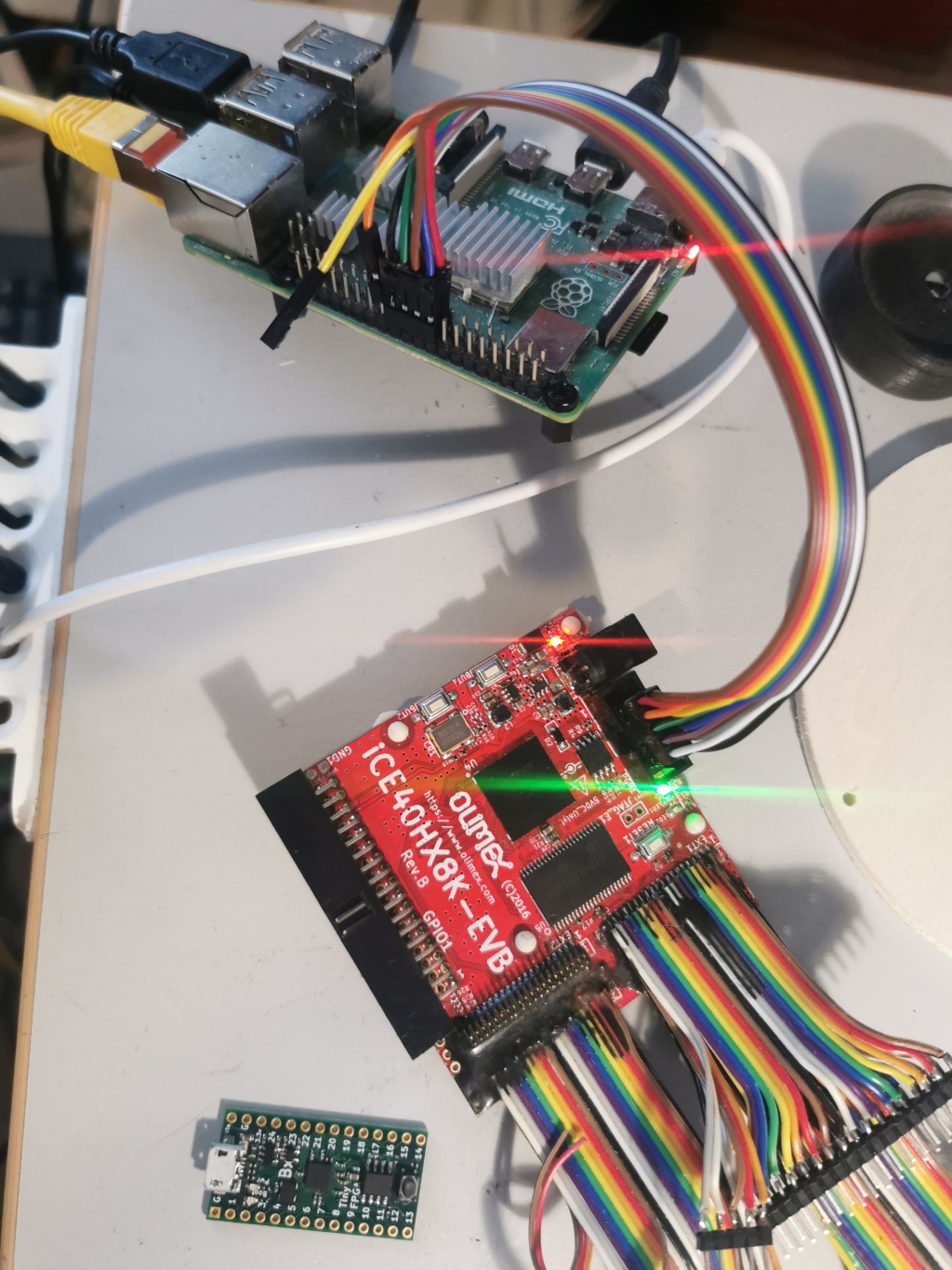

I like the Remora-Project.
At the moment, i try to port the SPI-Version to an ICE40-FPGA with Opensource-Toolchain.
Only Just for Fun and to refresh my FPGA-Skill's.
EDIT: can not get it to run

- meister
- Posts: 806
- Thank you received: 502
30 Apr 2023 20:02 - 30 Apr 2023 20:03 #270333
by meister
Replied by meister on topic Remora - Rpi Software Stepping Using External Microcontroller via SPI
My ICE40 "Port" works
Not good, getting join errors if i move too fast, but i can move my stepper <3
Last edit: 30 Apr 2023 20:03 by meister.

- meister
- Posts: 806
01 May 2023 07:16 #270383
by meister
Board: www.olimex.com/Products/FPGA/iCE40/iCE40...open-source-hardware
Toolchain: clifford.at/icestorm
Lang: Verilog
Lang: Verilog

04 May 2023 21:11 #270673
by meister
PWM and closed loop now also works on my ICE40,
but i'm afraid i'm running out of logic cells,
I also don't use an IP-Core like Mesa but pure logic in Verilog.
- cakeslob
- Posts: 927
- Thank you received: 280
04 May 2023 23:04 #270686
by cakeslob
Replied by cakeslob on topic Remora - Rpi Software Stepping Using External Microcontroller via SPI
lookin good. I am wondering the advantage of using remora over hostmot2. I can assume it smaller in size? hm2 would already be a little too big for the ice40 right?
- meister
- Posts: 806
05 May 2023 07:27 #270705
by meister
the ice40 i had lying around at home and i felt like playing with it
otherwise there is no reason for it, neither cheaper nor better.
ok, i can do everything in logic without an IP core but is that an advantage ?
