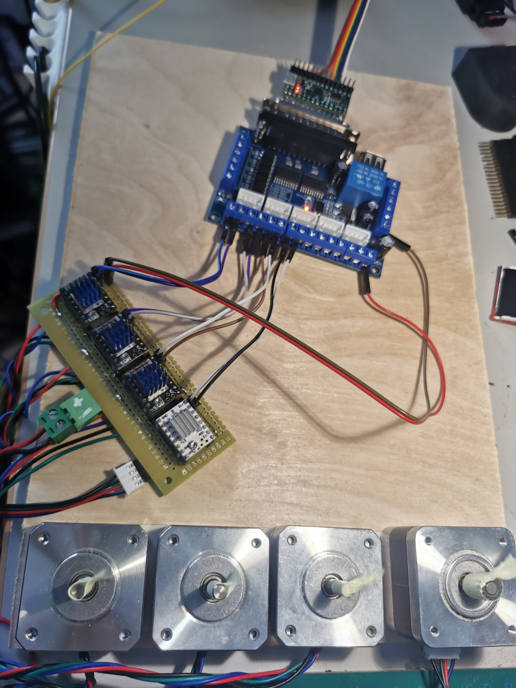

If someone want to play with github.com/multigcs/Remora-FPGA Working on Olimex ICE40HX8K-EVB and TinyFPGA-BX5Mhz Step-Clock is no problem for the hardware

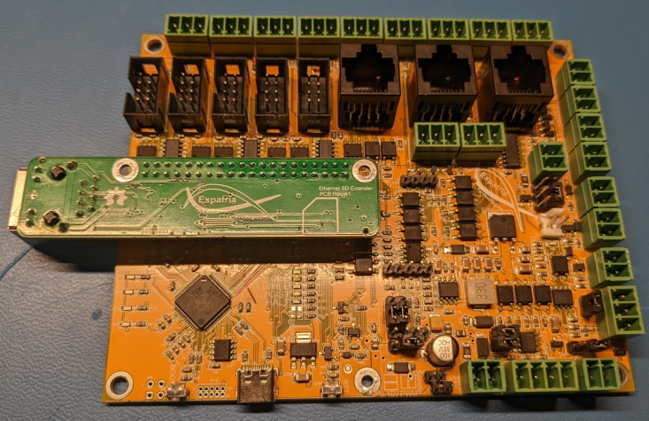

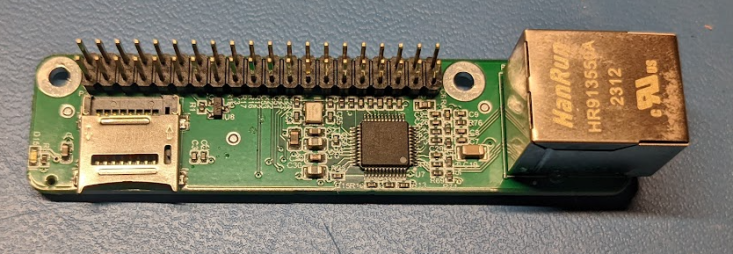

It's a bit easier to just use something like a W5500 chip directly via SPI (Scott already has code working for this).
With FlexiHAL we have a small add-on module in the works so that people aren't reliant on a Pi even though they are getting easier to find - we have not yet found another SBC that has adequate GPU driver support for Probe Basic.
Currently working on DMA transfers (even just using IRQ is a reasonable improvement), again just following on from the work that Scotta has already done.
