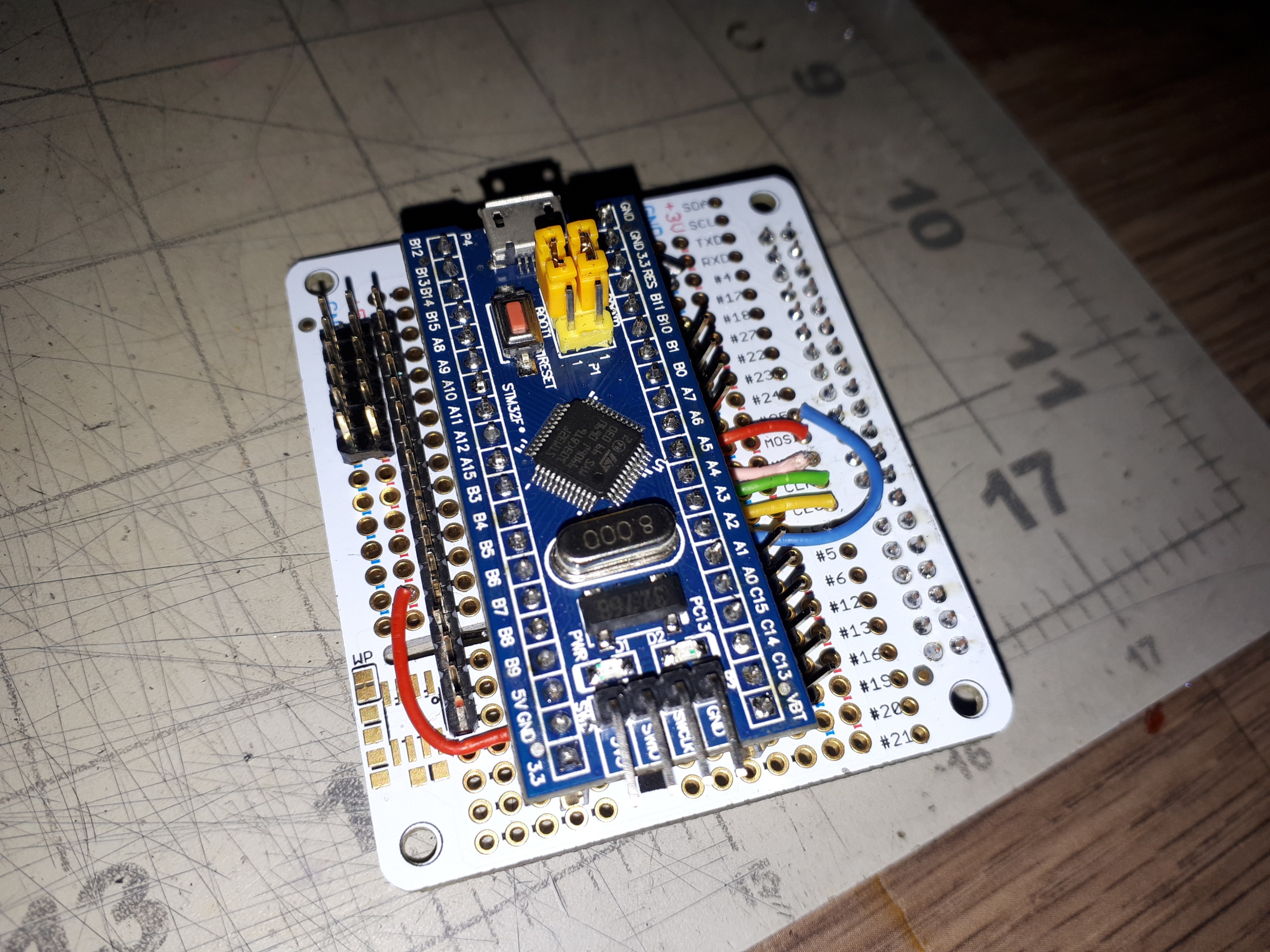

I got the firmware to run on stm bluepill. It only works with the clones that have 128kb memory, so you need to check that beforehand. I dont know if I can get to small enough to add sd card, but it works with the static config. I think I wrote over the usb bootloader though, so i will have to look into it. spi pin out is PA7/6/5/4/3
github.com/cakeslob/Remora/tree/nucleo_static
Replied by cakeslob on topic Remora - Rpi Software Stepping Using External Microcontroller via SPI
Ok the good news is I can get the firmware down to 116kb, so thats cool

I think Old Mate is referring to the potoo board the MCU board is on.what is a bluepill remora shield

I just fit the tiny cheap dev board on to an RPI shield thing so its a small setup. I thought it was neat.what is a bluepill remora shield
